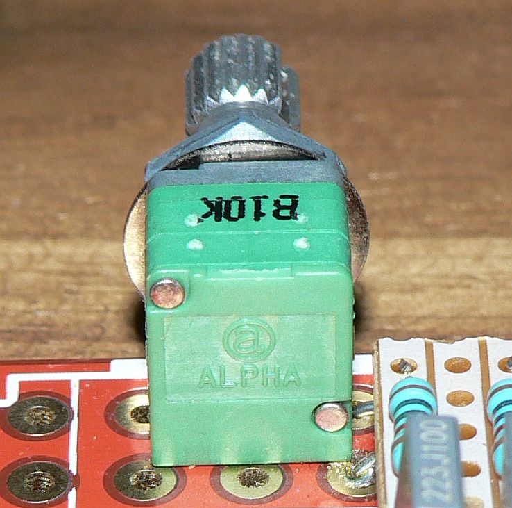

There is a Vishay P11 volume pot in my McCormack TLC-1 deluxe preamp. It does what thirdicomplex said (only one channel plays when near full attenuation), but otherwise has seemed excellent to me. I was very surprised when I first saw it there, as it was so small and was sitting in a full sized chassis (some versions of this preamp have a P&G pot there).
Yes! Thank you, that Bourns type looks OK. The Alpha in the first link looks exactly like the ones that scratch after a while (but they all look the same and are often also green). If you recommend them I take you used them as replacement for the scratchy Chi-Fi versions?! Will try them when I can find them here.
The Alpha is different to the ones supplied with Chinese kits and Joe Rasmussen used them.
https://www.diyaudio.com/community/...uctance-current-amplifier.239321/post-6016477
I replaced all the pots supplied in Chi-Fi line level unassembled kits such as tone controls and sub controllers.

Jean-Paul, are you sure the scratchiness you describe isn't caused by the fact that most of these cheap amps use a 'law fake' linear pot arrangment? The extra current through the wiper is known to cause scratiness. My BRZ MA12070 amp had that problem until I swapped in a log pot and deleted the shunt resistors.
Oh that can be but what current exactly? It is found in various devices that identify themselves as "unrealistic priceworthy audio devices produced in a beautiful country far away in the East".
It doesn't change the need for a quality real logarithmic potentiometer in the same physical format. Which one did you use?
Isn't that the ultralow current hat normally goes through the potentiometer but now partly through the wiper? Wimpy stuff if so.
