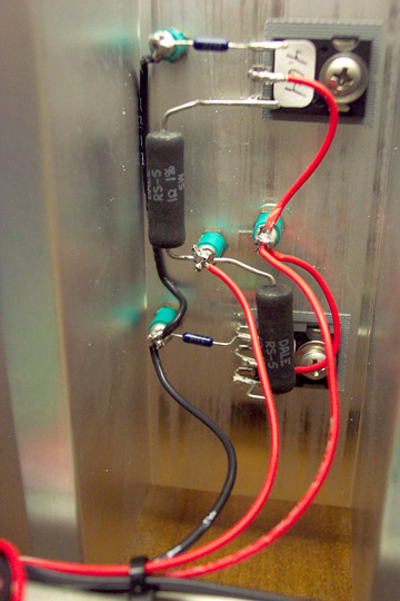

"It's much easier to get a good contact between the TO-3 and the heatsink than with the plastic cases as you have 2 screws rather than 1. Giving a more even pressure across the transistor."
__________________________________________________
Not if U use a slightly large washer under the screw( as shown in the photo). This is as Nelson Pass suggests it be done and it works beautifully! Also, one could utilize a clamping bar or machined clamp to guarantee cood contact.
I am certainyl NOT argueing against using TO-3's if available. They are however becomming quite scarce for many popular devices that are commonly used.
Mark
Mark
