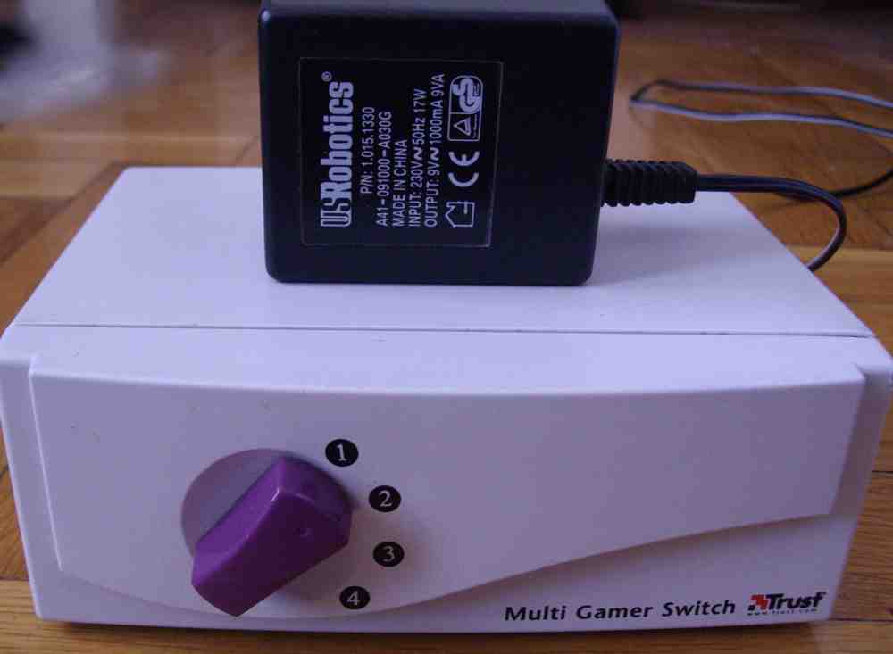

Just found :radar: a nice little enclosure and a smaller transformer with same output (9VAC-1000mA).

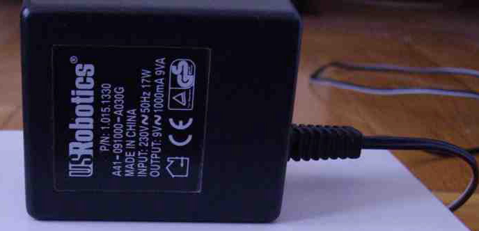

So I decided to use this external SMPS with 9VAC output. Bridge rectifiers, filter cap and regulator will be inside the amp enclosure. I know safety ground connection is made by third /green wire but in this case transformer isn't in the chassis: what about power socket ground? Do I have to connect it to star ground or to the chassis?

if the SMPS is to the double insulated standard with the two concentric squares symbol, then the output does not need and must not have a Safety Earth connection. I cannot see a square symbol in that pic.
What does the triangular symbol indicate?
The ancillary equipment may also be double insulated and again they do not need a Safety Earth connection.
You can connect all these double insulated pieces of equipment together safely without any Saftey Earth connection.
If one/any item is not to the double insulated standard then it/they must be connected to Safety Earth. Even when this piece if equipment is protected from prying fingers it must still be connected to Safety Earth whenever it sends an interconnect to another item that has any exposed conductive parts.
Searched on the web and triangular symbol is a Product Safety Test Mark:
"The German safety approval mark shows conformity with the German Equipment Safety Law. It is a recognized mark for electrical products, such as office equipment, household appliances and industrial equipment, and is widely accepted throughout Europe. The TUV Rheinland GS Mark signals to the buyer, customer and consumer that the product, as well as the user manual and production process, has been tested by an authorized institution such as TUV Rheinland and is supported by regular surveillance audits."
(from www.watt-power.co.uk/safety.htm)
No square symbols anyway.
