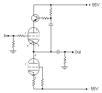

OK, then here are my two cents worth. Two circuits UG/Buffer. They are very simple and have already been built in large numbers.
1st the tube/hybrid version:
This is only the starting point. Somebody with an eagle eye will recognise this from the Gainclone/Chip Amps forum. Lots of these were built as Buffer for Inverted Gainclones. Split supply is the key to its simplicity.
But a more complete version was designed for the JLTi Integrated amp. This added the extra key missing elements:
Only a little bit more complex. I have used this as a Unity Gain Preamp stage (CD Players with full 2VRMS don't need much gain, right?) and it has typically embarrassed a number of commercial 10K-buck Line Stages. I can testify that it sounds very good indeed!!!
Note the missing components values, but it is not hard to figure out what does what. So Pedja Rogic took the circuit typology and converted it to an all-FET version seen and described here:
http://www.pedjarogic.com/gc/index.html

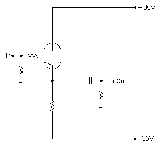

I am sure he won't mind me posting it here (he borrows from me, so tit-for-tat):
What's going on here? I can't type T I T as in tit-for-tat? Auto censored? Must be American prudeness!
I wonder how many words are censored - the three letters used in the phrase I typed has nothing to do with female upper body attachments!!!
OK, back to subject.
Even the tube version does not need HT, based on 6922, no need to get terrified working with high voltages. Good way to get into tubes in a safe way.

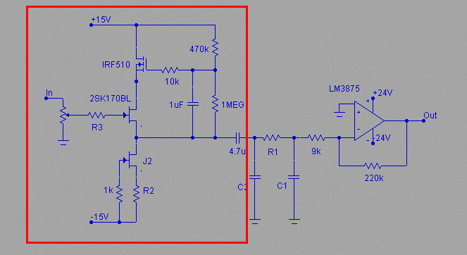

There's a terrible temptation to use a much smaller cap at the input and a cute servo circuit to steer the output to zero volts (DC), but designing good servo circuits (that are reliable and never fail) is an art unto itself. Better to spend the moola on an exotic cap instead.
Hi Lynn
We have done exactly just that, a variation of that even before Pedja did his all-FET version, and that is what a whole lot of owners of Vacuum State converted Sony SACD players have been listening to since 2002, and no output cap. Must be getting close to a thousand players, at least 500 plus!
Reliable? Ultra-reliable!!!
But ours mixed Fets and Bi-polar. Darlington pair Bi-Polar as the emitter follower is better sounding that Pedja's Fet. But there will now be some DC on the input anyway, so servo is a natural.
The key to good sounding servos is to make them S.....L....O.....W.... and then tell the user to be patient and don't have the power amps ON. Give it five minutes.
Joe R.

How low can we run R5 current and still get correct loading?
If the lower connection of R5 were returned to a lower voltage, maybe -3.6V using a pair of LEDs, would the circuit still work or work badly?
Am I right in thinking that the voltage across R5 sets the output bias voltage?
6mA across 600r =3.6Vdc.
Will trimming the CCS currents, force Q1 collector to a lower voltage by reducing the current flow through R5?
R5 is the load. Maybe I should have labelled it that way. And yes, the output bias is dependant on this load, lower load resistance means lower bias voltage simply via loading.
Regards
Charles
Regards
Charles
Urk. I didn't realize DC is passing through the load. Not just any old DC, but DC that sets the bias current. This rules out the circuit for the input transformers on my power amps - transformers intended for studio line-level use will not tolerate any DC at all on the primary.
It won't hurt the transformers - no real problem there - but midrange and bass distortion will go up hundreds of times. If DC is kept out of the transformer, distortion is low enough that they qualify for the input of the Audio Precision test system - or making the classic recordings of the Fifties and Sixties.
