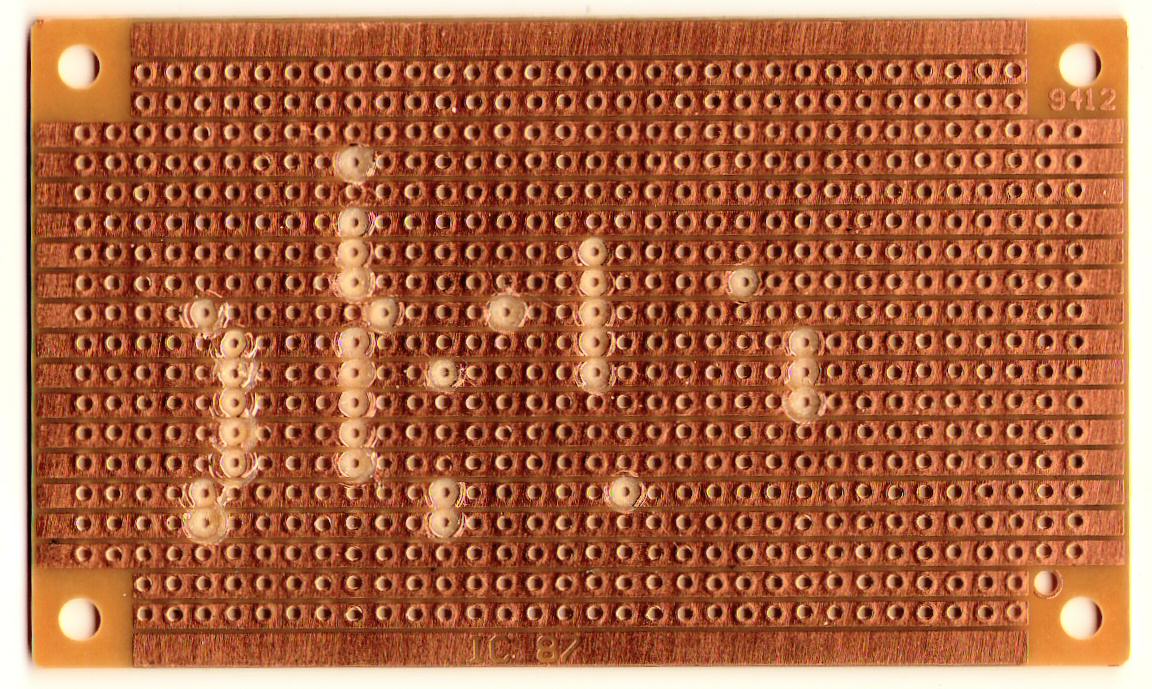

In my experience, what works best in practice is to create an LC resonant circuit between the transformer leakage inductance "L", and a known capacitor "C" whose value is intelligently chosen. Measure the resonant frequency "f_resonant" and then use f_resonant and C to calculate L. Done.

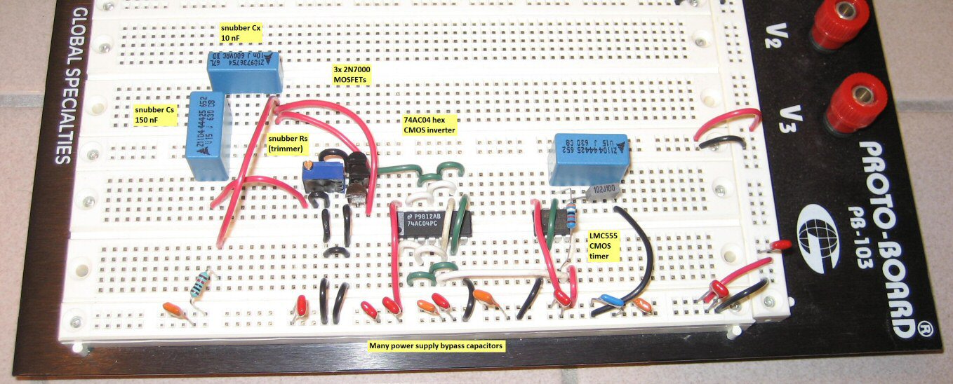

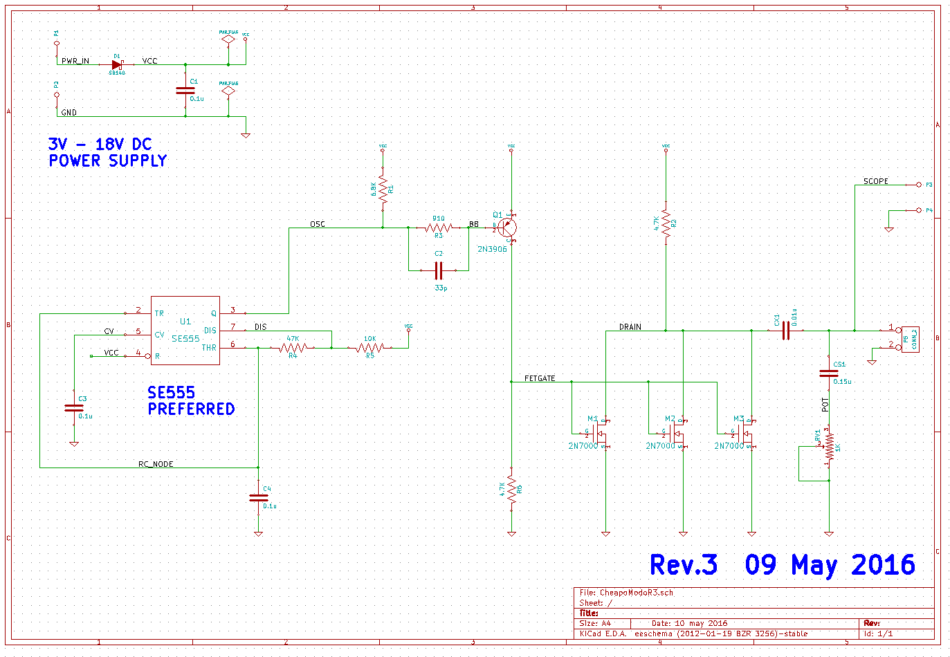

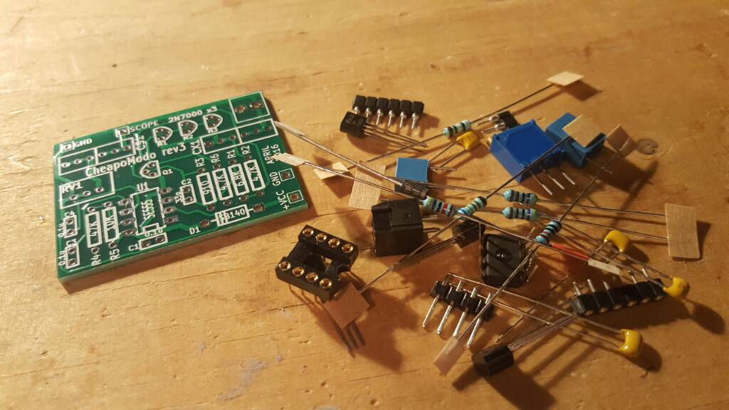

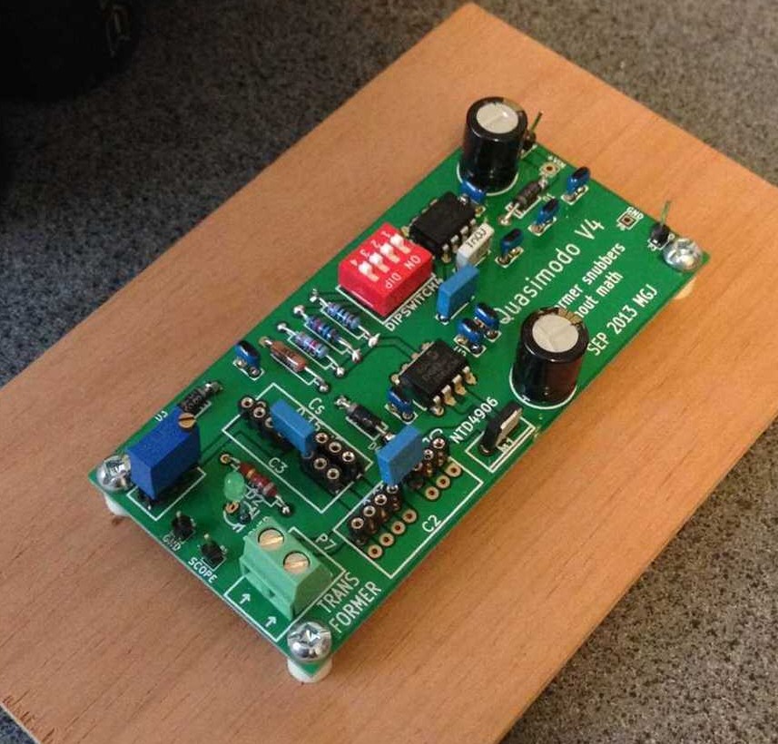

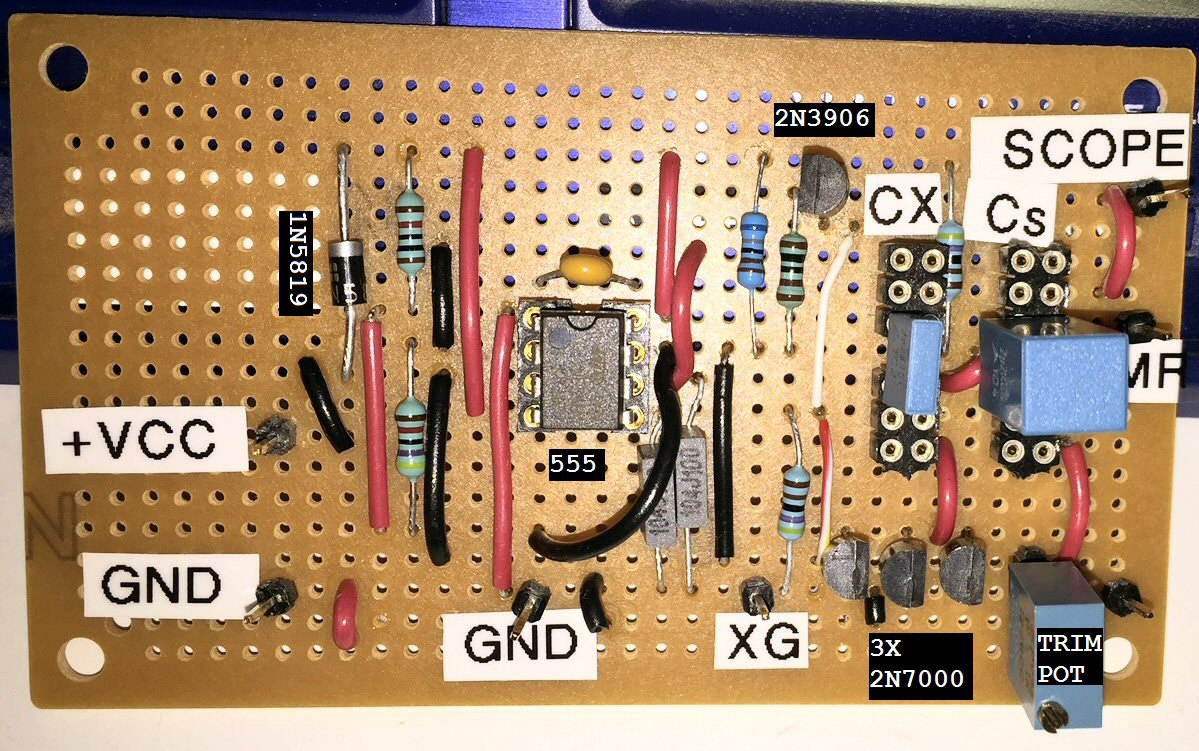

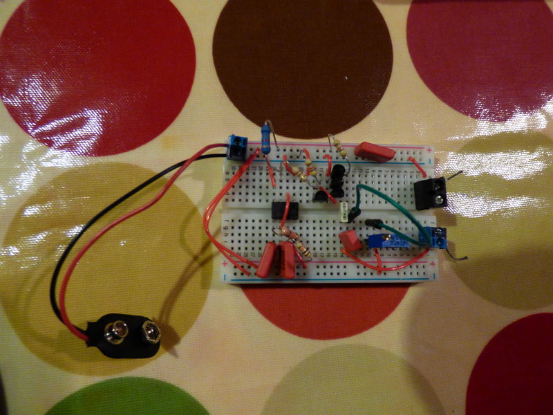

You can do this lots of different ways but the most common here on diyAudio is to put together a little bellringer test jig, either on your solderless breadboard, or on a piece of Veroboard ("Stripboard" in the US), or on a printed circuit board. Images below. Some people prefer a bellringer test jig because using it requires no calculations at all. For those who dislike exponents and scientific notation (example: 0.1 microfarad = 1.0E-7 farads), this is a delight.
Although a bellringer test jig is handy, you can get the same result with just a signal generator and your 'scope. Some people prefer this because they already own an oscilloscope and a signal generator; why build (and keep, and remember where you put away??) a test jig when you can accomplish the same objective without it? Here is a link to a post #561 that shows how. It's for self starters and independent-minded people only.
Bellringer test jigs go by the name "Quasimodo" (full featured PCB) and/or "Cheapomodo" (bare bones, inexpensive PCB) here on diyAudio. I am selling off my remaining inventory of Cheapomodo kits in the Vendors Bazaar, if for some reason you don't feel like sourcing the parts yourself. I also wrote up a detailed set of instructions on how to use bellringers; it is a .pdf attachment to post #1 of the Quasimodo thread, here.

I have found that once you get in the right neighborhood for R with QUASIMODO there is a range where the waveform changes so little over a surprising variety of R values that one can get really picky if you want but, in my LIMITED experience, all you have to do is get close to get rid of the ringing.
Not as if you will need 0.1% resistors!
My first tested transformer (for the mono J2 project) you can go between 20R and 38R with the slightest difference for the first peak.
I get the feeling there is no reason to obsess over the EXACT value of R but every reason to incorporate the snubber.
I am thinking it is better to go high than low on the value of R. I would worry one can go too low and likely lose some life in the sound of your amplifier. But you cannot beat QUASIMODO for telling you where the neighborhood is. You can pick the house you want once you get there.
