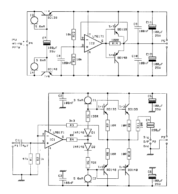

For my WNA MKII headphone amp I search for a better railsplitter (virtual ground)
The current railsplitter looks like this (IC2: LM6171, TR7: BD139, TR8: BD140)

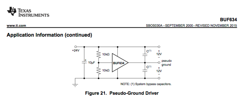

Now I found a hint in BUF634 datasheet. My question, how much could be the value of the both cups C (1) on the output?
In the current amp C (1) are 220µF + 100µF bypassed with 2x 100nF.
Offers the BUF634 really a better way, or should be a combination of an OPA + BUF634 better?
I read this hints too, but they needs an additional PCB.

The complete WNA MKII schema and buildings
blue-danube DIY audio - WNA MKII Modifications

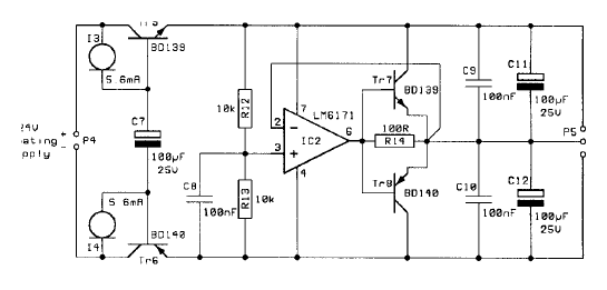

The LM6171 circuit has a cap on the input and output.
Why not put the bottom (normal to GND) of R1 to 1/2 +Vcc and put a large cap on the bottom (normal to GND) of R2?
This will result in a divider that does not need to handle the full output power.

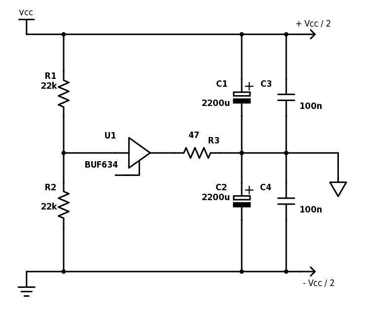

I use something like this.
Essentially, the BUF634 is used only to provide DC reference, because AC signals bypasses it via C1||C2||C3||C4.
With a setup like that, unless you have large DC currents to sink to VG, you can get away even with lower current spec-ed buffers and op-amps.
R3 needs to be sizes according to the DC current your circuit is sinking to VG (and the amount of DC offset you want to tolerate), and together with C1||C2||C3||C4 to tune the low pass filter.

The one I posted is an just example of what I used in one of my last projects.
That one, has a cutoff frequency of 0.76Hz.
IOW, as an example, to move a bit closer to audio frequency, a 20Hz AC signal to VG will find a 47 Ohms path to the BUF64, and a ~1.8 Ohms path via the capacitors.
It all depends on what are the constraints of your circuitry.
How much +- rail unbalance can your circuit tolerate?
How much DC current is sinking to VG?
How much idle current can you afford?
Rail unbalance is given by the VG circuitry DC output impedance (~47) in the posted schematic multiplied by the the DC current to VG.
For the trivial resistor divider, DC output impedance is R/2 (where R is the value of the split resistors).
It is possible that even the simple resistor divider is enough, w/out any need of active components, if, given your circuit DC current to VG, you can reduce R to fit your rail unbalance budget.
Note also that, with both circuits, if the idle DC current to VG is relatively constant, you can always achieve perfect balance by adding a precision trimmer to the resistor divider.
