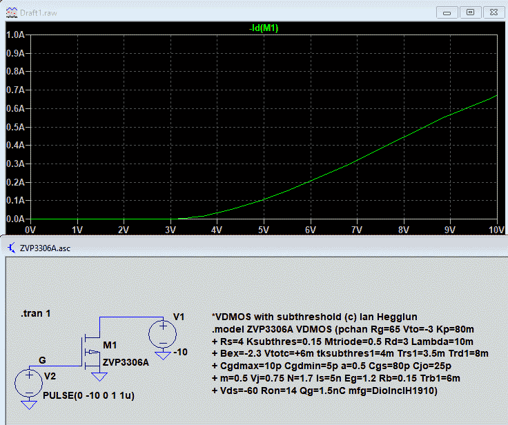

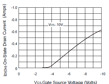

Hi RCruz,
*VDMOS with subthreshold (c) Ian Hegglun
.model ZVP3306A VDMOS (pchan Rg=65 Vto=-3 Kp=80m
+ Rs=4 Ksubthres=0.15 Mtriode=0.5 Rd=3 Lambda=10m
+ Bex=-2.3 Vtotc=+6m tksubthres1=4m Trs1=3.5m Trd1=8m
+ Cgdmax=10p Cgdmin=5p a=0.5 Cgs=80p Cjo=25p
+ m=0.5 Vj=0.75 N=1.7 Is=5n Eg=1.2 Rb=0.15 Trb1=6m
+ Vds=-60 Ron=14 Qg=1.5nC mfg=DioIncIH1910)
Plot attached.

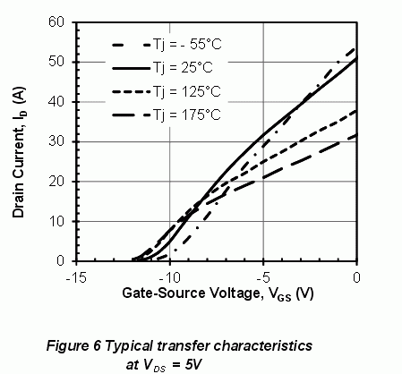

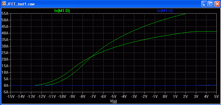

HI 🙂
... the temperature variation has no effect
thanks
Hi UltimateX86,
The temp-cos were not set for Vtotc and BetaTc. Added now. See attached. Temp is stepped 25 and 125. Also gfs and Vto have been trimmed closer to the datasheet.
