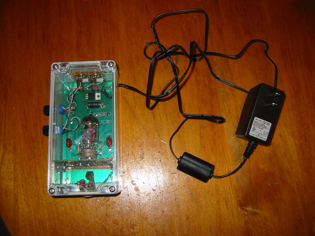

I built one of these for a friend. Its one input and two out's with each side out buffered by 1/2 of an 12AX7, and some level controls to set the balance. It goes between the gitar and two amp's. The input and output impeadance is on the order of 1M so it is reasonablly transparent, but we both believe it beats the heck out of just patching from one amp to the other. I call it the" F-tube". The idea is to set up one amp for a sound that it is good at , and the other for it's sound. This help's address the problem of the "one trick pony" that plagues so many amp's. This is not a stomp box, but one could of course put the effects device after this:scratch:
