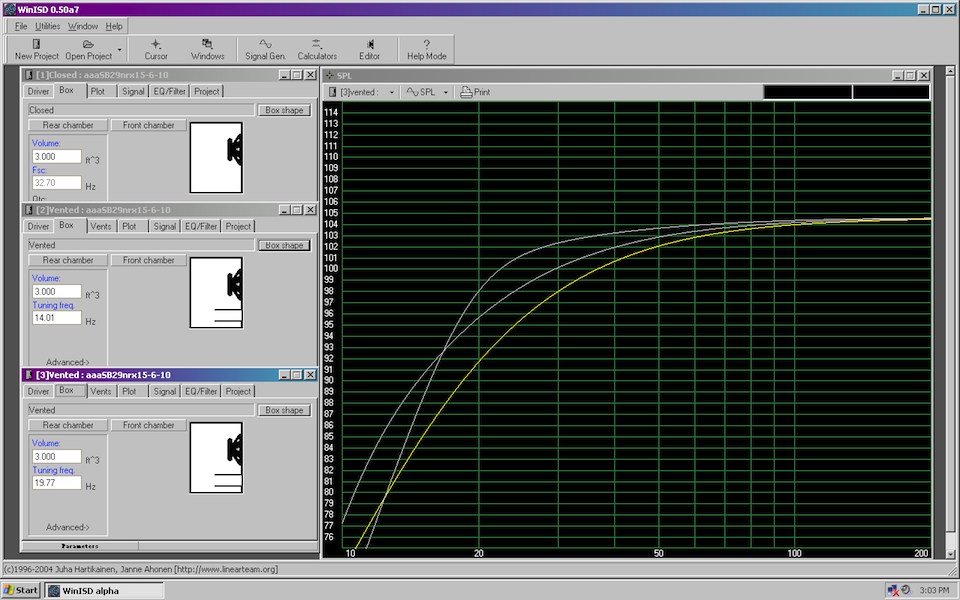

Vented boxes will end up rolling off at 24dB/octave. 6th order 36dB/octave.
The trick is to forget maximally flat alignments and overdamp the alignment
such that the roll-off starts off near first going towards second order for
most of the bass range of interest, accelerating to higher orders basically
below the real area of reproduction interest, combined with room gain works.

I should point out that if I build a BR box they are semi-LLT tuned ~14hz and High-pass at 18Hz. I suspect you're thinking about tunings well above that. (which i don't like for many reasons)
You may be right, I was just thinking that with this extra low tuning you would still need a bit of help with the EQ as it rolls off, not quite able to keep up with the room gain without it. In my own situation the far bigger problem is the havoc created by the room modes...![]()
With an undersized low tuned sub some EQ could be used as bob suggests.
If you can't treat the room properly (low WAF 🙄) have you tried notch filters, I use them all the time and the brain dosen't notice the missing frequencies as much as it notices the drone of standing waves.

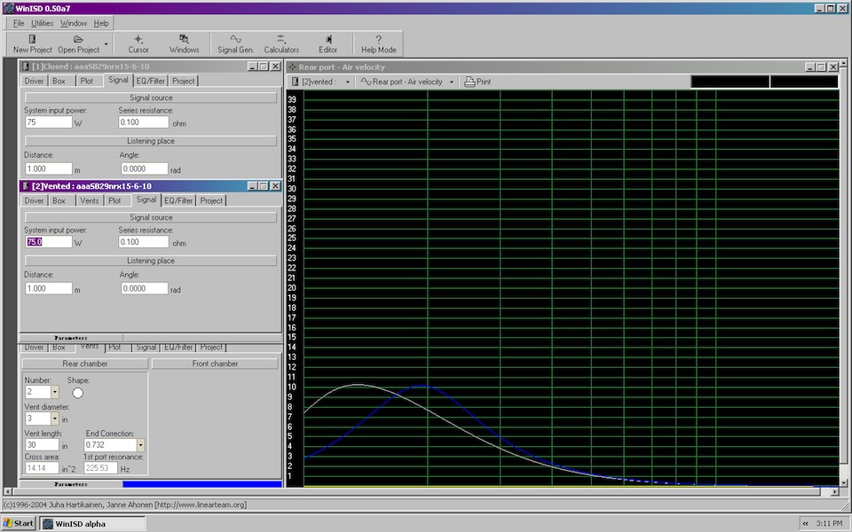

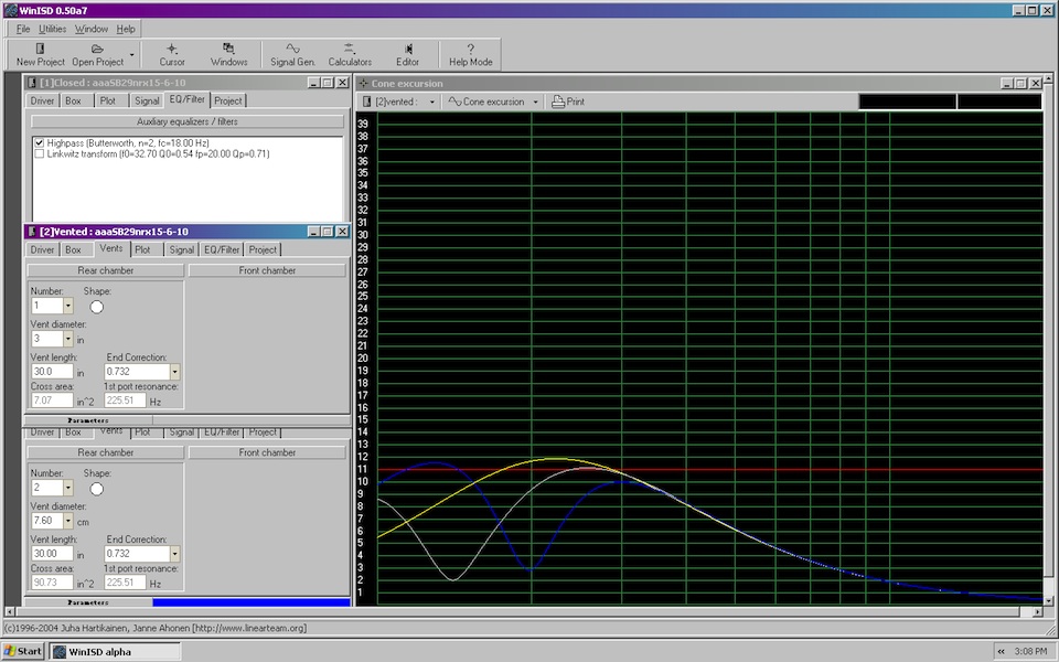

I want to know if the use of a HP-Lowcut filter is relevant when implementing a LT. The scenario I am talking about is a 12" woofer with 300 Wrms and Xmax of ~7mm in a to small enclosure of 45 liters (1.6 cft). The woofer is crossed to a compression driver around 1-1.2 kHz and will play the mids. This is to be taken into considerartion here. Another option here could be a vented EQ-assisted enclosure following Don Keele.
I regularly listen to deep bass music (dub, D'n'B, all sorts of Electronica) which have very low frequencies in the source material. Now I do not mind if the speakers cannot reproduce (all of) them, but I do mind if 1) they get destroyed because the woofer is pushed to hard, 2) the higher cone excursion introduces considerable distortion and diminishes mid frequency reproduction.
So: How much does cone excursion matter? I found that if I installed a 2nd order BW high pass filter at 20 Hz I can limit cone excursion quite well. But group delay is shooting up and is getting even higher than in a vented enclosure from ~25 Hz downwards. I suppose this means the base will loose definition? If I do not use a lowcut, the woofer reaches 4mm cone excursion at 20 Hz and a peak of 5 mm subsonic. Allthough I wonder if this is fixed to any SPL or what SPL WinISD uses here. Thechnically the woofer permits such cone excursion, my question is: What does it mean soundwise?

Well, we're always trading efficiency for BW and since excursion increases 4x/octave for a given piston area [Sd] with sealed, one runs out of Xmax real quick down low, so seems prudent to use one.
Vented reduces it over ~1/2 octave IIRC, but really need to sim in Hornresp
or similar to see what your power handling limits are.

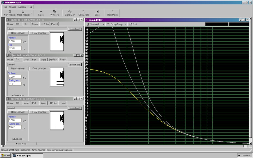

GD is affected by the shape of the transfer function. Smooth transitions have lowest GD, and sharp deviations make it shoot up. If you consider that where you previously had a rolling-off curve, it is now flat, you will see that equalisation has in fact improved GD. Then you have to make a judgement in terms of the knee of your final HP curve. The sharper that knee, the more pronounced will be the GD. To every pro there is a con. It comes down to, as you have rightly alluded to: how much is too much? My advice: compare a few alignments and then take your pick.
