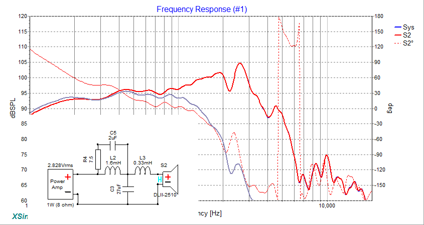

Eminence Deltalite 2510 has huge peak between 1.5 and 3 kHz. Much better and smoother are Delta Pro-12A and 18Sound 10W500.
That's true enough, though I have to point out that the 2510 has already passed the "workability" test ( so-to-speak ) with a handful of network designers.
The DIYSG HTM-10 being one such notable example of a very successful design that uses this woofer .
A simple parallel notch filter that incorporates the lowpass's first inductor, helps attenuate that offending spike ( as does the steeper slope of a 3-pole filter ).
- The extra 2 components for the notch are cheap enough.

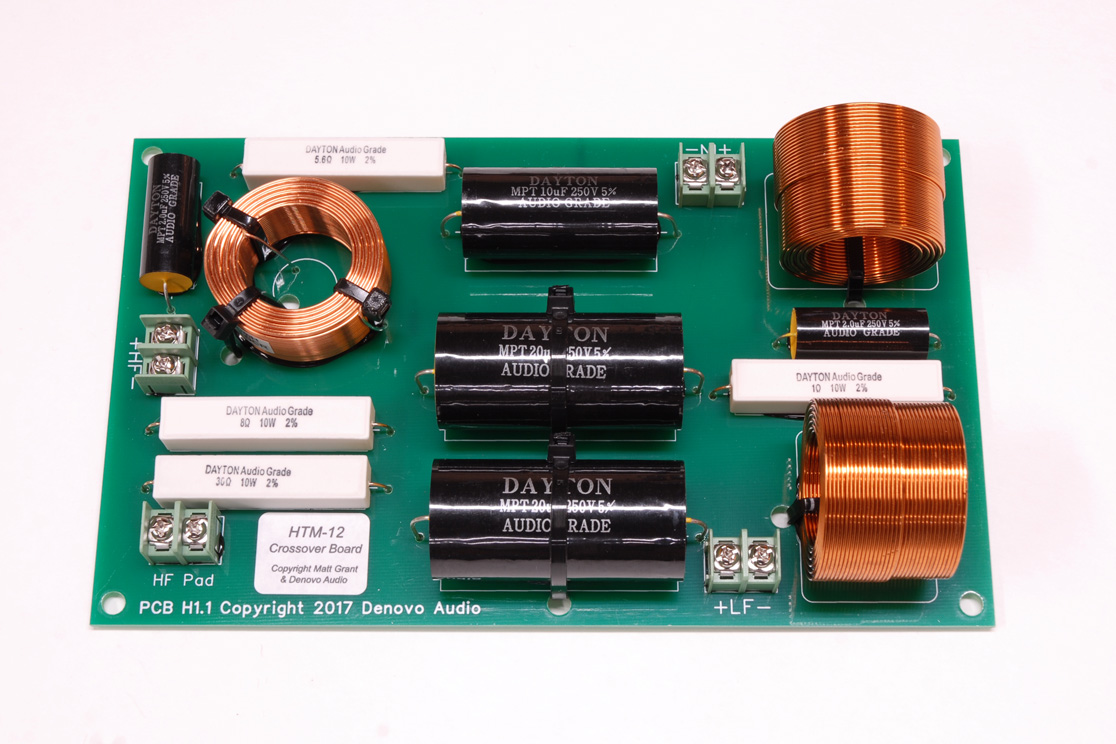

I figure that there's a similar approach taken, here in the displayed HTM-12 network ( which uses the Eminence 2512 ).

Denovo Audio HTM-10
I would email Erich from their web page and explain to him you want just the horn, compression driver and crossover parts--delete the bezel and Deltalite 10" from the kit for credit. That would get the shipping and size of the box really small and you can purchase a pair of the Deltalite drivers locally. The compression drivers are made by B&C and the crossover parts are high quality polypropylene with air core inductors.
Just an option, I'm sure for the pair, a set of horns with compression drivers and crossover parts should not exceed 10 kg in shipping charges.
Yes, Deltalite 2510 is workable and is used in a successful design, but Delta Pro-12A has much higher sensitivity and smoother response. Low-pass filter for Delta Pro-12A will be simpler and cheaper, also.
Well, I won't argue against smoother, higher sensitivity, cheaper & easier to design for.
