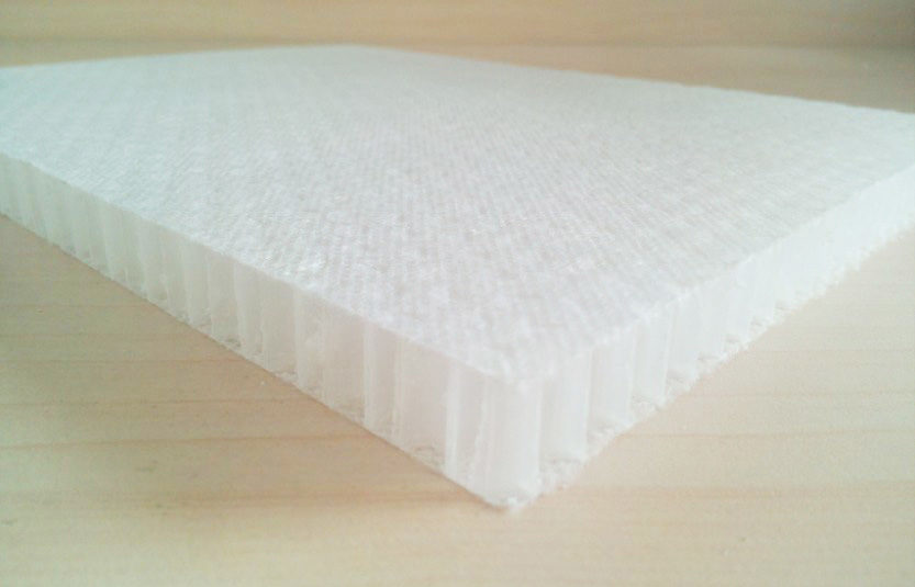

I think another decent option is sandwich construction that uses an aluminium honeycomb or plastic lattice as the 'filling' of the sandwich. A benefit of using this sort of core (open cells) rather than a rigid foam would be that, if you perforate the inner skin, the wall thickness would not be wasted volume. Some ideas are in this thread:
Alu honeycomb panel
Perhaps a laminate (of choice) that has the inner honeycomb of the sandwich filled with powdered limestone. Very cheap and could be effective.

If you have access to a vacuum bag and vacuum pump. Or even a good vacuum cleaner and a valve to hold the vacuum you can take wood backed veneer on polypropylene honeycomb. There is 3M brand that has a fleece backing bonded to the skins and easily makes up a stiff panel. I consulted on a few lightweight designs and this stuff really works well. You have to add in rings of plywood where you mount drivers or solid edges where you want to join panels. But otherwise it is a very strong very lightweight method of making enclosures.
Just not cheap!
CladTuff(R) HC – Honeycomb Core Products | Fiber-Tech Industries
Plastic Honeycomb – Sheets | Carbon-Core Corporation
