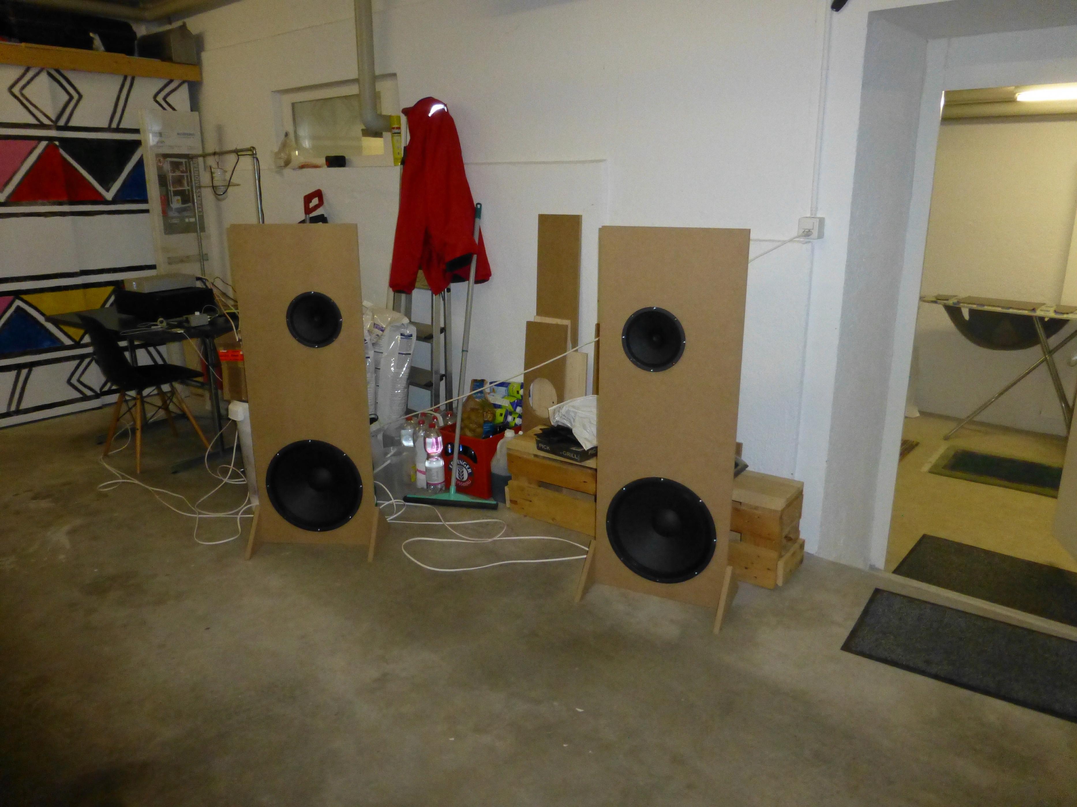

Still looking for a good use of the regular Betsy (not the K) for some form of Open Baffle, that isn't as large as my lounge!
Any helpers?
I have tried a MJK style OB with an Eminence 15A as helper woofer. Without a helper woofer the bass is just too weak for my taste. I used some surplus MDF, a miniDSP and bi-amped using 2 Gainclones. Betsy required quite a bit of equalization to be somewhat flat.

IB is basicly like a very large closed box
infinite means that front and back cannot couple acousticly
wall mounted is very far from being infinite baffle(IB)
small closed box would be closer
but the trick of IB is very low bass, so ...
but if you call it a small box with very big baffle, no objections
that at least is explainable by giving the needed acoustic BSC support
