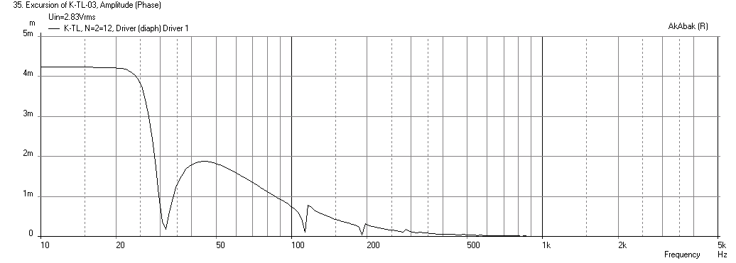

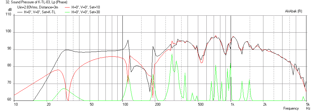

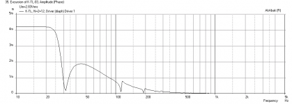

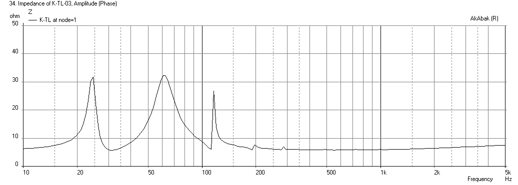

And if you like the combination of great deep bass extension of a ML-TQWT, but with the wide directivity of a Karlson-aperture, a 1.33X scale Karlsonator (40 in tall cabinet) is tough to beat. The frequency response, impedance, and cone displacement are below. This is with the speaker placed against a wall and measurement at 3 m away.
