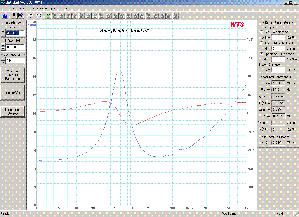

Betsy impedance plot

what is the woofer ?

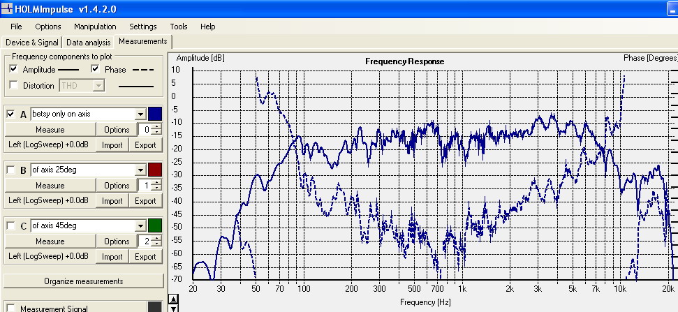

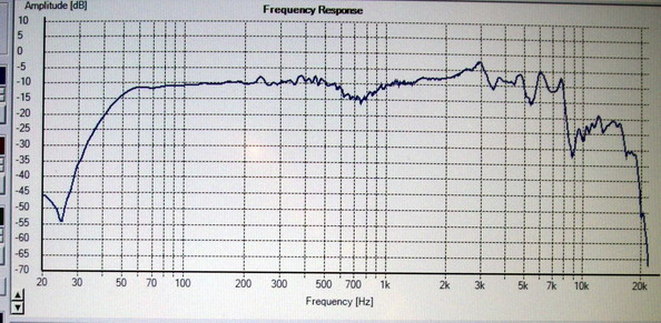

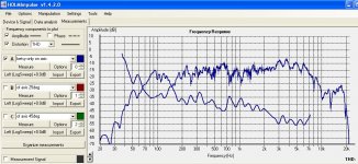

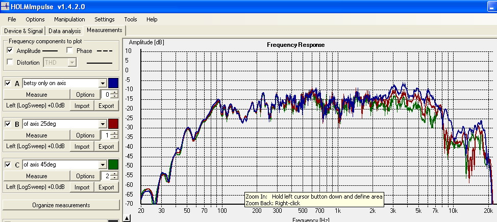

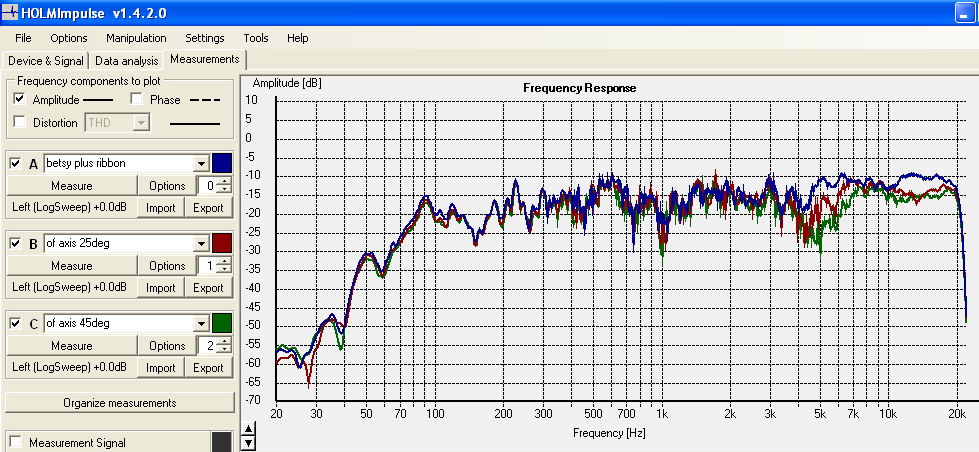

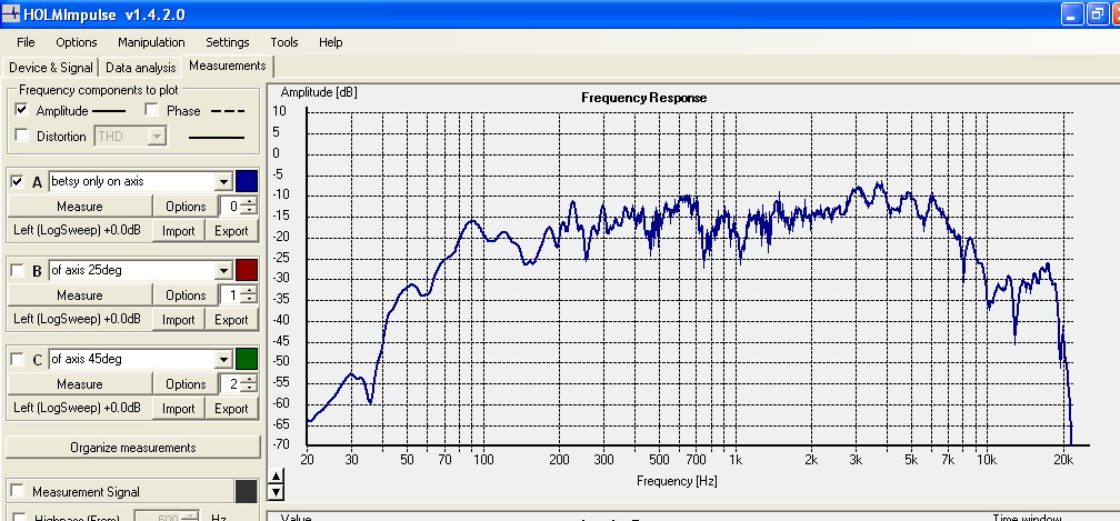

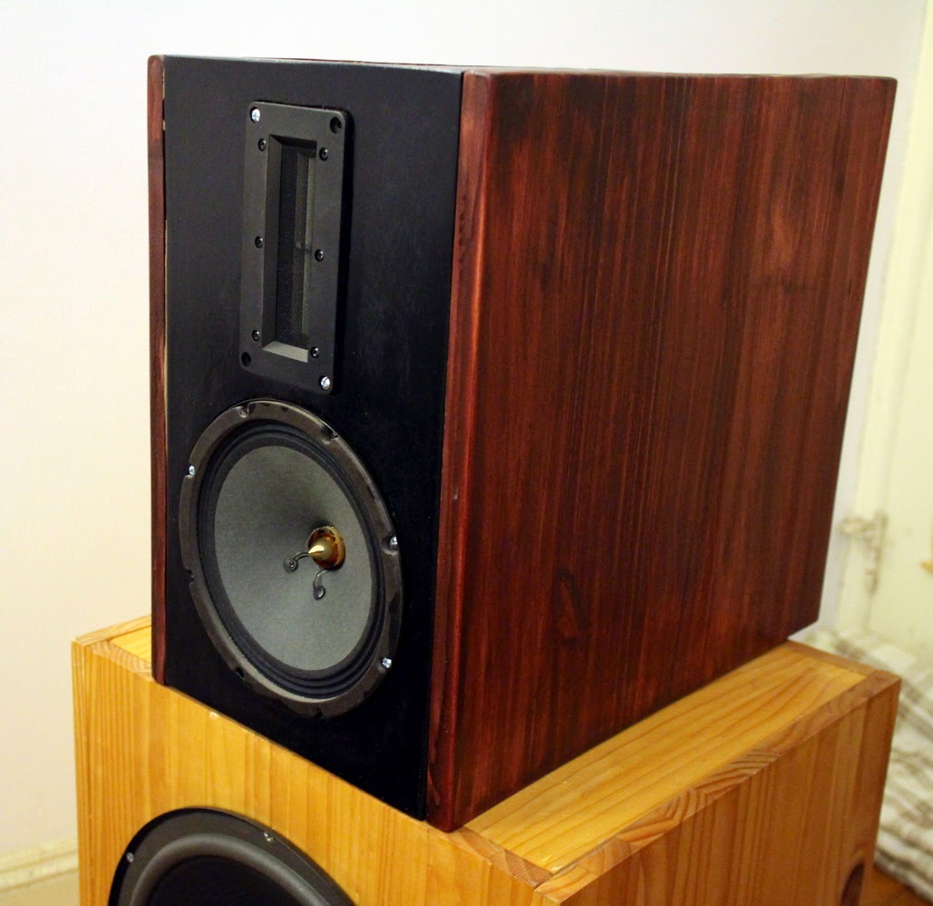

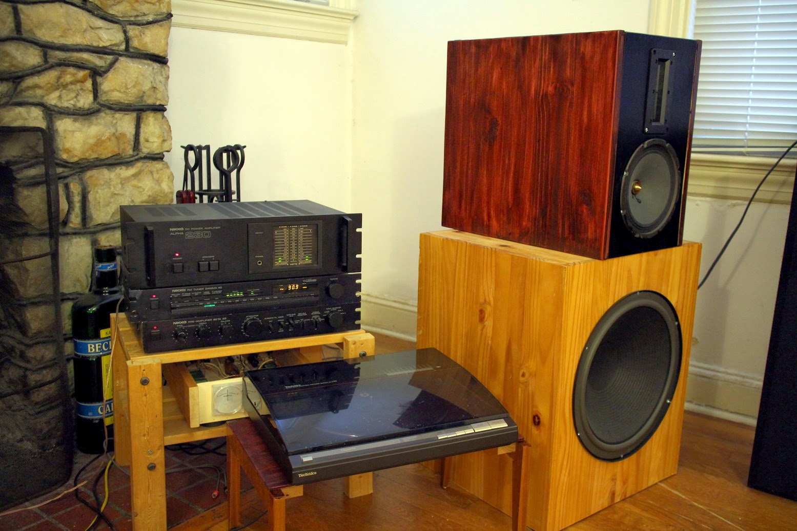

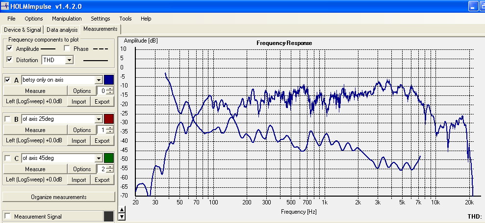

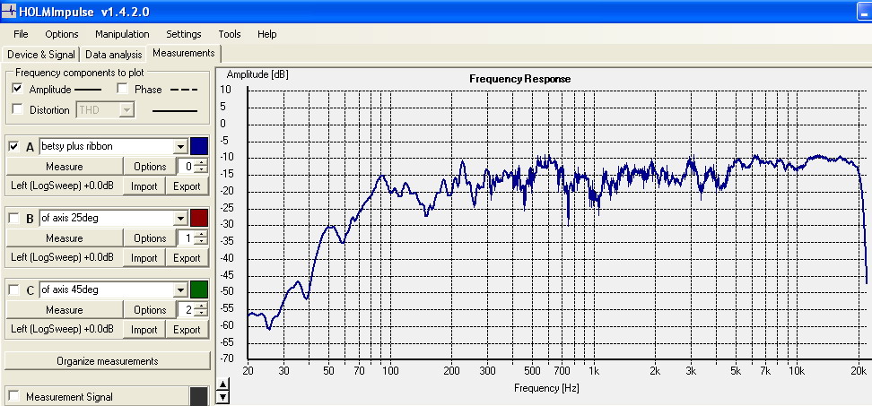

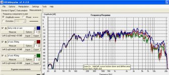

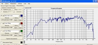

here are some promised fr responses for modified betsy
pretty self explanatory
