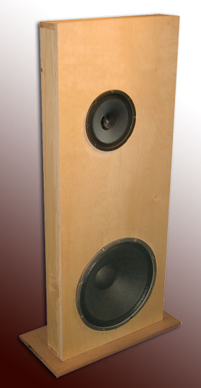

Hello Wild Burro Audio Lab fans!
Oftentimes simpler is better. Nothing is simpler than placing a Betsy on an open baffle to enjoy music. But the Betsy can use help in the lower octaves so I designed the Boomer. The Boomer is an easy way to add bass. It’s an Alpha 15 woofer mounted close to the floor that’s powered by an external subwoofer amp. While taking up the same amount of floor space, the addition of two 15 inch powered woofers really fills out the bottom octaves producing full, warm, rich bass that’s adjustable to taste using the amps separate volume and crossover controls. Once you listen to the Betsy with the Boomer you will find it very difficult to enjoy the Betsy, or just about any other speaker, without the added bass to round out the sound. If you have any questions about the Boomer don’t hesitate to ask.
