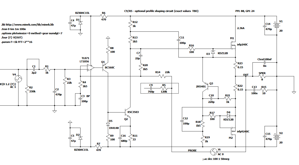

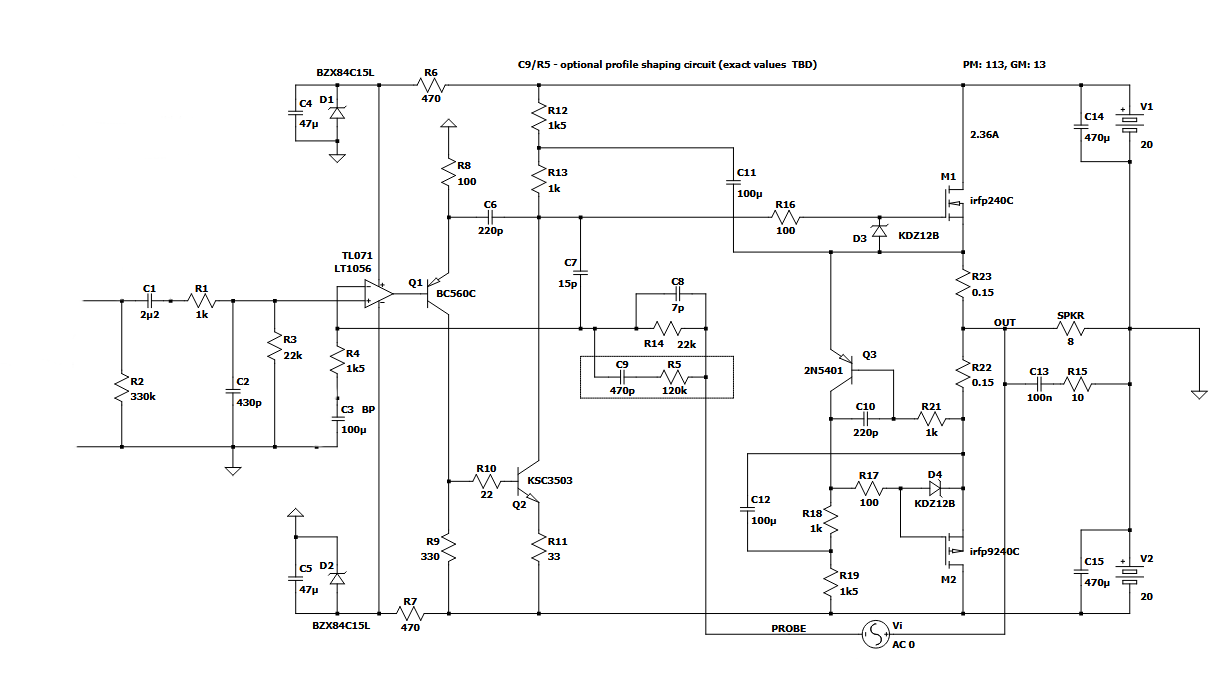

So we have 2 slightly different versions of the schematic. One ('original') from the post #45,
and 'new' one (proposed by Paul).
Differences between both versions (as far as I can tell):
a) simpler compensation scheme for new version
b) 'balanced' Q1 behaviour
c) Ideal OLG plot, with higher gain margin (24), and phase margin close to ideal (88).
d) same capabilities to shape fft profile.
e) pretty much the same Thd
f) pretty much thesame capabilities to handle squares and output capacitance
Both versions can be easily sharing the same PCB (already done).
I'm satisfied with both of them, but I like the newer one better.
I personally don't see the need to experiment further; don't think there is much to improve..
We squeezed as much as possible from this topology and 1 pair of outputs.
Should we settle on one version, or keep it open?
Hugh, can you analyze the new one, and give us your opinion?
All sim files attached (20V + 27V) as zip.
1st version
2nd version

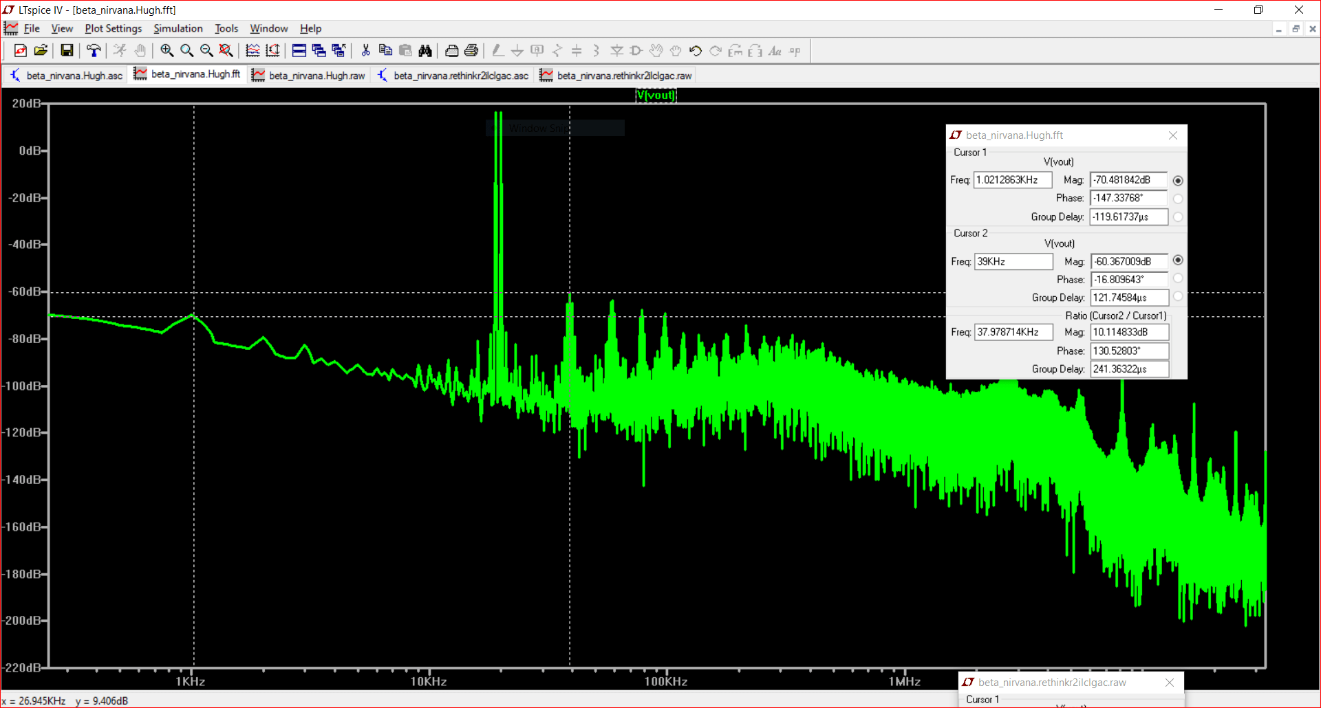

Hi Hugh, I guess you are looking at the second harmonic in the SPICE error log. Some of the phase shift that registers there is due to the low pass RC input filter. Although it may be nice for the second harmonic to be in opposite phase to the fundamental at 90 degrees - this figure varies somewhat according the output voltage. Maybe negative phase could be judged by falling inside some prescribed limits. A lot of listening involves low output power where variations would be low. One could also compare IMD profiles - I have done a 19Khz plus 20kHz with results attached.
I have changed the circuit I posted so it is a match with your except for the compensation schemes. When that is done the results for various measures are identical - for example both give minus-106.9 degrees for second harmonic at the same output setting.
The other factor in common is the op.amp and one could conclude with the Gain Bandwidth product this generates this is enough to iron out minor differences. minek123 is showing TL071 as an option, in post 49 he showed a photo of a square wave on his 'scope and claimed this worked as well as LT1056. My tests included a 100n capacitor in parallel with the load.

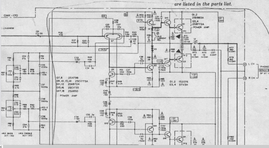

Here is an example of bass/treble control plugged right into a feedback loop.
Pioneer SA 520 from 1980:

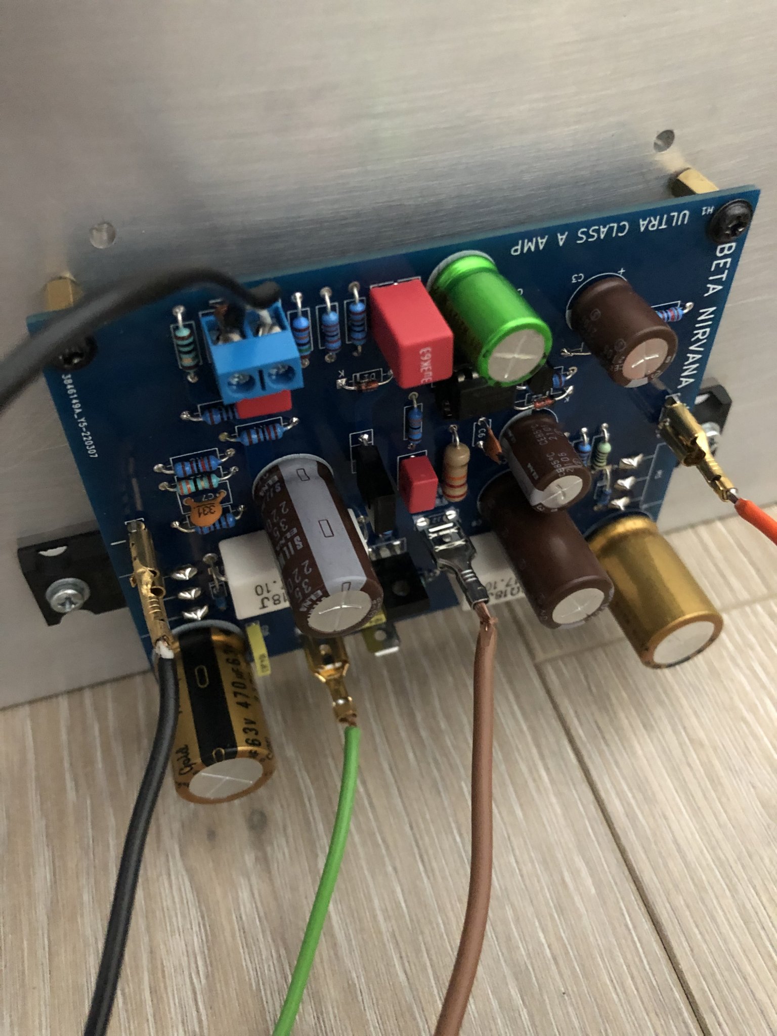

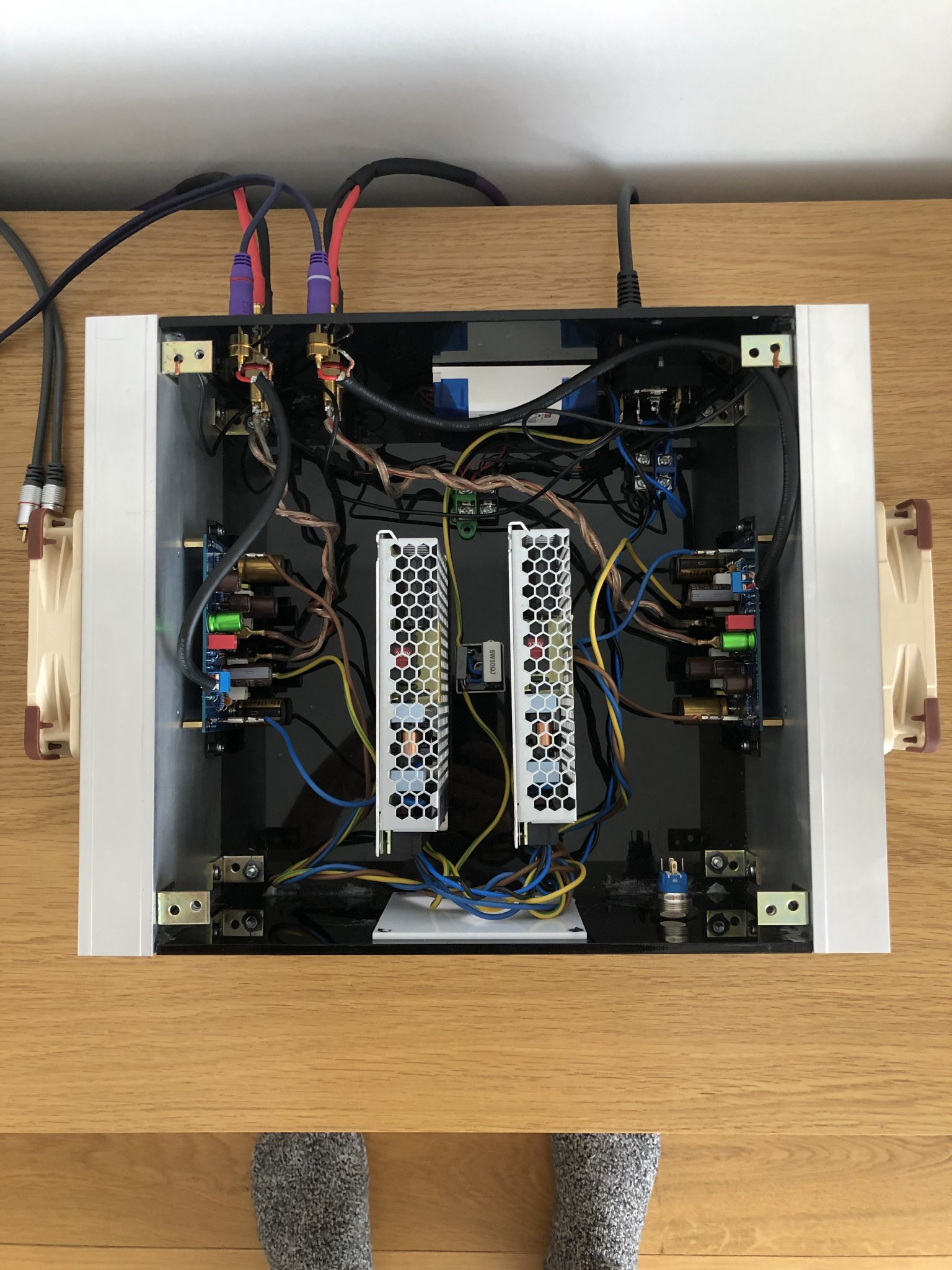

Hi Guys,

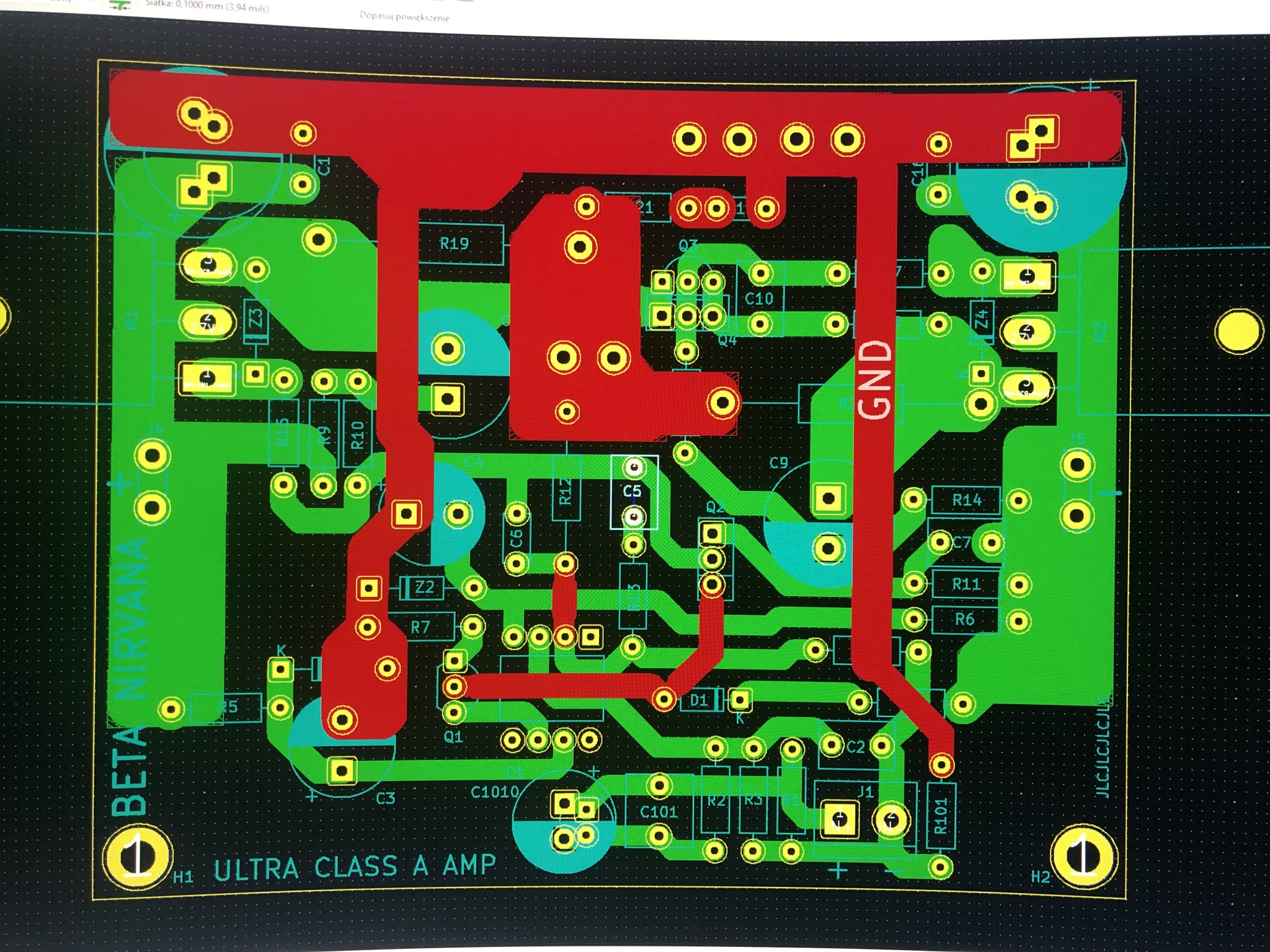

minek123 made me post here 🙂 BETA Nirvana / ALPHA OPAMP Nirvana assembled on my lame PCBs. They arrived yesterday, so as it was Friday I managed to finish the amps. PCBs designed as per schematic in post #114 by Hugh. Changes: c7 (330p), c6 (6.8p), q1 (ksa992), q3 (bd140), r19/r20 (0.18r), supply voltage 26v.
Opamps are TL071 (last 2 found in my dustbin) - offset 19.5mv and 3.5mv
If you can help me improve on KiCad layout or point what to change to make it better I’m willing to do it and share gerbers. I’m just a hobbyist as far away from electronics in my daily work life as one can be 😉
The amp is splendid. Thanks guys for the project
Cheers
Łukasz
