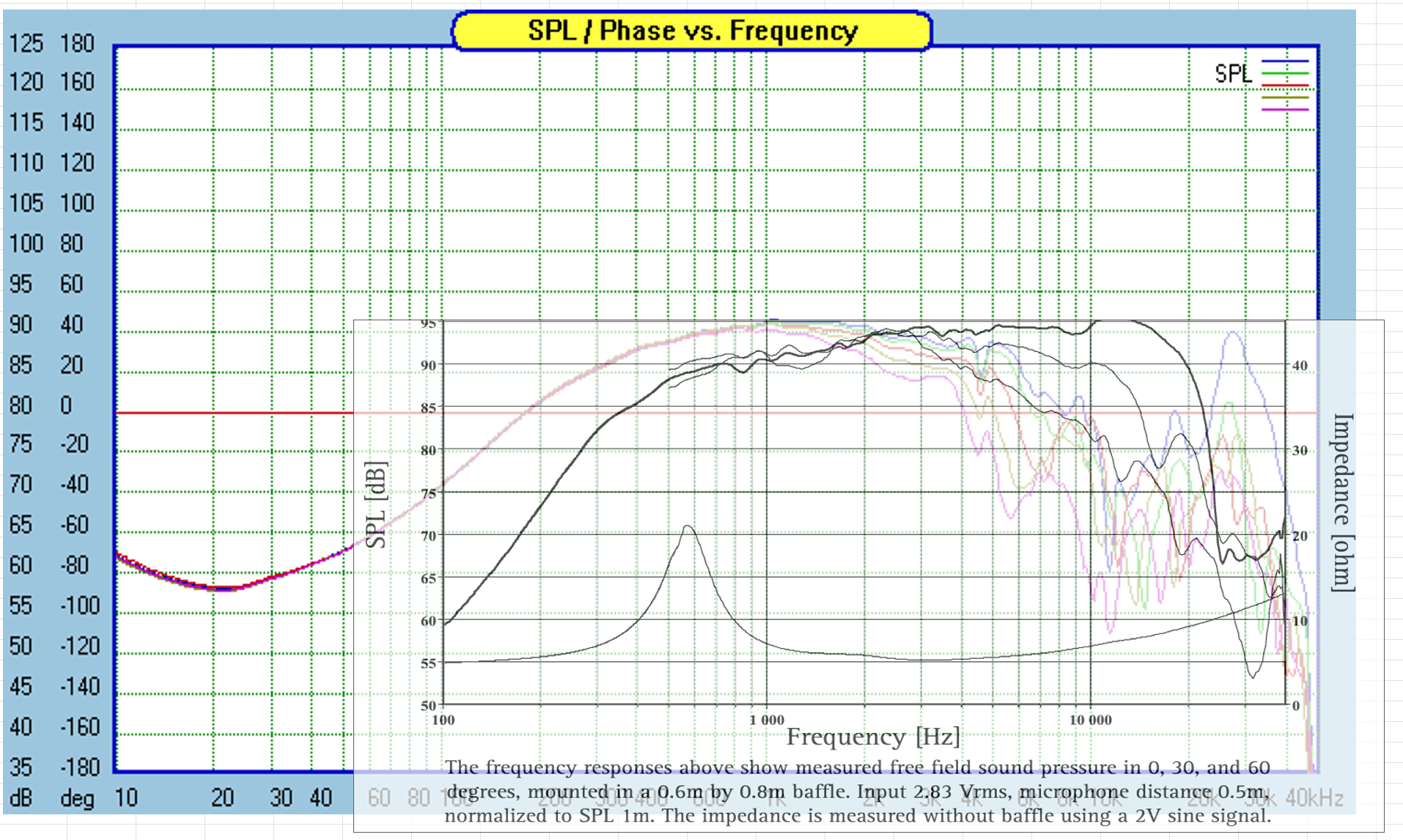

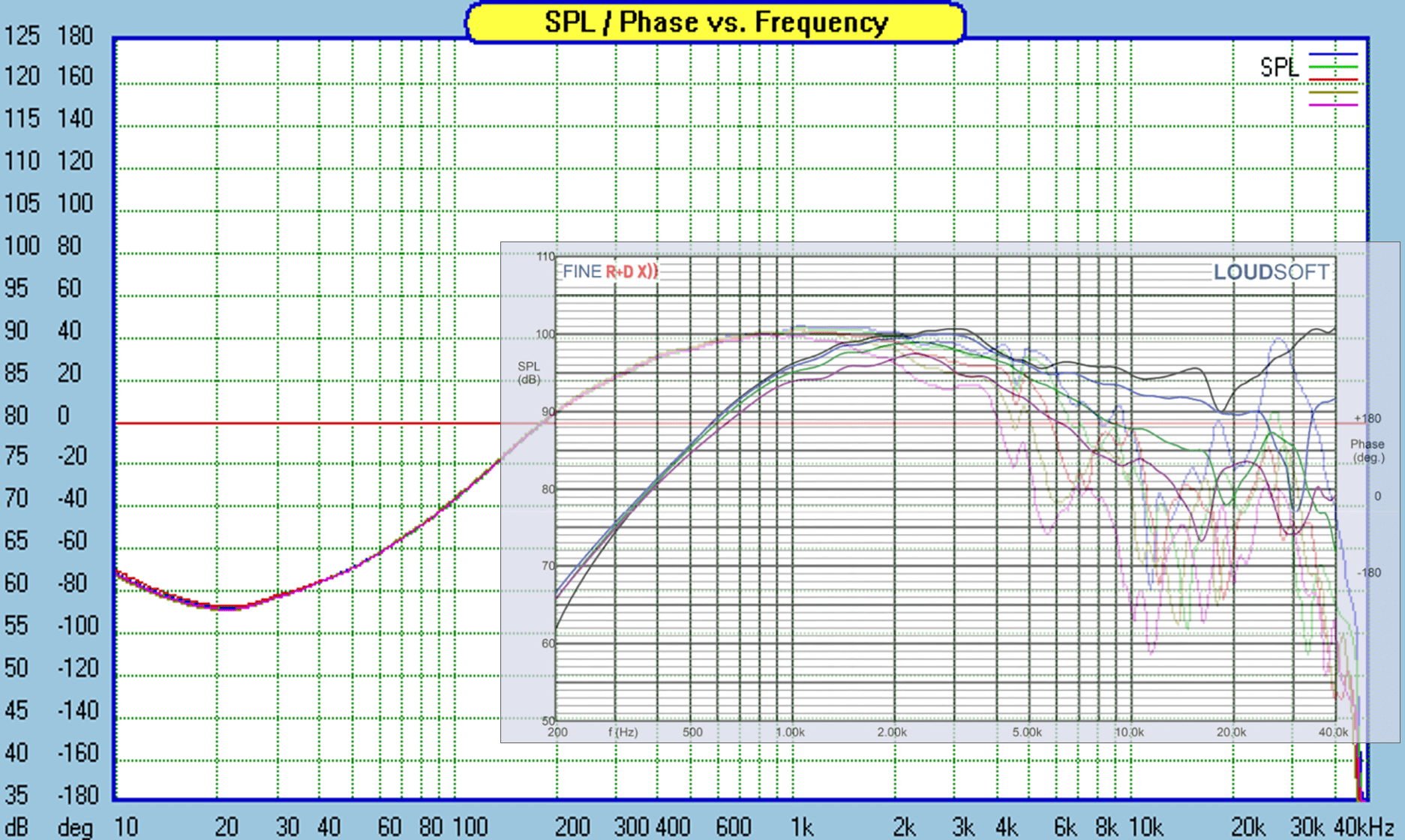

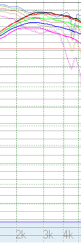

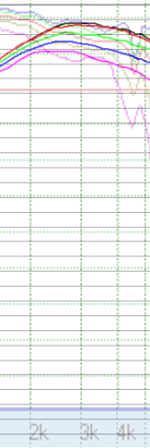

I worked on the design this weekend. I am trying to match the off axis dispersion of the mid and a tweeter. I realign the frequency, adjust the unit so the two graphs match.

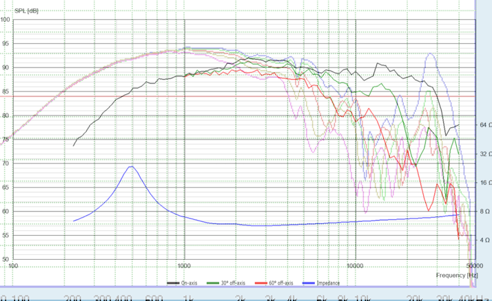

I think I tried at least 10-15 candidates. I dont have a lot of data for tweeters + waveguide sold separately. A very good candidate is the Satory Beryllium with waveguide.
https://sbacoustics.com/product/satori-tw29bnwg-4-beryllium/
Seems to be an excellent tweeter. On the expensive side for sure. One negative is the longer distance between the mid and tweeter compared to smaller tweeters with waveguide.
The graphs are not 100% perfect as the off axis are not exactly the same (22.5 vs 30 degrees, ...). But gives a good idea if potential good match or not.
Here the result for the Satori. Crossed at 2500kHz-3000kHz would be a very good match.
With the same methodology, other good candidates are the Seas DXT27, T25CF001 (the same one in the previous ATCs), SS 990000, ...
Even if I see some information on waveguide for a Seas T35, I don't find really a way how to purchase them.
Thanks for your comments! Enjoy the week.

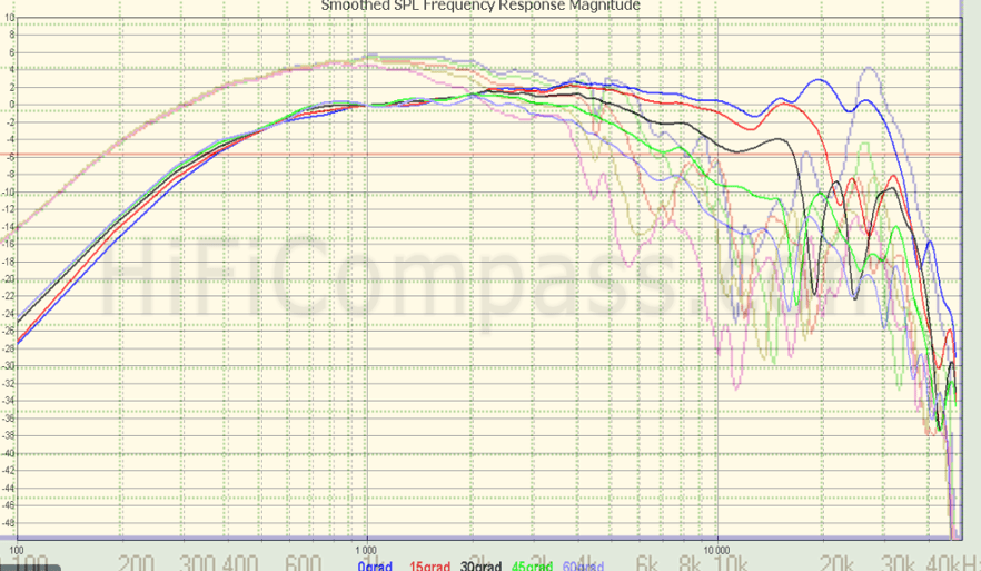

The waveguide for this tweeter isn't even working well until 20kHz ... for that price I would expect more. But it's not easy with these wide surround 1" drivers.

That's not necessarily a problem. Just use a slightly lower crossover frequency than ATC's 3.5 kHz and you can have the same c-c distance/wavelength ratio as the 3-way ATCs have.One negative is the longer distance between the mid and tweeter compared to smaller tweeters with waveguide.

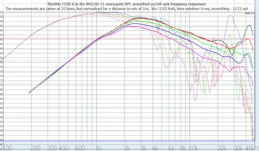

Hi everyone, thanks again for all your inputs and information. Maybe some have missed it in previous post but I have already purchased the woofer. TD15H Acoustic Elegance that I have purchased used. Will use the woofers sealed in a 70l cabinet with bass boost (linkwist transform). Received the woofers yesterday. Impressive beasts...

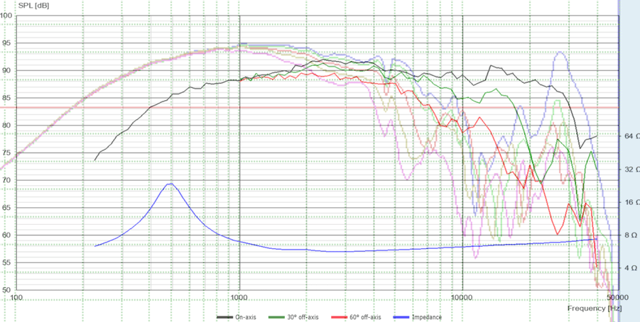

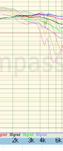

For the tweeters, I think I have came to some conclusion. I have looked at many off-axis responses for different tweeters and try to match with the ATC around 2800-3500 Hz. With a waveguide of around 10cm, I can have a nice match at the crossover frequency on what I call on the right side (higher frequencies). With waveguide larger than 10cm, I can have a nice match on both sides...

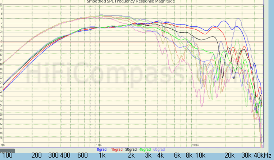

Here a nice match at approx 3500Hz with Wavecor tweeter. Same can apply for similar sized waveguides. Match is not that good at lower frequencies. Morel 378 would show similar good match at crossed Hz and on the right side...

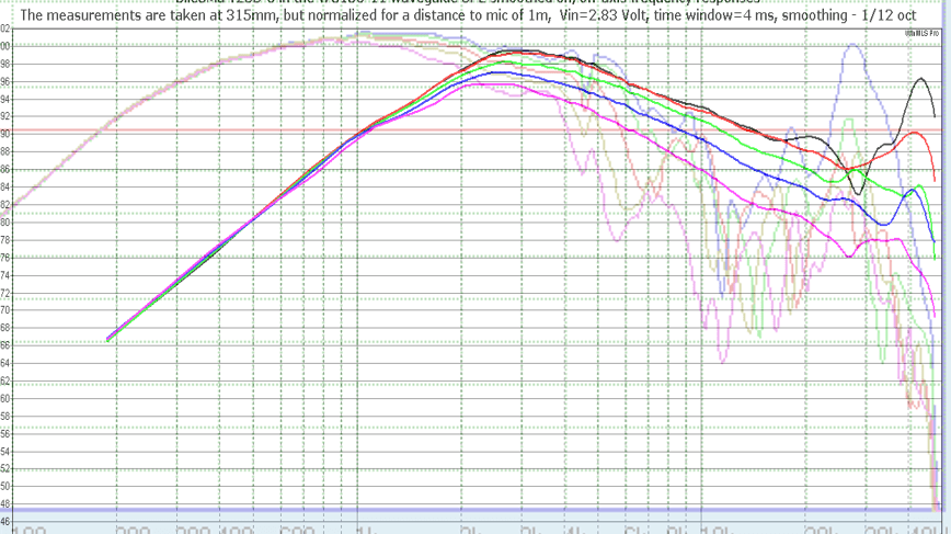

Here Bliesma T25b with a 15cm waveguide. Crossed at around 3.2, and good match both on the left and right. The Satori BE with waveguide would show similar results (at least close to crossover point)
The scanspeak 990000 has also a nice match on both sides (not as nice compared to 15cm). Waveguide is 13cm. But seems not to be a recommendation here even if seems to be more than good enough, could you elaborate the why? Here below the result.
So, my conclusion for now is that I should look at waveguide of approx. 13-15cm to get a nice match around the crossed frequency (left and right). Was maybe straightforward to you... 🙂
The Satori BE with waveguide is still a good commercial option.

The 9900 is a good tweeter, but it was not used extensively when it was new. I believe this is because people did not understand how to deal with it's waveguide behaviour back then (including me).
That said, a waveguide / tweeter system works best with a small dome, or a ring radiator. That's why we used the R2904 for the waveguide stuff in the OSMC speaker (see my signature for links).

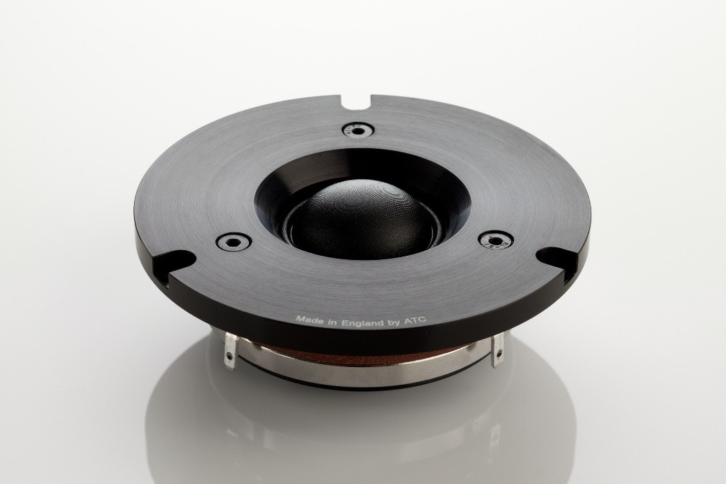

do you have an exemple or a graphic bettween a good dispersion with waveguide and wrong matching dispersion without at the low end of a tweeter ? i can figure it out
even on their flagship speakers ATC don't use big wave guides tweeters but a small one with a 25mm soft dome
