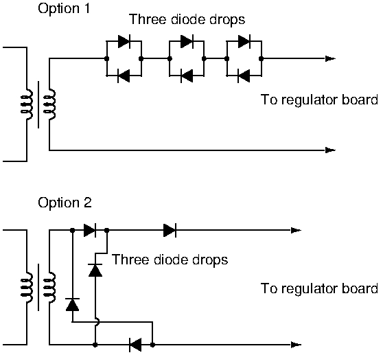

However, dropping only 2.5 v you could use 3 diodes series for example. Don't use 1 amp diodes like 1n4004 etc, it runs them too hard at full amp rating. use 3 amp diodes. voltage drop these days is often .4 or .45 v instead of .7 of seventies silicon diodes, so buy 5 or 6 to see what you get. Schottky diodes are .2 to .3 v so if you want to dial it in buy a couple of 3 amp versions of those in the same box. One resistor of the proper wattage would work but the load current has to be constant for that to work. diodes don't vary so much over 20-100% load change.

Indianajo's suggestion is good and valid but the first drop diodes have to form a rectifier bridge (4 diodes) or all the diodes have to be connected 2 and 2 in anti-parallel. Else you loose the double rectifying effect.

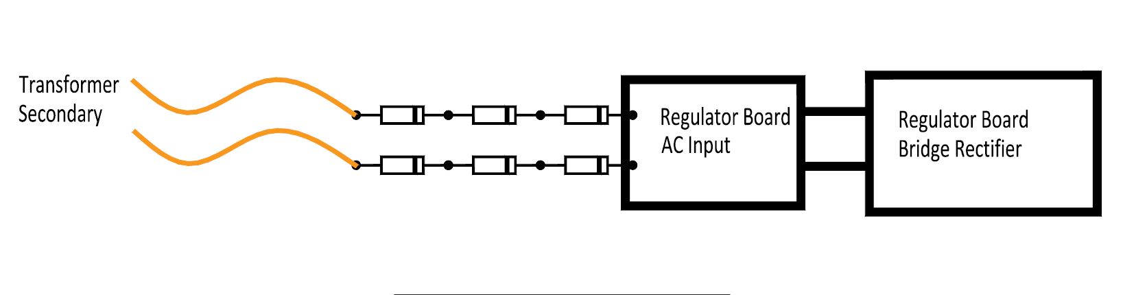

Is this what you mean?

I have a transformer with 3 secondaries, one of which puts out 9.5v, I would like to reduce that to 7ish volts before the regulator board, which will draw about 1amp.
I hope you are aware that the transformer secondary puts out 9.5V **AC** while te regulstor board works with 7 Volts **DC** 😱
Hope you are aware they are not the same thing, by any means. 😱
The regulator board will work with the 9.5vac
Then maybe that´s not a regulator board at all but a complete power supply, with rectification and reservoir caps, which also happens to regulate output (DC) voltage.
IF so,please make it clear.

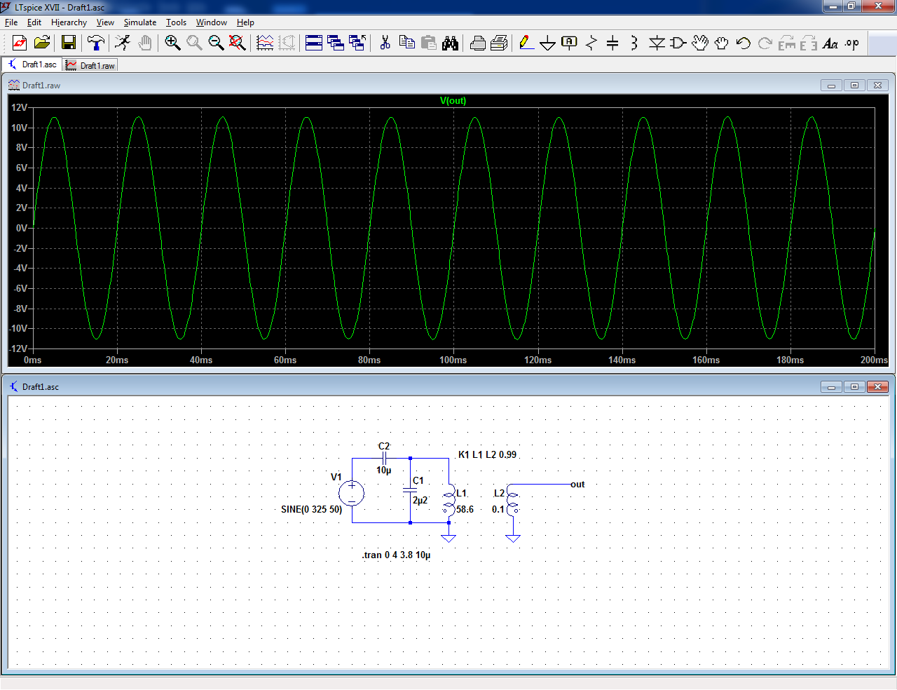

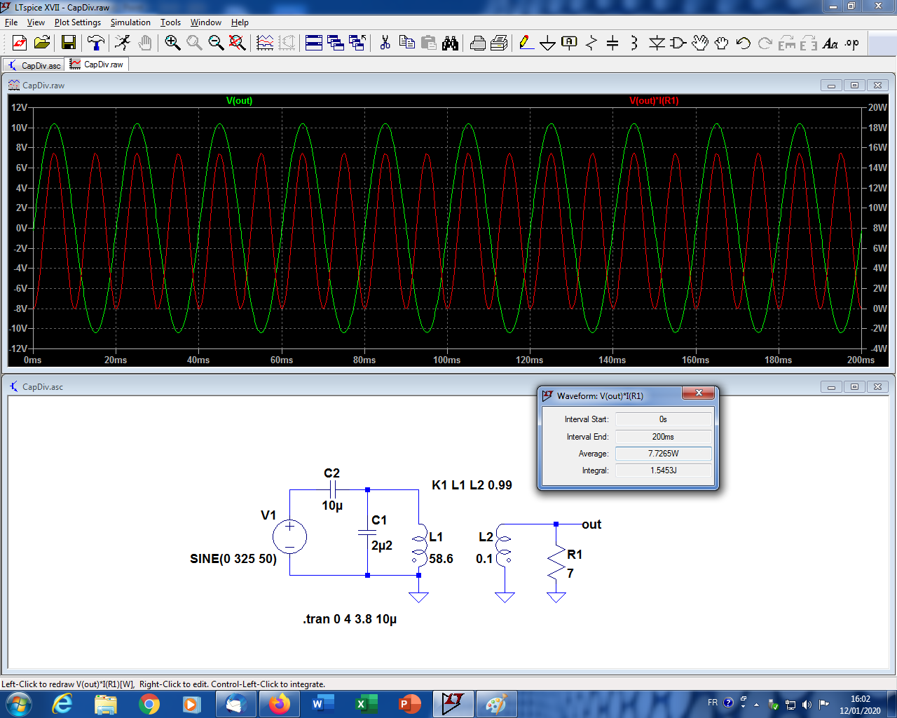

If you don't mind having the other two windings lowered by 25%, you can use this scheme:
attachment.php
It is a capacitive divider.
If the impedance of the caps is low enough compared to the current drawn, the voltage will not sag too much under load.
Capacitor C1 must be a X-rated type; 2.2µF is the highest reasonable value for such a type. C2 can be an ordinary 100V film cap.
The circuit will draw a relatively high reactive current, but it is not important because it will not heat anything, or register on your electricity meter

Yes thats right, I tend to think of the Power Supply being the combinaion of the Transformer and the Regulator board, but as you say, the regulator board has the Bridge reciifier, caps, heatsinks etc on it. I am very aware of the difference between the AC/DC thing, there an Australian band after all 🙂
No, one of the below options.
