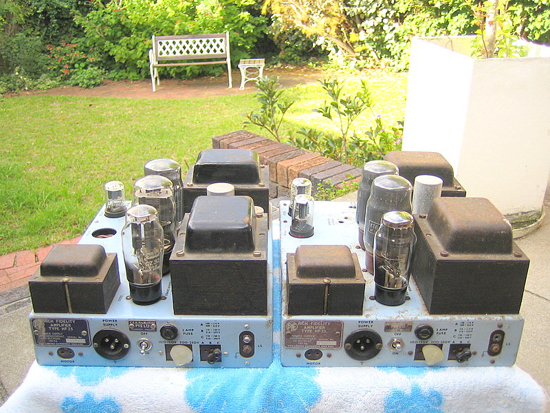

Hi All
What is the best way to re-apply lettering to refurbished/repainted amplifier chassis.
Restore of these two monoblocks will start in a few weeks when we have warmer weather. I will do the stripping, removing of old corroded paint and chassis prep and finally repainting in the same blue colour. A vexing problem is how to re-apply all the lettering on the repainted chassis which is aluminium.

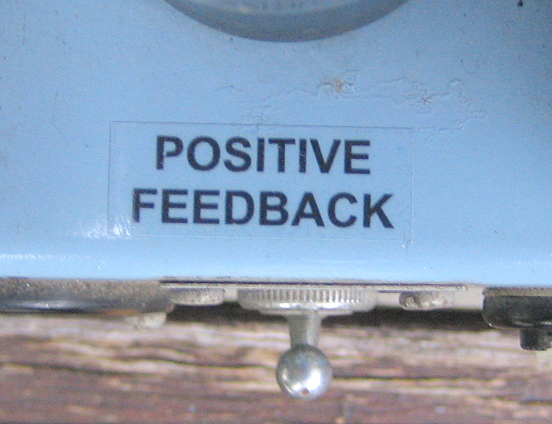

I have investigated a bit and called many firms including 3M but no-one has reverted offering a solution. I local printshop made me a selfadhesive clear sticker as a test and as you can see in the first pic, it looks awful as the label's edges are showing.
The term 'waterslide film' has cropped-up and I have read a bit about methods of use but until now, I have been unable to find any firm using the material.
Any more ideas? Letraset is out as there are too many legends.

Letraset went bust. Their main market was in graphic arts - making up advertisements for photography based plate making for magazine adverts. That's all done on computer now.
However, you can still buy sheets of letters in vrious fonts that work on teh dry transfer principle same as good old Letraset.
One of my coleagues makes up lables on his PC, and prints tham out on a laser printer. He sticks a thin adhesive clear plastic sheet on top of the printout (so the wrting is between the paper and the plastic. He then soaks the printout in detergent for while, and that allows him to remove the paper. He then sticks the plastic down on the chassis. This will have the same problem as the sticker your bought - the outline will be visible.
What I do is apply the dry transfers a' la Letraset letter by letter direct on to the chassis (or front panel). I then spray the whole chassis with spar varnish to passivate it and prevent the dry transfers from rubbing off.
I've also experimented with spray painting through plastic stencils available from arts stores, but the fonts are limitted to large sizes and the results have been dissapointing due to paint bleed. You wouldn't use stencils on a front panels, but for marking tube types, trim-pots etc on the chassis, they would be perfectly fine if I could fix the paint bleed.
There's also a variety of Dymo-style tapes that don't look too bad. The fonts are good.

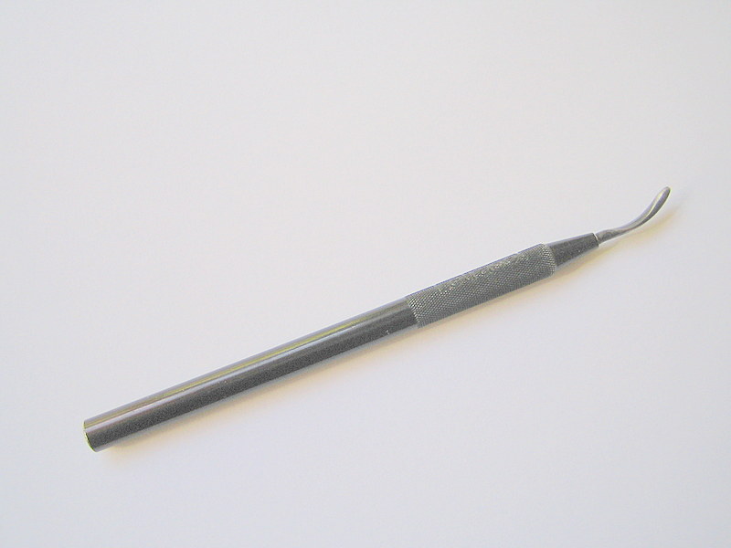

The pic shows one of my Letraset application pens from the distant past😀
I had a quick look and found I still have a few Letraset catalogues, as well as one from a competitor - Chartpak. Letraset however was the best brand imo and the local firm I used to buy from was Ozalid, here in Cape Town.
