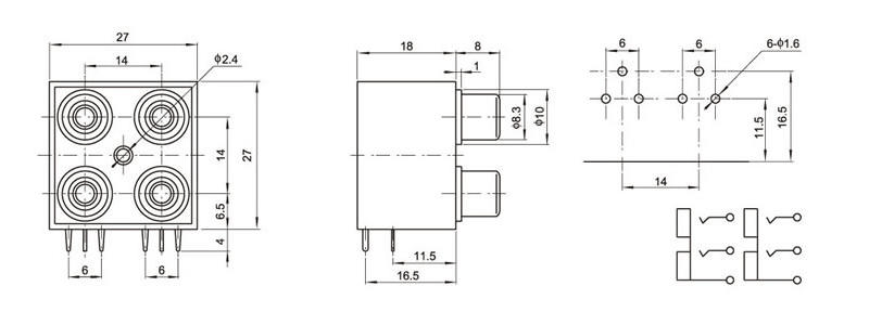

If you have no access to published specification; I'd use some vernier calipers for measurement, so you can work out hole centres from the edges and diameter of the sockets.
Print or draw outlines of the over-sized (I'm guessing 12 - 13mm) socket holes and 2 x (4mm?) screw holes and centre lines. Stick them to the case good with 3M spraymount ideally (or double sided tape, or whatever). Draw or print the centre lines for the holes on another bit of paper and stick it to some spare 3mm+ thick metal or plastic (or scribe these marking lines on it) as a template guide. Carefully punch, centre drill, then pilot some small holes in this guide piece, then stick that to the case with masking tape (or a clamp) to align with the stuck hole and centre pattern, for drilling the same sized small pilot holes through into the case. Drill out the screw holes to 3mm. The screw holes could potentially be a bit oversized (4mm?) to give the PCB fit some wiggle room (or for isolating the screws) and you can always use pan head screws. (I guess the phono socket modules take those blunt self tapping style screws, do they?) You may wish to use these holes as you drill them to firmly secure the template guide to the case, while drilling other pilot holes.
Remove the template guide and drill out the 8 pilot holes slightly undersize, in case of drift. Then file them out carefully to the printed oversized outlines. For example, you may wish to go from a 3mm pilot to 12mm final hole size in stages of 6mm, then 9mm, to preserve the centre positions. If you then end with an 11mm bit, there can be 0.5mm of file clean-up around each hole, which might account for any drift in the drilling. This may not be necessary if the pilots are well drilled, of course, but is a way to assess and gain lost accuracy. The stuck paper guide should act as slight protection too. (Step drills will make a mess of it.) Try keeping the case firmly secured if filing, and use purposeful, considered, vertical strokes only. Hold both ends of the circular file. Finish with 150, then 300 grit paper wrapped on the file to remove file marks.
If you do want to isolate the sockets from the amp chassis, then the screws will somehow need a sleeved insulating washer (you could use a TO3 isolating spacer, for example) and not be able to touch the sides of the holes drilled for them. But I doubt these sockets do need to be isolated, since they seem designed to make contact and are depicted that way on your link picture.
These phono holes are big, so their accuracy of fit to the socket is not that vital. The accuracy is in the positioning of the 2 screw holes in relation to the PCB in your case, then in the relationship of those 8 phono holes to those screw holes. So even if they are off; if they're big enough, you won't really notice, since the sockets themselves will always be aligned.

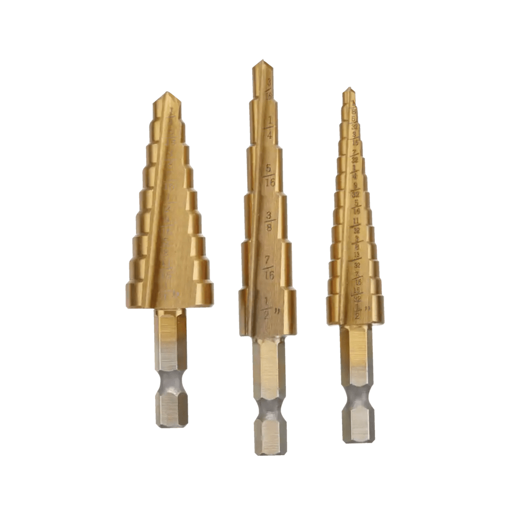

Two screws. I cut those holes with a step bit.
I use the one on the right in this picture. 3/8 should do. I put a piece of paper over the RCA jacks and punch it where the centre holes are. Then, I use that as a template to drill the chassis. I always use a hand drill for this stuff... My drill press is not as good in reality.
Measure yours, but most of them are the same layout:
I use the middle bit one to get to 3/8, then go one more step with the one on the right (13/32).

Step bit in a drill press at 500 RPM is my go-to for stuff like this. Pre-drill with regular drills until you reach the smallest step on the step drill. Clamp the workpiece! Use cutting fluid!I cut those holes with a step bit.

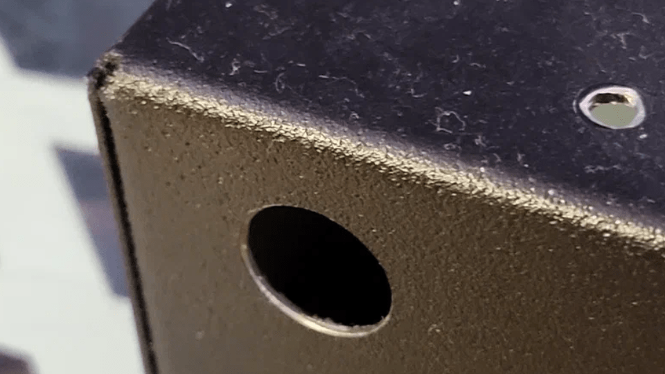

Here's the result in 0.4mm mild steel.

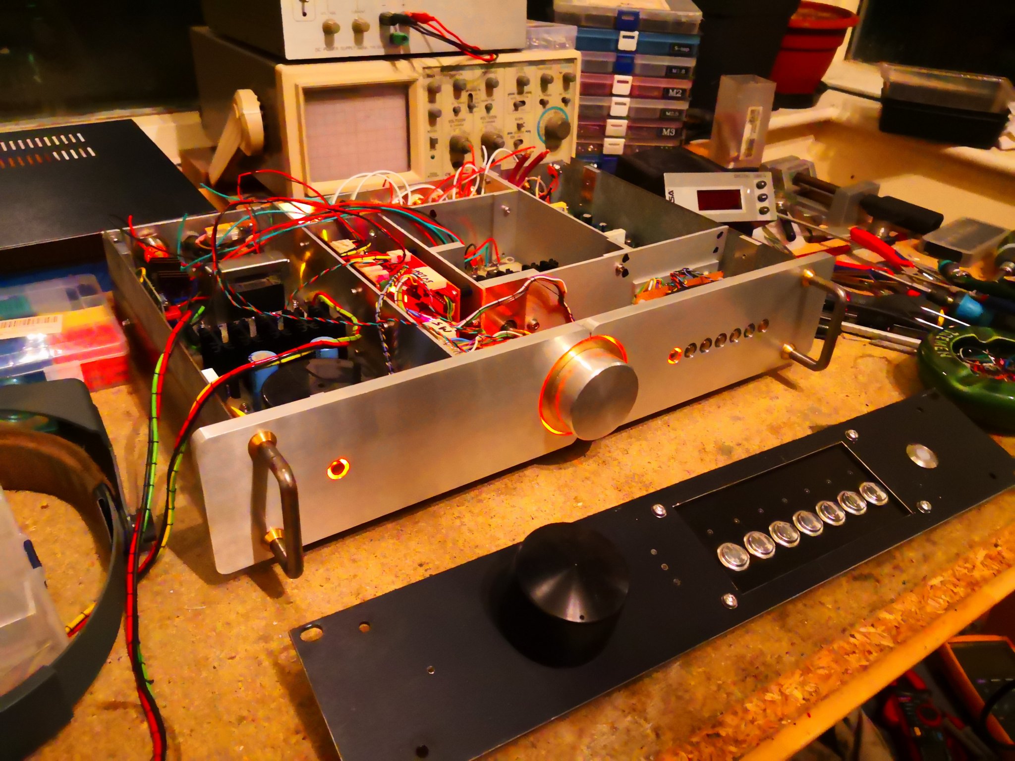

I thought at this stage I'd introduce some of my own work to show I'm not just talking shite. This is my preamp, recently refreshed, after decades of service. The old panel is below. I rustled up some "floating back-lit" push-buttons in 10mm Alu plate. The big knob is in the middle because I only had 2 short bits of plate! I did a new back panel too, but that was only 3mm thick.
