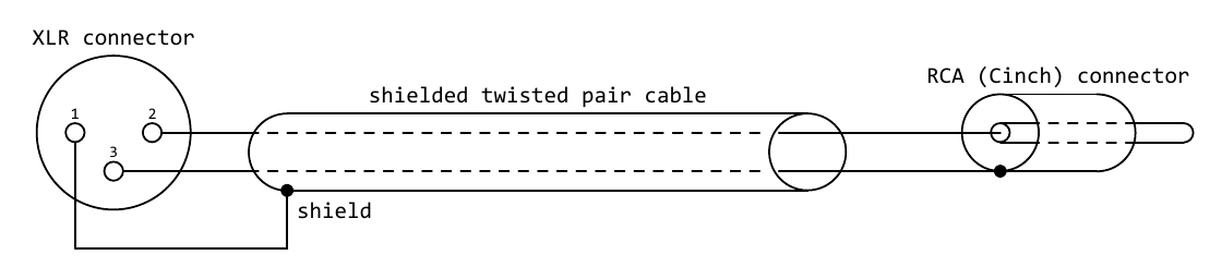

Yes, I tend to agree, but some (well regarded) manufacturers recommend to connect pin 3 to pin 1.This is the only connection diagram that makes sense to me:View attachment 1099932
Jan
Yes. But were do you want the current to flow? Through the interconnect shield or the safety ground?If both devices have protective earth and you connect pin 1 to the unbalanced device's ground, you have a ground loop.
I wouldn't want mains hum current to flow through the unbalanced equipment, and a way to avoid that is to open the ground loop somewhere. The only safe way to do that if it is equipment that needs protective earth, is not to connect pin 1 of the balanced equipment to the ground side of the unbalanced output.
In case of equipment without protective earth, I would want a connection between the ground of the unbalanced equipment and pin 1 of the balanced equipment to get a continuous shield and to ensure I won't get large common-mode hum voltages between the two.

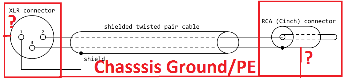

Pin 3 is either the inverting output in case of balanced interconnects or audio ground in case of single ended. Why would connecting audio ground or the inverting output to safety earth bring any benefit? This would either short a driven output to ground, making the op-amp driving the pin 3 output go into short circuit protection or at least become overloaded. Else, connecting audio ground to safety earth introduces possibility for a ground loop - the well known pin 1 problem.
Bill, my question is, can I leave out the left-side green connection?
https://www.diyaudio.com/community/attachments/se2bal-png.1099065/
Back when I had an active recording studio I had to do a lot of unbalanced <-> balanced interfacing. That image shows what I found to be the best way to do it. Notice that it is still a 3-wire connection, with pins 1 & 3 tied at the source (low-impedance) end, but not at the receiving end.
That comes from the HF teaching. All metal housings should be bonded together so no HF can get in or out. 1 & 3 open leads to an interruption. Good/bad for hum ground loops, good/bad for HF intrusion.Yes, I tend to agree, but some (well regarded) manufacturers recommend to connect pin 3 to pin 1.

There is no single correct answer, it all depends on the actual circuitry and wiring inside the devices as well as the XLR cable itself.When connecting a single ended source, you often see that the single ended hot line is connected to the balanced hot line (XLR pin 2), and the ground of the singe endsed source is then connected both to the cold line of the balanced input (XLR pin 3) as well as to the ground of the balanced input (XLR pin 1).
ground at the receiver end.
I believe this last connection, to receiver ground, is not required (assuming you have enough headroom), but I'm not sure.
What do ye think?
Jan
The main idea is that any balancing/leakage currents (from grounds/chassis not being at the same voltage potential) shall only flow on the shield and not be part of the signal transmission wires. Which means that
- RCA center pin goes to inner conductor #1 of the XLR cable.
- RCA shell goes to inner conductor #2 of the XLR cable.
Finally, the shield of the XLR cable also goes to the RCA shell in order to carry only the balancing/leakage currents. If you don't connect the shield, you might end up taxing the common mode input range and the CMRR of the receiver unneccesarily (which ususally isn't that great with impedance mismatch, see below) and the shielding is reduced to an electrostatic shield only and a bad one as RF might easily sneak in (broken Faraday cage).
At a closer look, to improve CMRR we also want balanced impedance on the source side of the inner conductor pair which means a resistor (or R+C or whatever) equal to the output impedance must be placed in shell tap at the cable entry for inner conductor #2. Further, the inner wire pair must be twisted and the shield must be true circumferential (braided shield), not a foil shield plus drain wire. By this the screen-current induced noise (SCIN) is minimized by making it the same on both inner conductors.
The gotcha is that the balancing current on the shield is not limited (notably when both devcies are earth-grounded) and that might cause I*R voltage drop errors at the sending end's inner circuitry if the layout did not take care about these GND currents. The same can happen with improperly designed balanced inputs, though typically less severe impact. In that case, it might be better to use hybrid shell connection for the shield, with an R//C (or just a C)... which must be circumferential design, ideally, in order to reduce balancing current at mains frequencies but have the Faraday cage fully working at higher and RF frequencies. Ferrites (=CM chokes) on the cable (use them generously) help quite a bit to reduce shield currents at higher frequencies, btw.
If possible, the best additional tweak is is to bond the two device chassis together as good as possible with a low resistance and low inductance path, preferably a copper ground plane or ground grid. That reduces shield currents on the cable to insignificance (best combined with ferrites). Remember to keep loop area between the cable and the plane/grid as small as possible, to prevent magnetic field pickup.

Sorry for being so late to the party. This is a subject that has been near and dear to my heart for over 30 years as all of my projects during that time have had, as a minimum, balanced differential inputs. I have read every paper and article on the subject that I could find. I have probably forgotten half of what I learned but I would still like to add my 2 cents (maybe there is only 1 cent left 🙂).I believe this last connection, to receiver ground, is not required (assuming you have enough headroom), but I'm not sure.
What do ye think?
Jan
First, let me say that there have been a lot of excellent replies in this thread and I will not credit them all here. I would, however, like to point out KSTR's Post (#33) which addresses almost everything I can think of, and very well.
Jan, to answer your specific question, if you have adequate CMR and CM range in the receiver, you are correct that the connection to the shield on both ends should not be required from a hum and buzz standpoint. However, it is very unlikely that you do unless the chassis are very well bonded or you are using a transformer on the receiver input. Power safety ground, at least in the US, is not adequate. It is noisy and not as low an impedance as you might expect. Also, in the US, most source components are only 2-wire. As KSTR points out, it is best to use a twisted, shielded pair with heavy braid for the shield (not just foil and drain wire) to minimize the potential between the source and receiver chassis. This also completes the Faraday cage around the wiring for RF rejection. Rane's Figures 17 and 18 have always surprised me.
The "cheap and dirty" interface cable referenced in Post #2 is better than nothing and actually works pretty well if the source has a very low output impedance and the receiver has a very high input impedance. You can do much better without much effort.
I make custom interface cables with an XLR connector on the receiver side connected as per AES recommendations (cable braid is connected to pin 1). [Receiver XLR connector pin 1 is bonded to the chassis.] On the source end, I connect the cable braid to the phono plug shell. The pin 2 wire is connected to the phono plug center pin. The pin 3 wire is connected through a resistor to the phono plug shell to create a balanced source (at the source). The value of this resistor (placed within the cable phono connector) is determined by measuring the output resistance of the source at the frequency of most interest (second or third power line harmonic?) and matching it. This maximizes CMR and minimizes the CM noise to be rejected.
The connection that I just described does, in theory, create a ground loop with stereo connections due to the multiple ground connections. But that is what balanced inputs are for! If this is a concern, one channel in the receiver can terminate pin 1 to chassis through a "hum bucking resistor" with an RF bypass capacitor in parallel, just like what is often done for unbalanced-to-unbalanced connections.
