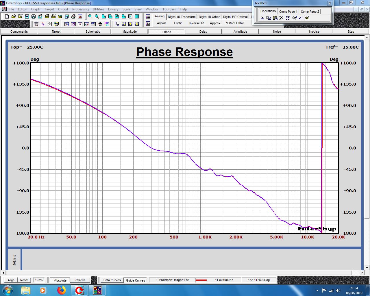

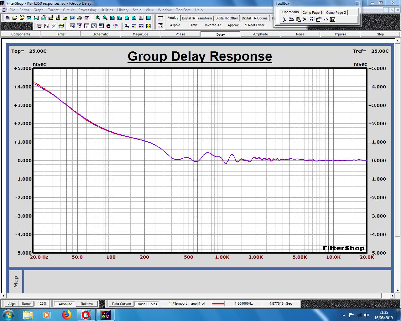

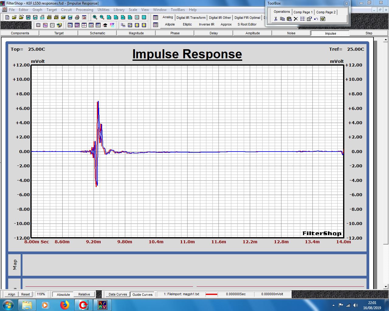

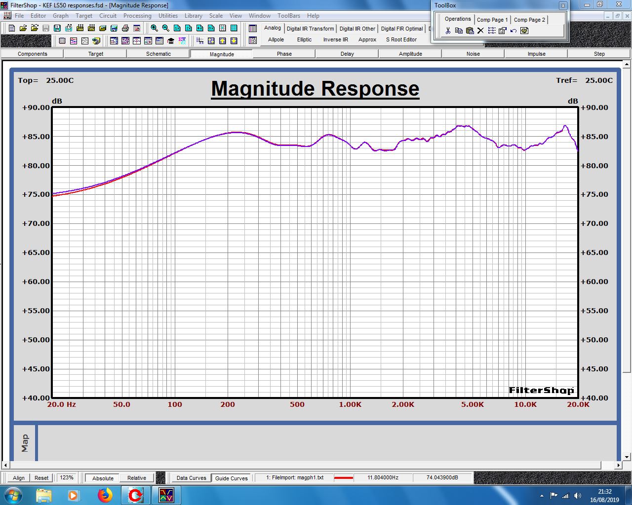

In response to your post #68, the notion of scrambled phase under the conditions you described is so far from that which theory predicts and without giving causal reasons can only lead me to the conclusion that you just couldn’t figure out the cause of the problem. I would suggest that if only for your own edification you go back and try researching this issue with perhaps more applicable instrumentation next time.
In any case I decided to go ahead with tests as described in my post #49 in which I used a KEF LS50 for the measurements together with a Clio microphone spaced at 1metre from the loudspeaker on axis. As you can see from the impulse response, I was able to obtain a reflection free time of about 5mS. This limits the LF accuracy to a little over 200Hz
All the data was recorded via ARTA software, supported by an M-Audio Delta 192 sound card and imported into Filtershop for display purposes with 1/24th Oct. smoothing applied on all but the group delay response where I used 1/6th Oct.
I made two measurements, one at 1 metre and the other at 1metre plus 7.5mm.
Attached are the Impulse, Magnitude, Phase and Group delay responses. As you can see, all response types with the exception of the impulse response have the two measurements completely overlapped. Flight times were subtracted in order to show the true phase and group delay of these responses.
These measurements clearly show that phase does not get scrambled at all as you claimed. There is no logical reason for the phase to get scrambled in any case.

Ben,
In response to your post #68, the notion of scrambled phase under the conditions you described is so far from that which theory predicts and without giving causal reasons can only lead me to the conclusion that you just couldn’t figure out the cause of the problem....
It sure would have been a simple matter for you to post 'scope traces like mine.
Using a signal which simultaneous presents a few frequencies (a square wave) you would have instantly convinced all of us of what gets to the ear at your two distances (or at least the ear at 1 meter, as you tested). I thought my post was a pretty darn easy to grasp demonstration.
(Esp. convincing since I changed nothing in the sound - just moved the mic a bit, as you requested. The sound didn't change but the phases re-scrambled, eh.)
Why didn't you?
Speaking of theory, if it weren't Saturday afternoon, I'd calculate how many degrees of phase angle a 2kHz wave makes in a meter, and how many for 2.5kHz. Then, I'd calculate phase angle for 1.08 meters...... If it weren't Saturday afternoon, I'd take your posted phase data and add that further bit of scrambling (albeit orderly) to the above confusion.
But why bother calculating just to satisfy somebody's need for theoretical clarity since we probably can't hear the difference anyway, Earl excepted.
B.

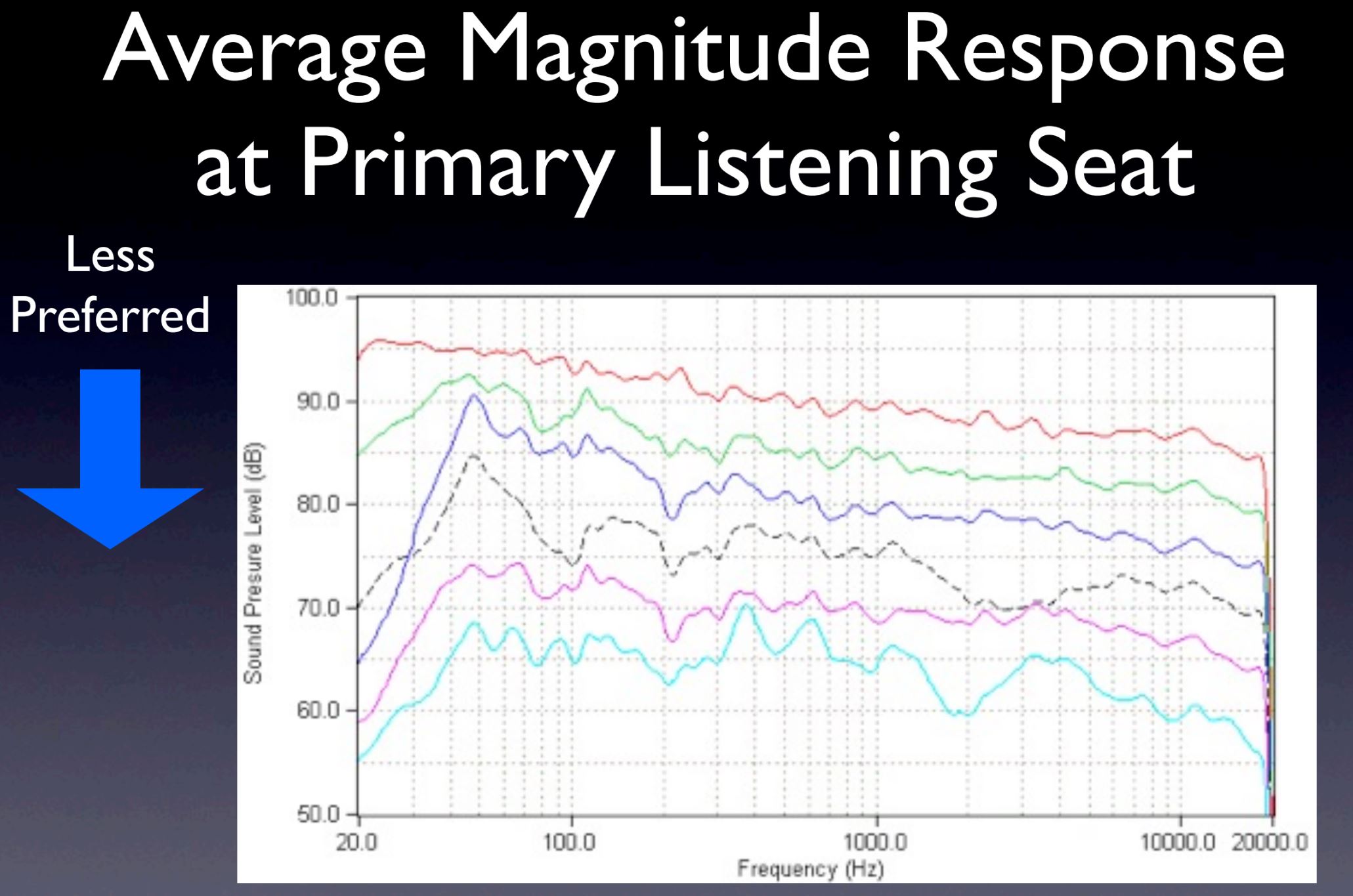

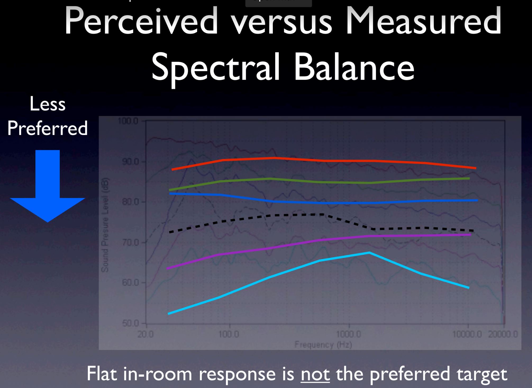

I don't think that anyone really likes flat. Harman has concluded that people prefer a slight HF rolloff, especially for CD sources, and a slight bass boost.
This is not the first time I am reading this, and I would like to read up on this to learn why / how a tilted SPL response is preferred. However, I couldn't figure out the original Harman report / paper / document. Any pointers or references?
But if the system is CD, then tilting the power means tilting the axial as well.
The power response reflects the power radiated from the speaker into the listening environment (covering all directions), so I guess it is a useful indicator of what we hear in a room. The statement above therefore makes a lot of sense to me (assuming "CD" = "constant directivity", not "controlled directivity").
However, aiming for a tilted SPL response seems in contrast to the widely used/accepted approach of "aim for flat SPL response (anechoic, on-axis)". Should we give up on flat on-axis response and aim for power response with a slight downward tilt instead (at least for constant directivity designs)? Or something in between?

You've hit the nail on the head here and it's interesting that most people aim for a flat SPL response at 1m on axis and ignore what the speaker is really doing in the listening room for the listeners.
In my experience the best thing to do is to aim for a flat response, as measured in an anechoic chamber, in the first instance. Then check the off-axis responses in the horizontal (up to 30 deg) and the vertical (say 5 deg and possibly 10 deg) to see how the response changes.
The horizontal measurements off axis will give you an idea of how the speaker performs in a room because we hear the direct sound supported by the reflected sound from the walls. If the character of the response (and therefore the sound) off axis is differnt to the on-axis measurement then you'll hear a lot of coloration.
Measurements on the vertical axis will indicate how good the integration is between the drivers. Again the response shouldn't change markedly at +-5 degress vertically. You'll probably see some dips and peaks appearing at +-10 degrees simply because of time alignment issues, so don't worry too much about these.
It's not completely true to say that we are aiming for a level power response in-room. This seems like a nice ideal but bi-polar speakers built on this basis often sound too 'hot' in the treble as designers try to match the power response in the bass.
Frankly, it is notoriously difficult to judge a speaker by its frequency response or power response. Frequency response is only a guide to help the speaker designer find out something that sounds 'wrong'. If you use a process of iteration between measurement and listening, i.e. listening tests to discover what you don't like and then measurements to see what it might be due to so that you can try correcting the problem, it's possible to get a really good result after weeks of going back and forth between the listening room and the anechoic chamber.
