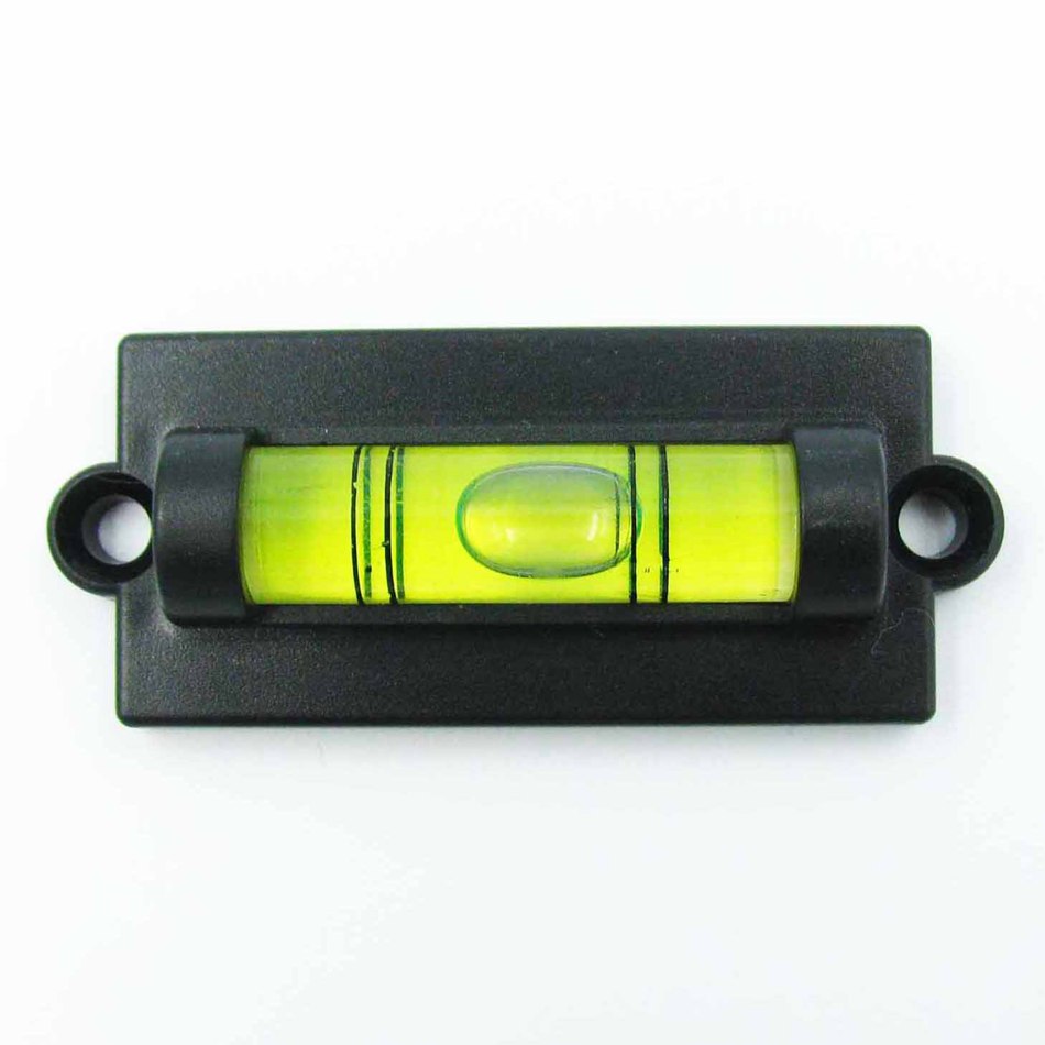

Little-known tweak trick ...
Is to literally level your speakers. You may use shims or other methods to make sure top of speaker is as level as possible. This is an "insider" trick to not only getting flat (level) frequency response, but it also helps insure that the sound waves will reach your ears at the proper 0 or 90 degree angle and not tilted a few degrees. 😀
