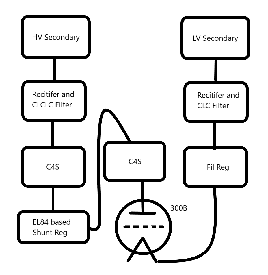

Ηi Derek
look at the pic , i m feeding a circuit with Attiny 85 chip (slow to fast speed )-two fan option 12V 4cmX4cm fan ,from main cap of the L-Adapter circuit ,no noise at all ,activated at 42C and keeps cool the input heatsink reg HV Salas .....
6V6 line preamp
Excellent! many thanks nikosokey. Good to see an example of forced air working well. It never occurred to me to get a small fan and place it close to the particular heatsink that needs additional cooling. Very clever.
