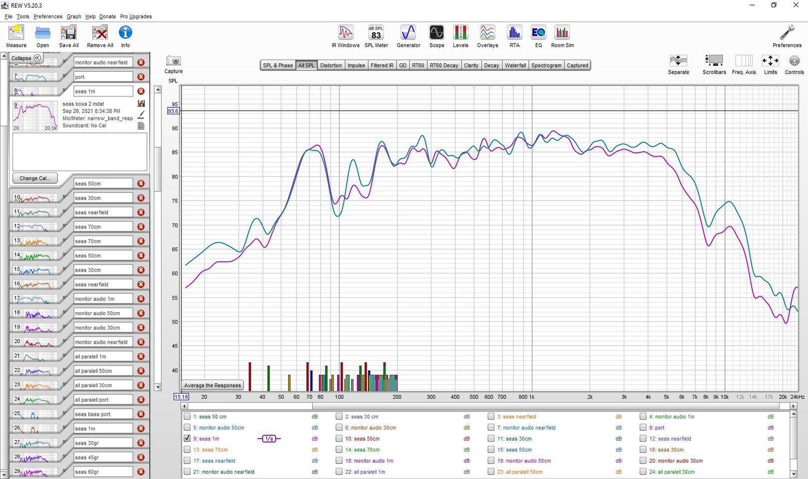

Usb vs XLR
seas p21rex/ddp h700,measuring with 2 diferent mic,mauve line,umik-1 calibrated by cross spectrum labs, green line,focusrite solo 3th gen+sonarworks xref20,factory calibrated.
