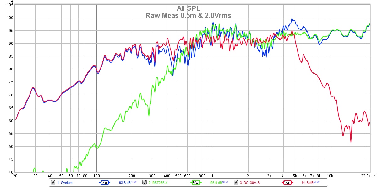

Take 3 sweeps with software of choice (I use REW) without touching speaker or mic: tweeter only, woofer only, tweeter and woofer in parallel. Use calibrated mic and measure the SPL and set Vrms of sine wave to correct reference value. A nice setting is 0.5m mic distance and 2.0Vrms sine wave at 1kHz as calibration. This scales nicely to 2.83vrms at 1.0m easily and is less susceptible to floor bounce dip. Convert sweeps to FRD files. Load FRD files into software of choice. I use Bwaslo’s Xsim but have also used Jeff Bagby’s Crossover Designer spreadsheet program which works great too. Adjust acoustic offset until simulated woofer and tweeter match measured response. Use that offset going forward with XO development.
Here is example of raw data. Your goal is to adjust offset in simulator until you reproduce all the little dips and peaks present in the blue trace:
