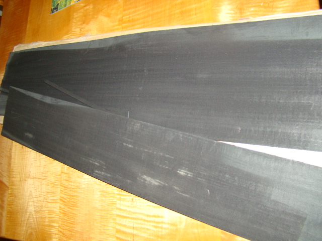

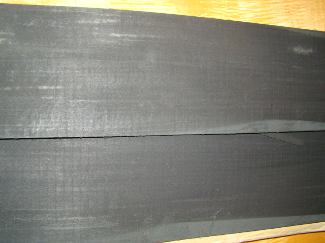

Oak for sure, I have done lots of Oak this way.

I tried looking black died veneer but all of them are really expensive!
RAW - this is exactly the finish I want. Can you please tell me how you achieved this finish? Would greatly Appreciate your help!
Ultra™ Penetrating Stain - Mohawk Finishing
I use to use mohawk products for all my finishing I did.
Wipe on then let it sit for 30 seconds then wipe off.Then let it dry over night. Then repeat till you get the darkness you like.
As well you can add this into the Lacquer while finishing.
If you do not have one even get yourself the small HPVLP compressor unit cheap
Electric HVLP Spray Paint with Gun System | eBay if you do not have a compressor.There is many out just like this unit.Sorry I do not remember the one I have but still use it from time to time.
I know I got it online for around 80.00 cheap. So if I do a small project fire it up in minutes no water to worry about from the compressor use it clean it put it away.
And if you have a compressor just get HVLP gun with a screw inline filter and you are set.
