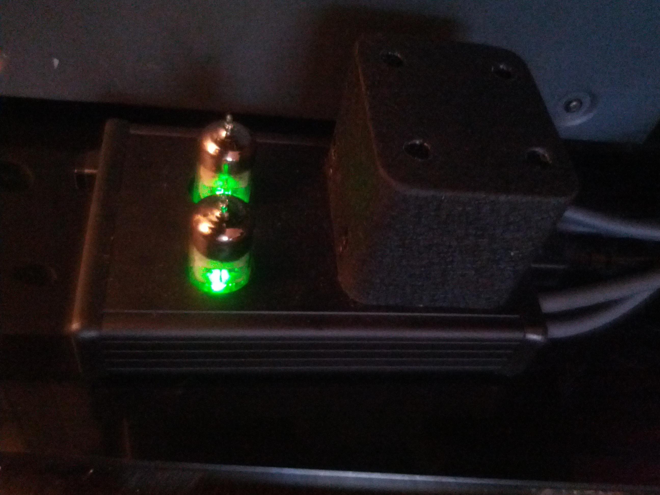

The 'Guanzo' valve buffer preamp I was using is also considered a good headphone amp...
Here it is encased and rebranded, but comments are generally good...
Amazon.com: SainSmart Assembled 6N3 Hifi Buffer Audio Tube Headphone Amplifier Pre-amp Kit with Transformer: Home Audio & Theater
6N3 Hifi Buffer Audio Tube Headphone Amplifier Pre-amp Kit – SainSmart.com
It sounds great with a NAD amp, phenomenal with Rotel 990BX, OK but mediocre with the ME550 amp...in comparison
I got 4 of them...they were $AU45-50 on ebay...
Not sure what the Z output is on them...however if they are anything to go by, the JP200 should sound pretty good...
This is one that I modified and encased - removed the pot; resoldered entire circuit board with Mundorf silver solder; hard-wired leads (silver-plated balanced mic cable - shielding grounded) with RCA's only on one end - to be used in this instance as a valve buffer ---
--- makes a big difference when put between pre-amp/amp on NADT773
