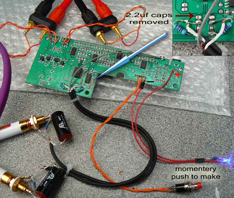

Puffin said:Lostcause. DC on left channel is -0.06 and Right +0.05. I attach a copy of your phot with details of where I connected to.
http://i73.photobucket.com/albums/i239/saxonsex/S2000.jpg
Hi Puffin, that photo is Barry's but with such small DC offset you should not be getting the 'sucking-in' on your speakers.

Lostcause. The cones stay in until you power off. However the sound through them is not distorted, but clearly something is not right. There is a large thump on switch on.
I am using it as a power amp.
I attached the ground for the phono sockets to the ground underneath the jack socket. Will that be o.k ?
Hello Puffin, I 'm sorry that I didn't make it clear that you must remove the on-board 2.2uf caps and connect to the points you marked in the picture with your new input caps. You then connect the other end of your new caps to your new input terminals and add a 47k resistor to ground for each channel..
Hope this makes sense, Barry..

Well spotted Barry, I didn't realise that Puffin hadn't put new caps in there🙄 Must learn NOT to speed read
Sorry Puffin, you have effectively bypassed the input caps so thats why you're getting DC offset.
Audio1st. Thanks for the pic. I have done the mod and everything is fine now (no suck in on start up) however I cannot put too much signal through it without it momentarily shutting off (overloading ?)
I could not see the values of the resistors on the phono sockets and have assumed 47k. I couldn't really see from the picture how they were connected to the sockets and the leads from the board.
I attach a diagram of how I have connected them up. For binding posts , read phono sockets (it's been a long day !)

Puffin, did you remove the on-board cap?
Puffin said:Lostcause. I Removed both L&R 2.2caps from the board. Is this what you meant ?
Yes 🙂
