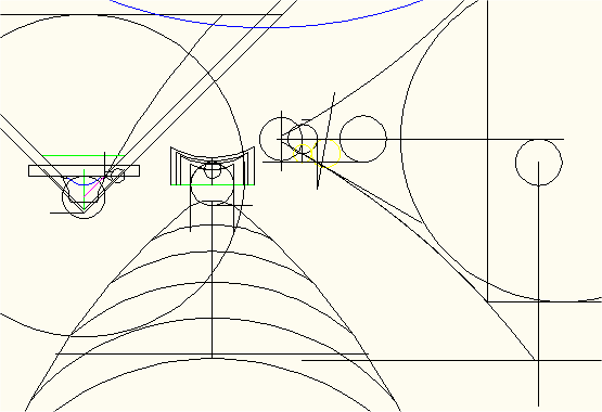

Thanks for asking. It is designed to bridge the directivity of the waveguide to that of the room smoothly. While also suppressing all floor reflections, as well as all ceiling, rear and near side wall reflections. It is a point on my path to complete removal of the baffle step.Very interesting AllenB, any more info?

Older unities could go down to 700Hz, something that can also be done with a single driver, so not much point. I looked at the red spade horn and I could not find much info. It uses a secondary flare which is a space saving diffraction/dispersion tradeoff, first described decades ago. He says the horn cannot dispense with all floor reflections in his room so it is crossed at 350Hz. So the 'pro' of this particular horn is that octave.
