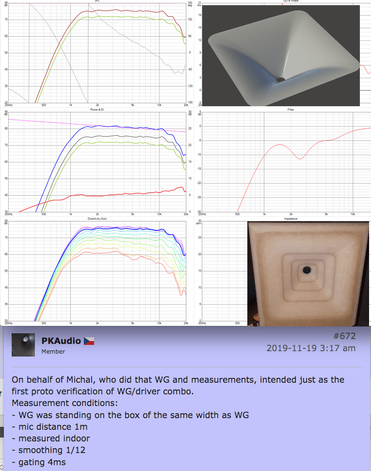

This one is 12" in size, 100° constant directivity coverage:
https://www.diyaudio.com/community/...the-easy-way-ath4.338806/page-34#post-5980566

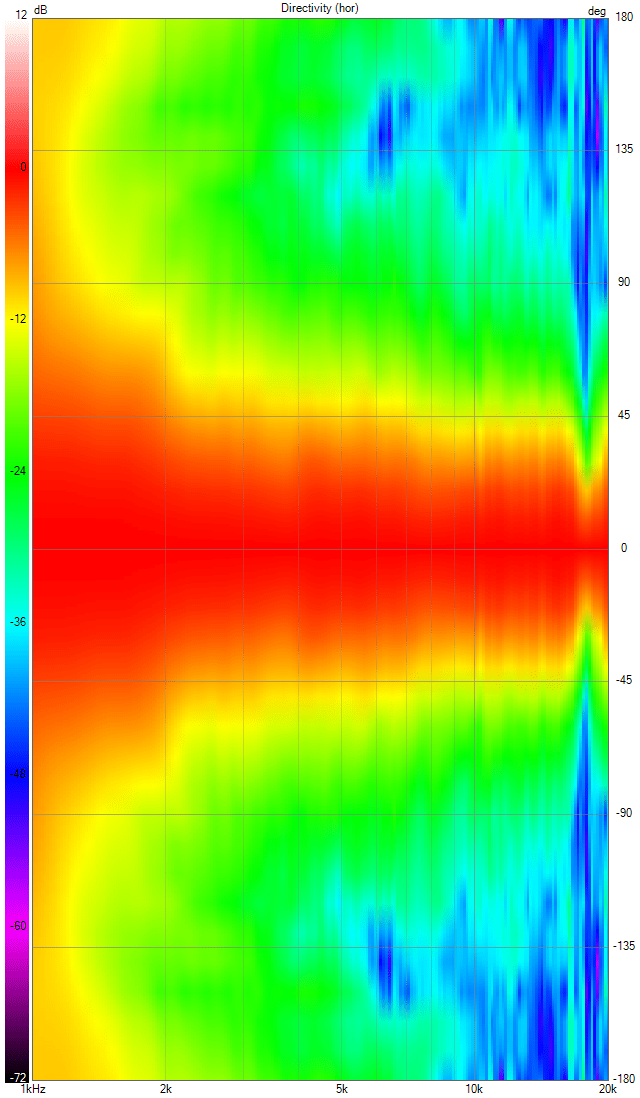

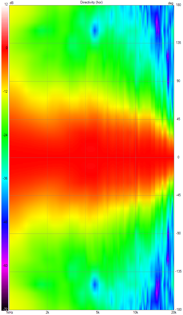

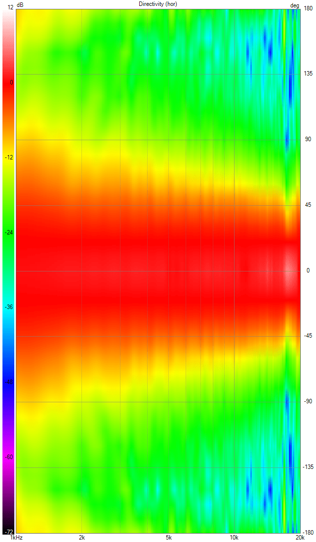

I've attached HF10AK compression driver in three different freestanding waveguides including STH100.
As you see the top octave is on mercy of throat of the driver and has some issues on all of these. To get the top octave better needs experimentation or accurate simulations, or making the throat smaller and hoping it'll be fine. What I mean making throat smaller is that this particular driver has 1" opening to interface a 1" waveguide, but the driver really has 3/4" opening which extends into 1", there about 1" long conical exit section. This would allow a stub to be inserted inside the driver to utilize the actual 3/4" throat size, interface proper waveguide from there on, and get the top bit better.
Besides just the actual top octave these waveguides have quite different overall directivity. The smoother the directivity the more adjustable the top is in general as the speaker would sound pretty much the same (frequency balance wise) from any reasonable listening axis. Now one can EQ the top to liking. If system beams too much it might be difficult to adjust with EQ, as suitable balance is only at some particular listening axis and EQ changes the axis but doesn't widen it. So, basically toe-in becomes very important factor to balance frequency response but now the room interaction cannot be optimized with toe-in anymore. Directivity sets frame what toe-in (listening axis) work, and how much there is leeway to change the toe-in one way or another still maintaining frequency balance. This in turn determines how much you can adjust the room sound with toe-in, in addition.
So, if you can adjust the system with EQ and toe-in then that's fine, you have it nice. If you find there is something wrong no matter how you tune it the problem must be directivity in relation to your application. Directivity can be changed only by swapping the waveguide and this is what you ask for, right? you'd need to figure out what's the problem in order to improve on it.

I failed to communicate, that different driver that has better throat embedded, that makes nicer wavefront before waveguide, might not have the pinch on the top you see on my graphs on STH100 and ST260 , where wavelength is shorter than throat diameter. So, if your system doesn't measure a pinch like mine, your driver is likely fine and directivity of the waveguide is likely too narrow to your liking and you'd might want to try the ST260 for example, see ATH thread. If you have the pinch as well and it is that you are hearing, then you might want to try some other driver with STH100. I know my hearing isn't particularly good that high so haven't seen that pinch a problem and think that the overall directivity is more important in relation.
