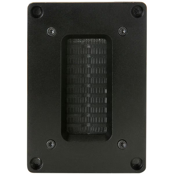

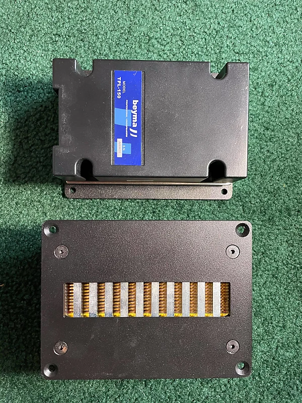

you know yesterday i compared the pictures of Beyma TPL to the non-prosound pleated tweeter from Aurum Cantus and there is no comparison. the Beyma is on a completely another level. check these pictures:
Aurum Cantus:
notice the uneven pleating. notice the thin metal bars ( the magnets are proportionally small to bar thin-ness )
notice the perfectly even pleating and the thick metal bars ( magnets are proportionally large to bar thickness )
you can clearly see the difference in price even without listening.

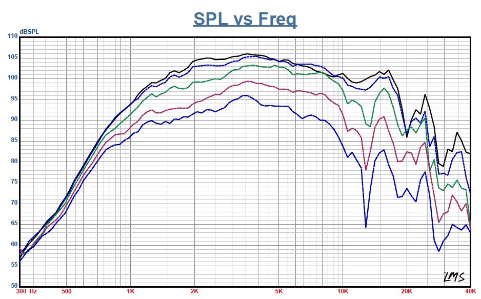

but the Beyma doesn't reach 20 khz ... i just need to find the right True Ribbon supertweeter to use above 8 khz which is about where Beyma TPL200 begins to falter based on tests by Vance Dickason:
https://audioxpress.com/article/tes...a-tpl200-h-pro-sound-air-velocity-transformer
3 khz to 8 khz this TPL200 is just PERFECTION
