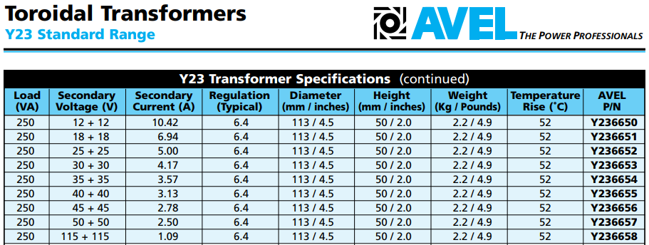

I don't understand that part of your calculation. You appear to be equating RMS current in speaker with RMS current in secondary. They are not the same thing.synonymous said:Calculate current
24/8=3A or 1.5A each secondary
If you mean continuous full level music then you need to double the transformer size. You need to be clear about this: a 250VA transformer cannot supply 250W DC continuously; a Class AB amp (even an ideal one) needs more than 250W DC in to produce 250W AC out.I'm just looking for the most efficient use of a 250va transformer, continuous drive
The 80V CT transformer will allow some 200W into 4 ohms considering normal losses.
Using the 90V one will only increase losses and heat and in practice provide no more power.

Good luck finding an bay seller who understand technical question. I was hoping you can provide hands on experience to see if those PSU was really practical. And I have serious doubt.
Unfortunately I can not. However my experience tells me to treat the 500W as peak, and derate it to 250W DC which is still more than the DC you can get from a 250VA coil.
