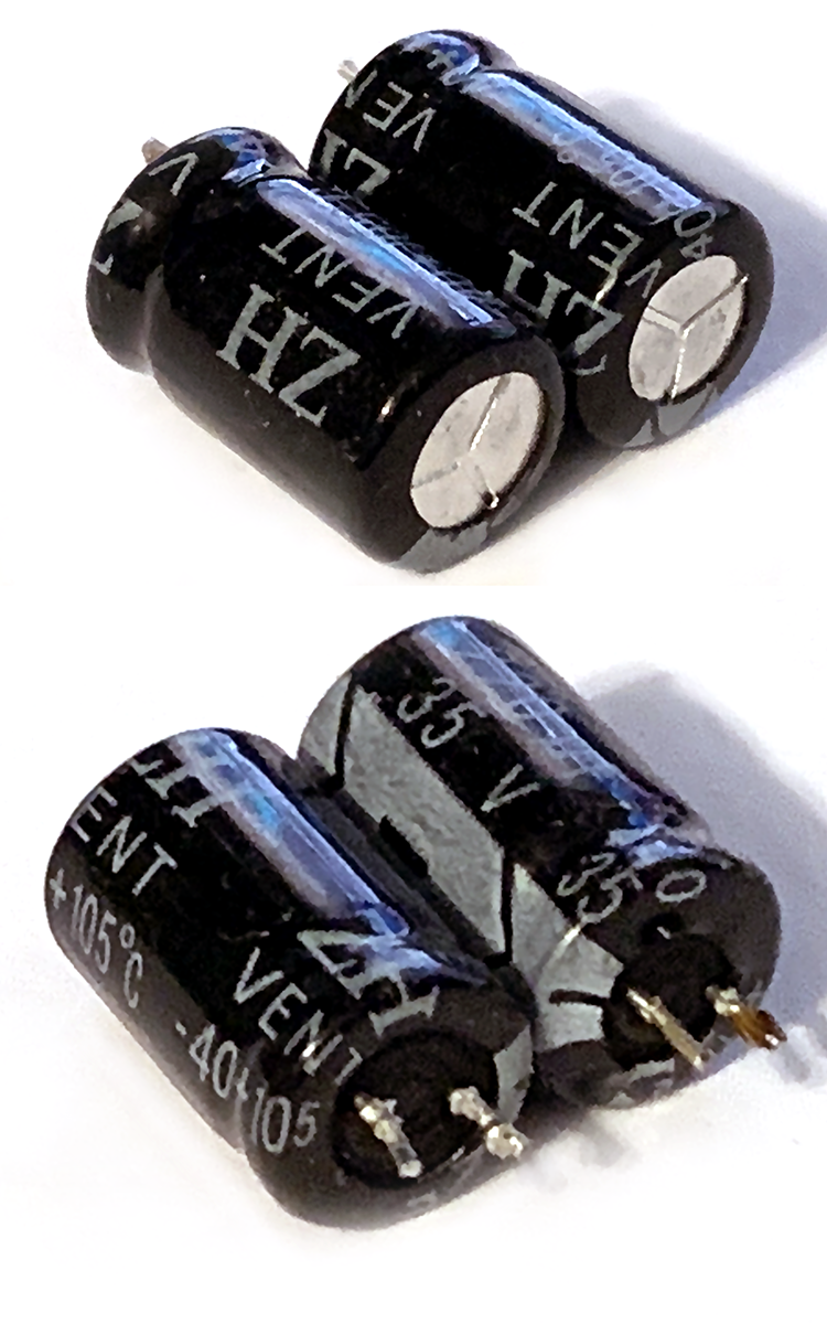

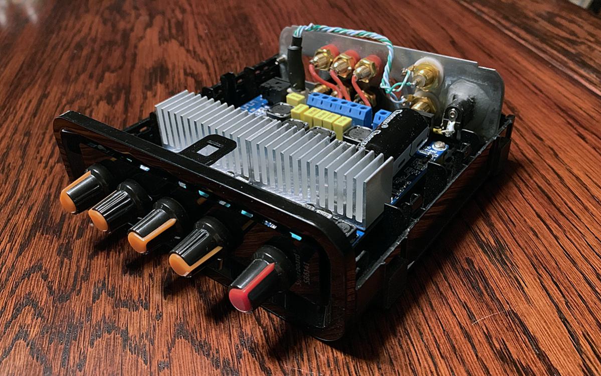

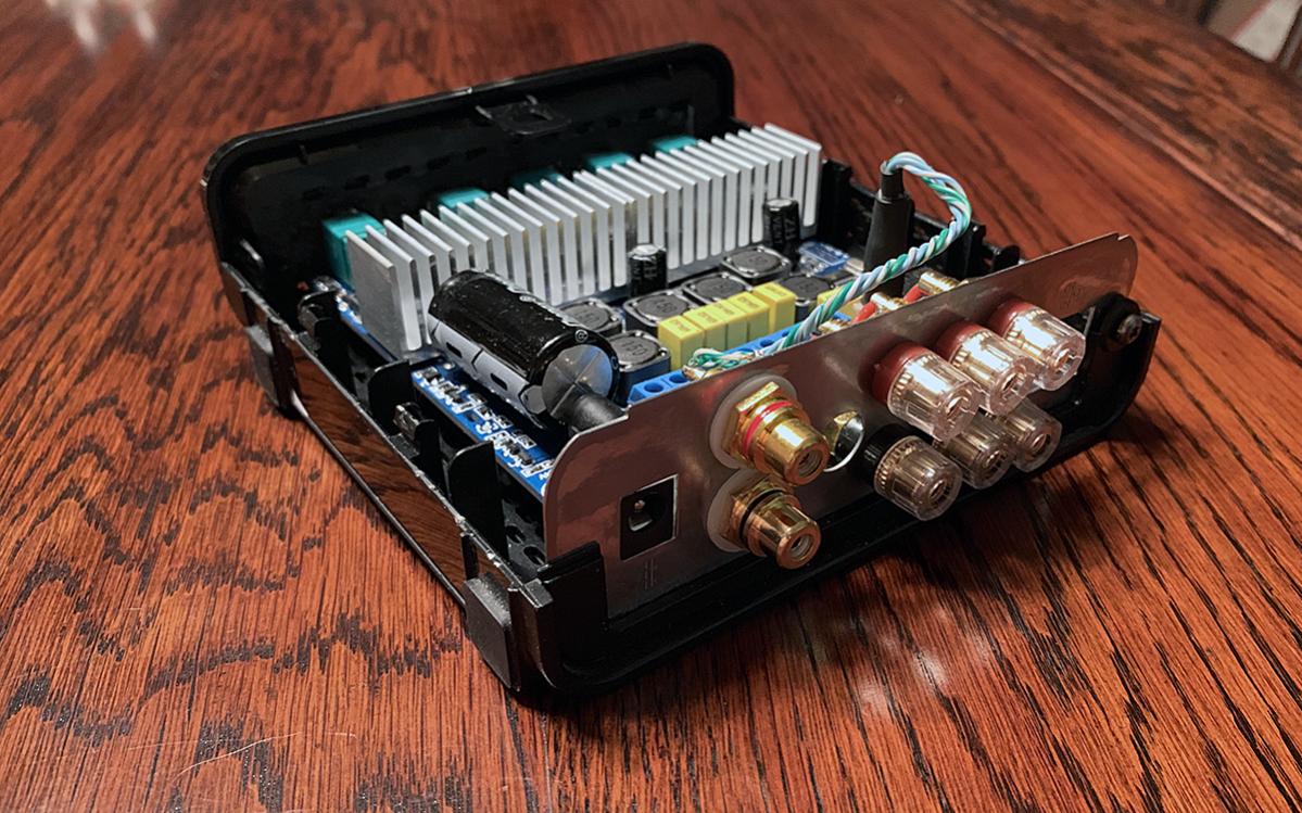

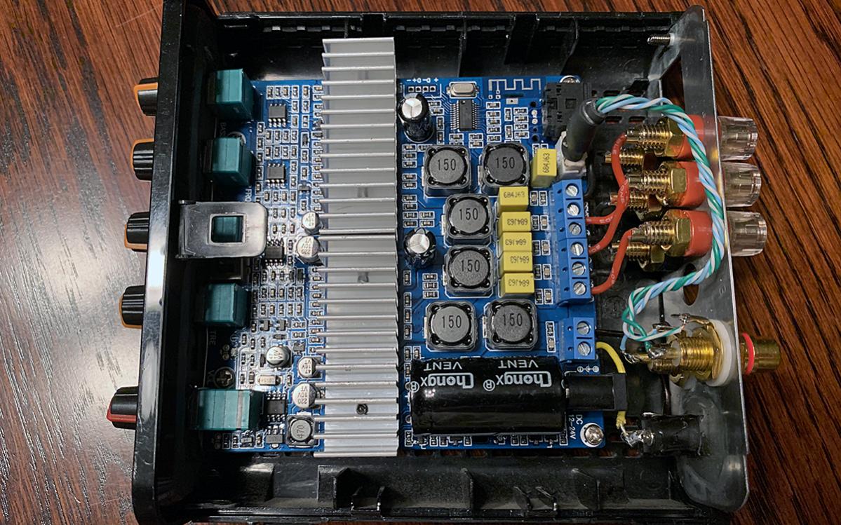

Here is mine, Stuffed into a motorola surfboard cable modem case with added RCA inputs, speaker binding posts, etc. Im using a 19.4v 5.6a laptop power supply brick but plan on upgrading to a proper 24v supply. After taking these pics, i have since upgraded the 2x 220uf 35v caps to Nichicon KA and am waiting on delivery of 2x 3300uf 35v caps which will be replacing the single ChongX 6800uf cap.
It sounds great. No noise. And either today or tomorrow ill be finishing up a pair of Cyorg Needle TQWT speakers using Dayton RS100-4 drivers. They're built from Baltic Birch Plywood and coming along nicely.

Cool little amp, it looks a lot like this AIYIMA amp

If the caps on your board measure where they should, then i wouldn't touch them. On the board i have, the 220uf caps measured around half that, and i bet that POS ChongX cap will be similar. no point in buying some crazy expensive 'audiophile' caps, just some quality low ESR caps with long lifetime from a manufacturer like Nichicon, Rubycon, Panasonic, Elna, EPCOS, etc. IMO, spending large sums on Mundorf, Audio Note, Audyn, Black Gate, etc is a waste of money. They charge so much for their caps because they're filled with highly refined snake oil.
I just realized i read what you had said incorrectly and didn't answer your question about using two caps instead of one. Its based on the comments here: TPA3116 2.1 board input voltage capacitor advice
Here are the caps I replaced. Notice the poor consistency in the wrapper. between that and them not measuring properly, i think i made the right choice.
Yeah ahah ! I agree that it's not worth buying really expansive caps. Nichicon, Vishay and others good caps brand are enough expansive like that and are really good quality caps (for example the UFW, UFG and UKA Nichicon). I'm just sure that the caps on the chinese boards are some very low quality caps that doesn't measure correctly and are worth replacing !
