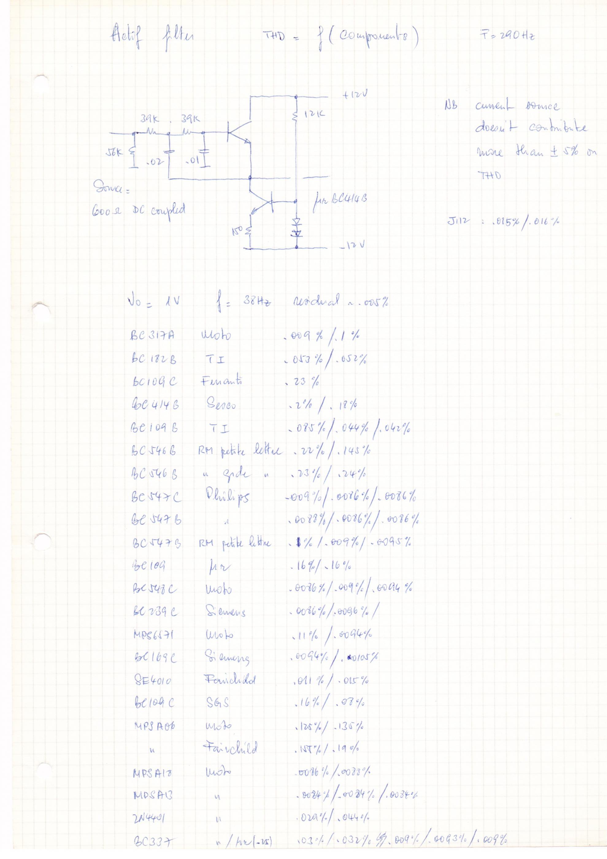

NOT TRUE!!!
40 years ago, I measured the THD of a bunch of small signal transistors in a simple follower configuration, and they're all different: the more exoctic brands like Ferranti (now Zetex) the worst, the established American brands like Motorola in the middle, and the "classic" European brands like Philips the best. The results range from .009% to .2%.
You can see a lot of variation in small signal transistors because different manufacturers will be using different processes and different die layouts to make the ‘same transistor’. They meet the same data sheet specs, but things that affect distortion and perhaps noise can be quite different. The TIPs are generic power transistors with fairly loose specs. You will see differences between brands, but they are not likely to matter in the application. And they will all be using similar cheap and dirty epitaxial base processes, with similar die sizes to meet the Rth spec. You’re always going to get high and variable (with respect to Vce) output capacitance, and a beta that falls off to the low tens at rated current. What happens at low current is anybody’s guess - and if that is important to you get different makes and measure them. But since the spec is so loose, don’t expect miracles in matching from batch to batch.

That research is good if we can find the same devices and manufacturers, etc.
40 years ago and today we've seen much change.
I agree with you, not all part number designations of the same part mean
they are the same.
Mark Johnson (if you can find his post) had very insightful comments about this, when they
bought devices, they would measure the devices and choose the
component that beat the data sheet by the largest margin,
then they would hammer the manufacture down on pricing.
Or course you can do this when your buying millions of devices monthly.
It shure would be a nice list to have, those devices that beat the
data sheet specs by the largest margin.
