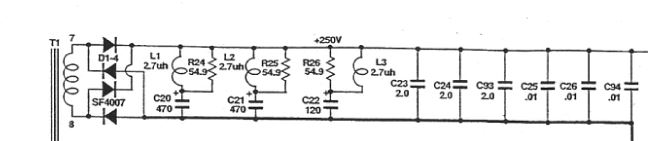

sorry i dont know how to edit my post, here is the diagram of the board i have
seems like those 1000pf caps which i have taken as output caps is not the one pano mention, i guess those caps can be remove😕
output caps from pano previous explaination seems like the 0.47uf beside the inductor
Hi xtorm, I think the caps referred to were the ones across the speaker terminals of the original Sonic Impact Amp..
