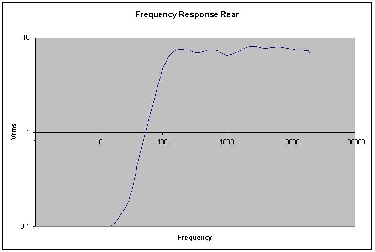

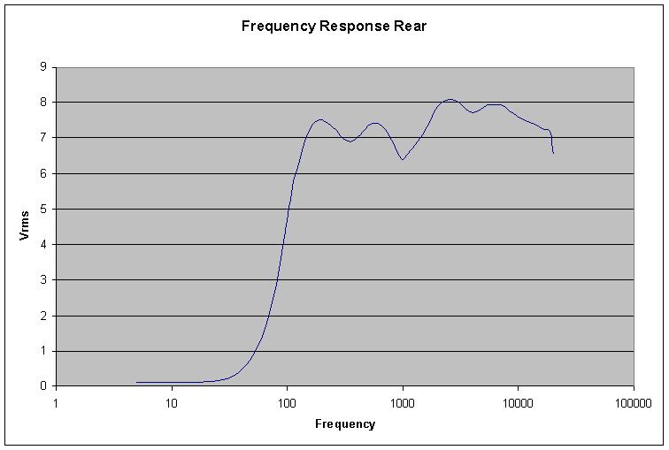

I found an update on the stock radio head unit. For some bizarre reason it looks like they put a high pass filter on the rear speakers. Some owners have complained they can't get any bass back there even with a new amp. Here's the thread with measurements.
Mini Stock radio frequency response

I can't see the graphs, as I can't log in to the site. Can you post the rear in the updated log format?
The filtering could be an equalization of cabin gain, or maybe there isn't sufficient volume behind the rear speakers to get them to go low. Filtering could make more efficient use of the amp and be less likely to damage a speaker. Is it extreme, or just the last couple of octaves?
The response/filter could also be volume-dependent. By 0dB sine wave, was he implying the test was without attenuation, with the volume pegged? The poster didn't mention at what actual voltage he was testing. Was it from the speaker outputs or the preamp? It wouldn't be surprising to see different graphs at different volume settings, and different graphs from line out and speaker outputs.
Did I miss it, or is that a question worth asking?

I just mentioned the response as a side note in conquering this project correctly. I downloaded the graphs. One with 0dB and the other with voltage.[/
It's an interesting point, and a good lesson for anyone who is working with portions of a factory system.
The voltage graph shows over 7 volts for >100Hz. That's speaker level, and certainly near maximum clean output. I assume that the preamp output has a similar response.
The question is why is it so? Are the rear speaker locations really not suited to reproduce low end? If so, that should influence speaker selection when upgrading. And if so, can the locations be treated so as to increase low end response?
Tim
Hi Tim. Everyone in the MINI community is wondering about that one. I guess MINI figures you won't be able to get more than mid-bass out of that location with 6x9 speakers. The CDTs everyone likes claim they only go down to 45Hz and up to 4K CDT CL69
Still if you treat the area some decent bass sound come out shouldn't it? Nothing like a 10-12" in an enclosure but decent bass fill?
It would be nice to figure out how to defeat the HU and use roll your own x-over..
