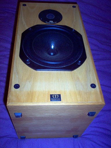

The real idea is really to avoid scratching your furniture. We assume a cabinet is solidly designed. With consideration to mass distribution, I just use rubber feet. Quite how some companies can charge £5 for a bit of rubber that might as well be replaced with halved squash balls or bicycle inner tube, here's what I do.
The idea is the rattles of the cabinet don't combine with the rattles of the furniture it rests on. All a vague science, IMO. 😀

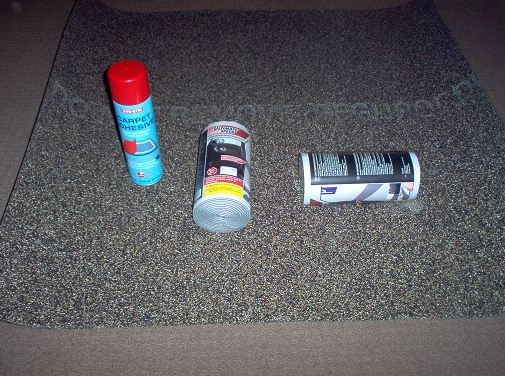

Ground up tyres and cork are the main ingredients of Regupol K225 acoustic floor insulation, which goes under the pretty wooden flooring:
318029d1355689767-buy-bitumen-europe-regupol_acoustic_floor_underlay-jpg
But don't nail it down or simply stops working.
I stick it to the inside of cabinets, but it will doubtless work just as well on the outside:
318030d1355689767-buy-bitumen-europe-underlay_artistic_shot-jpg
Thinking about all this, you might as well rest your speakers on a big bit of packing foam or spongey stuff you often find in packaging. The speakers must almost float on air. It's not rocket science, is it! 😎

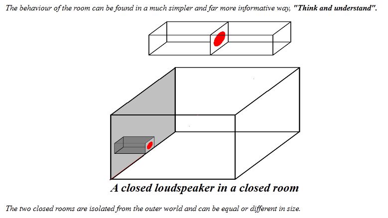

Nobody ever gets this, but Steen Duelund suggested that anything you do to a speaker cabinet might as well apply to the listening room too. So you have the same issues in your room as a cabinet. To give an example, if "Golden Ratio" and panel damping is good for a cabinet, might it not be good for the room too? Well, a friend of mine has lined his brick-built home cinema with 3" of rockwool. The speakers are built into the walls, the carpet is deep wool. It sounds good. 😎
