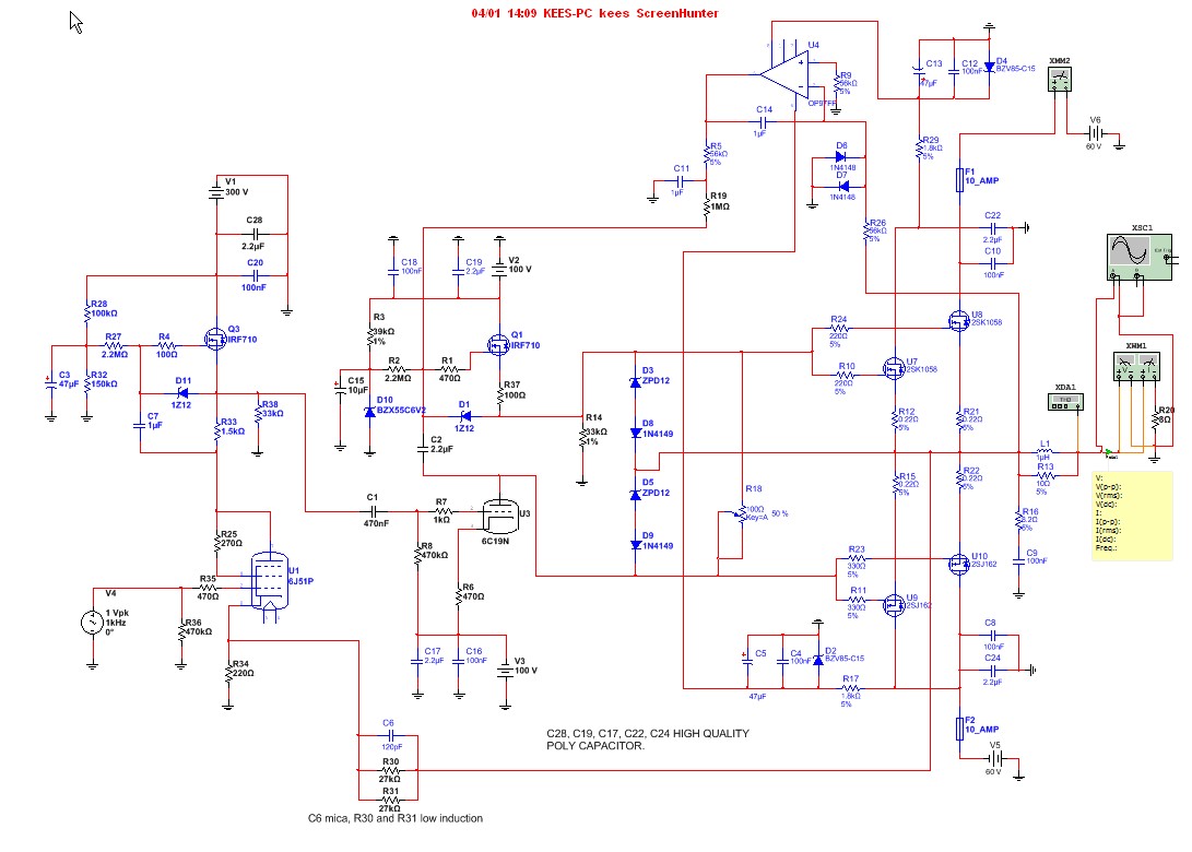

so I meantime have rebuilt my Jadis30 monoblocks (already sent post somewhere at this forum), some docu is here (at czech..): perys | perys - Jadis-JA-30_mk2012 ? rajce.net

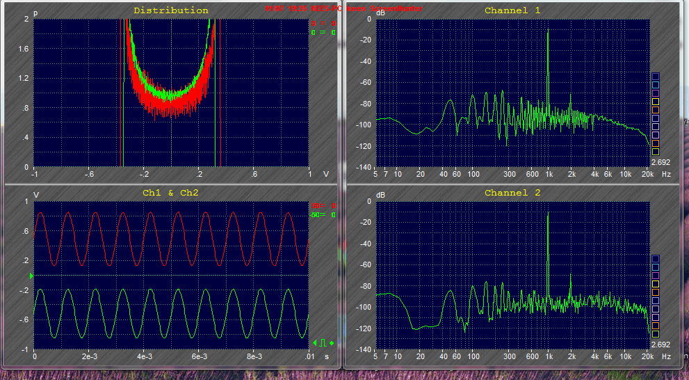

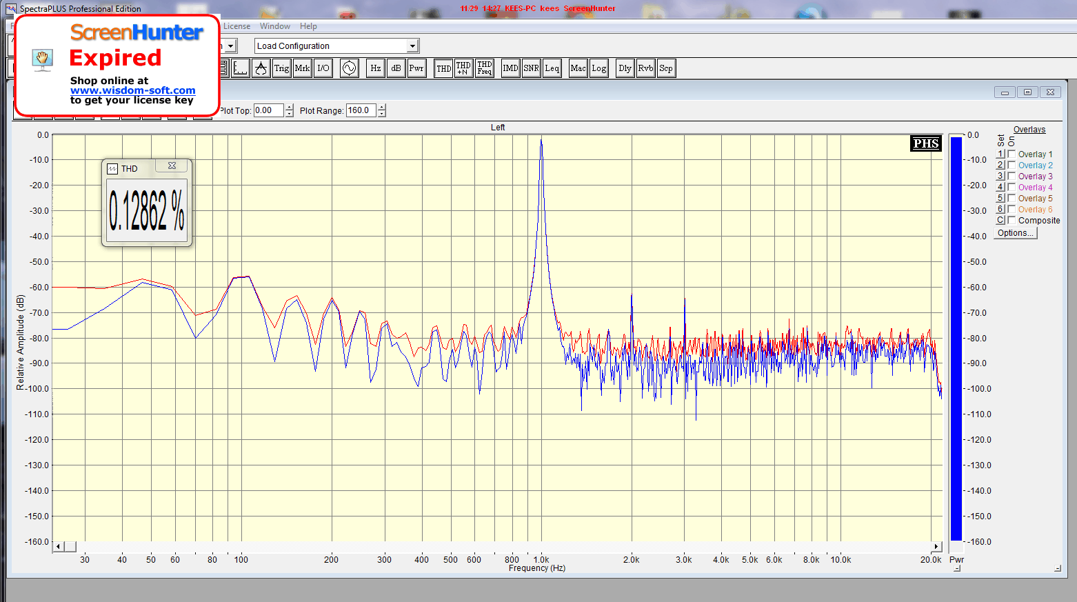

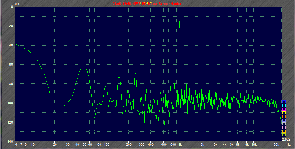

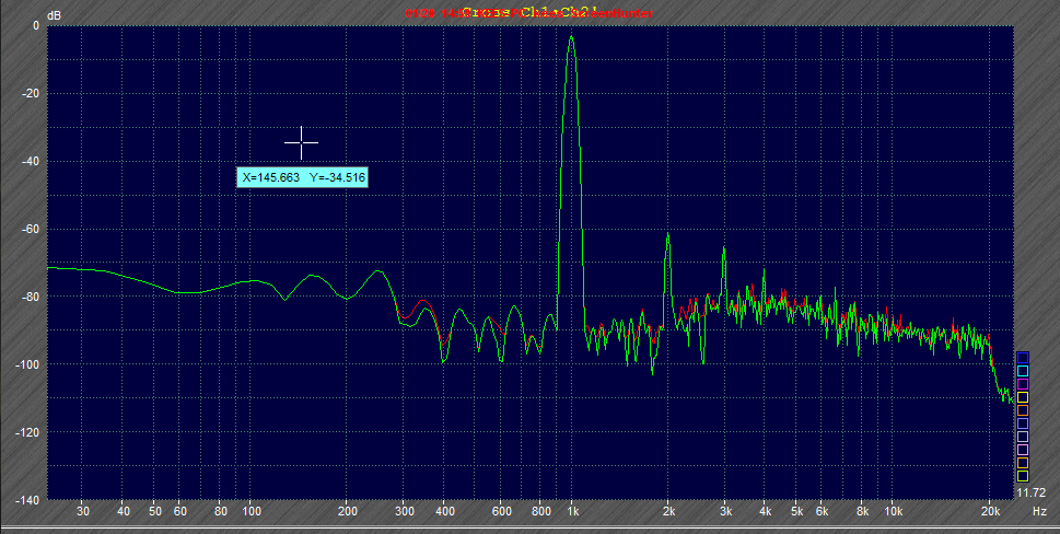

(in few words: original schematics with boring sound, new schematics with no global feedback and very weak local one, with much much better sound🙂, some picturs of work, then some squares (at 6550 anode [now going to >300kHz with JJ tubes] and behind output transformer; some spectra as well).
The sound is simply as good as it should be.
I have since never retuned back to solid state... and I think my predecessor amp was quite good, accurate and really fast (going up to approx. 1-2MHz): perys | perys - hqqf_2012 ? rajce.net

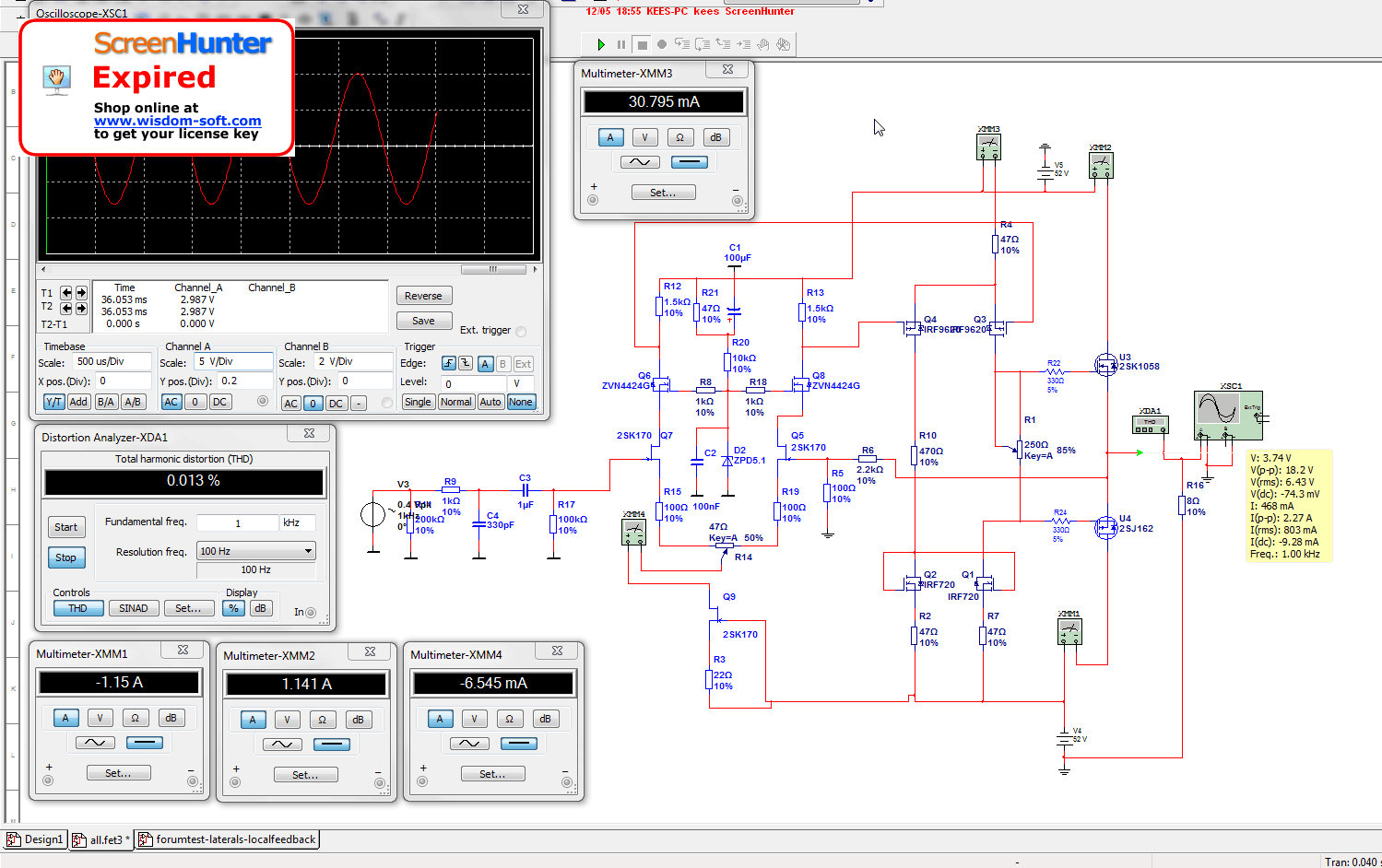

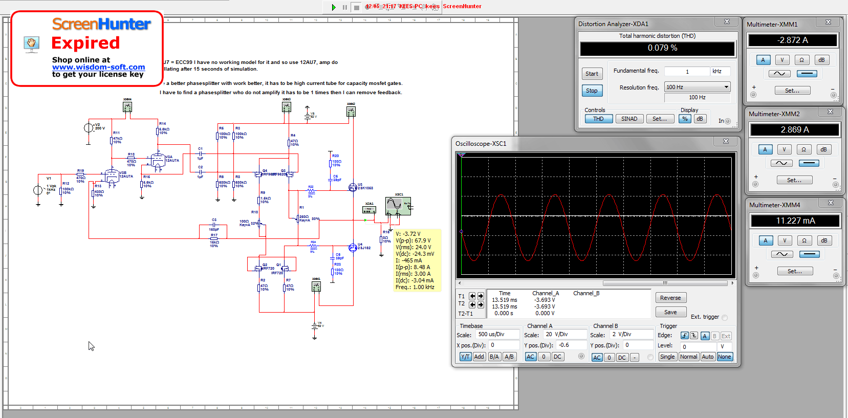

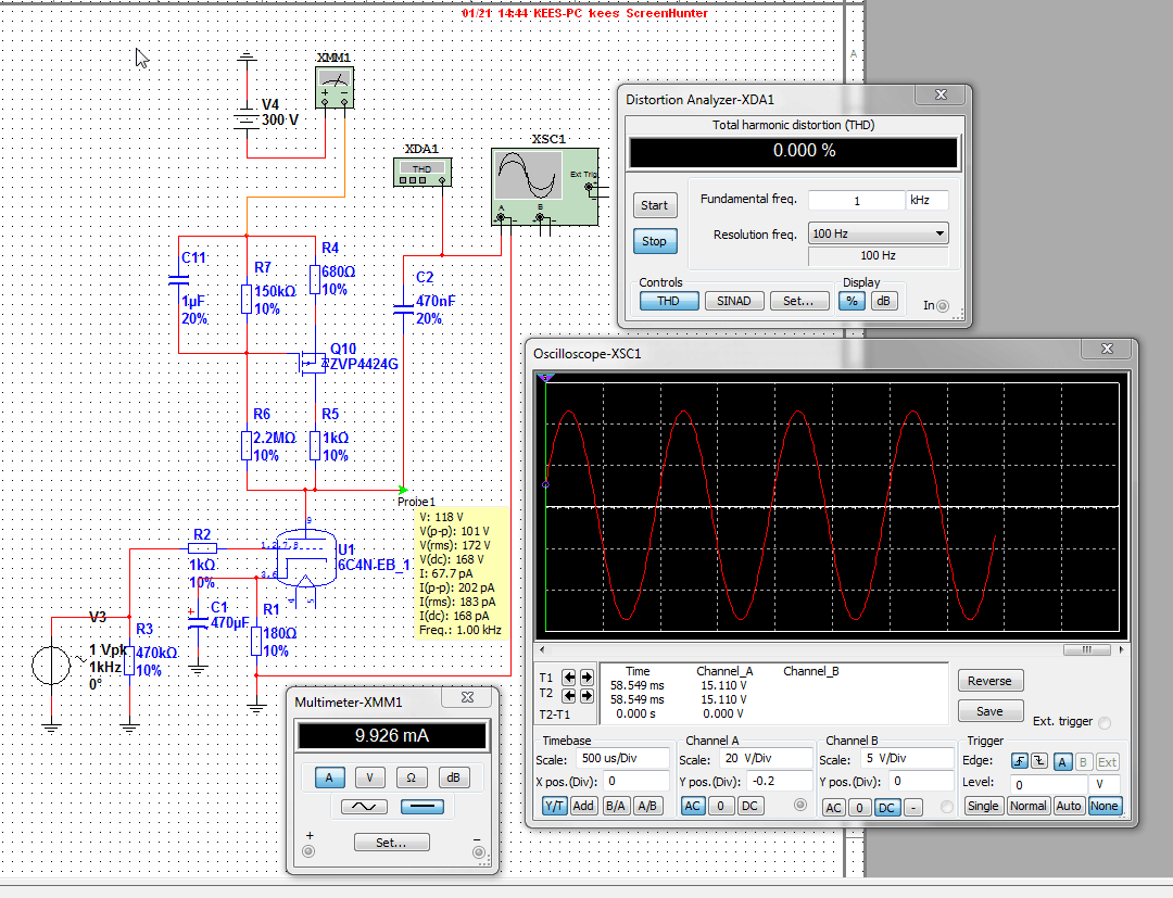

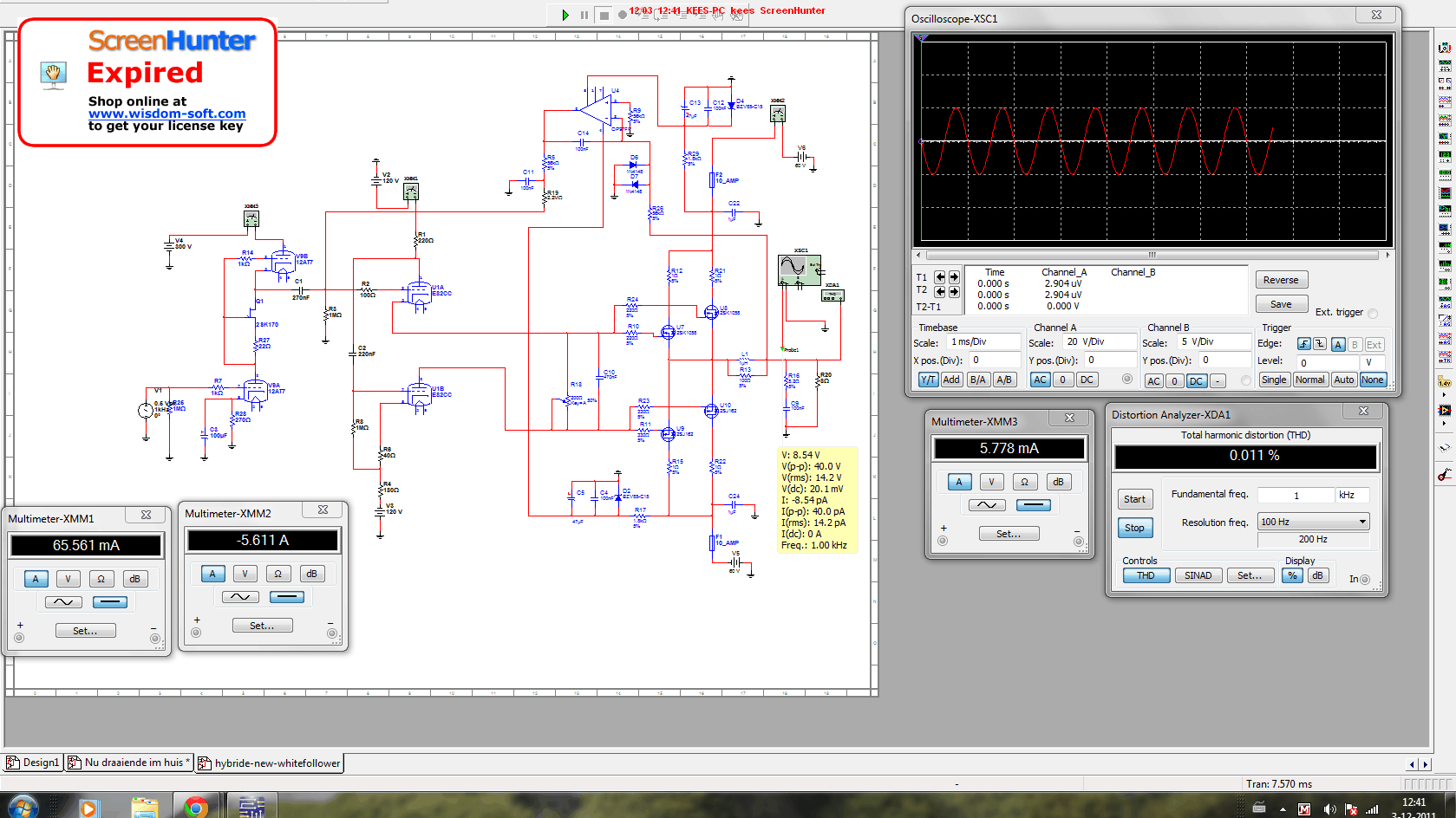

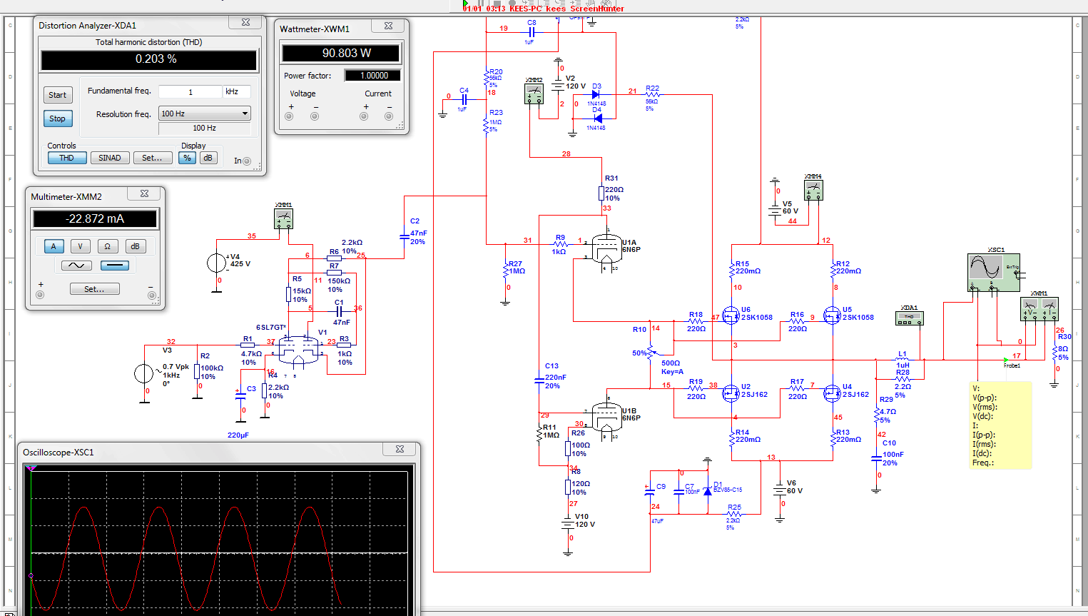

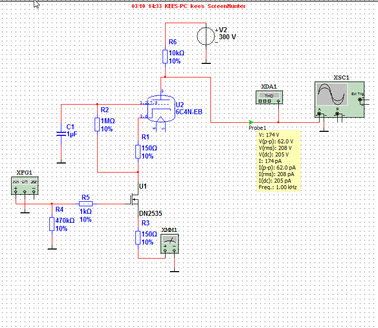

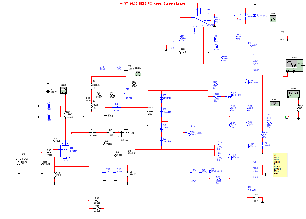

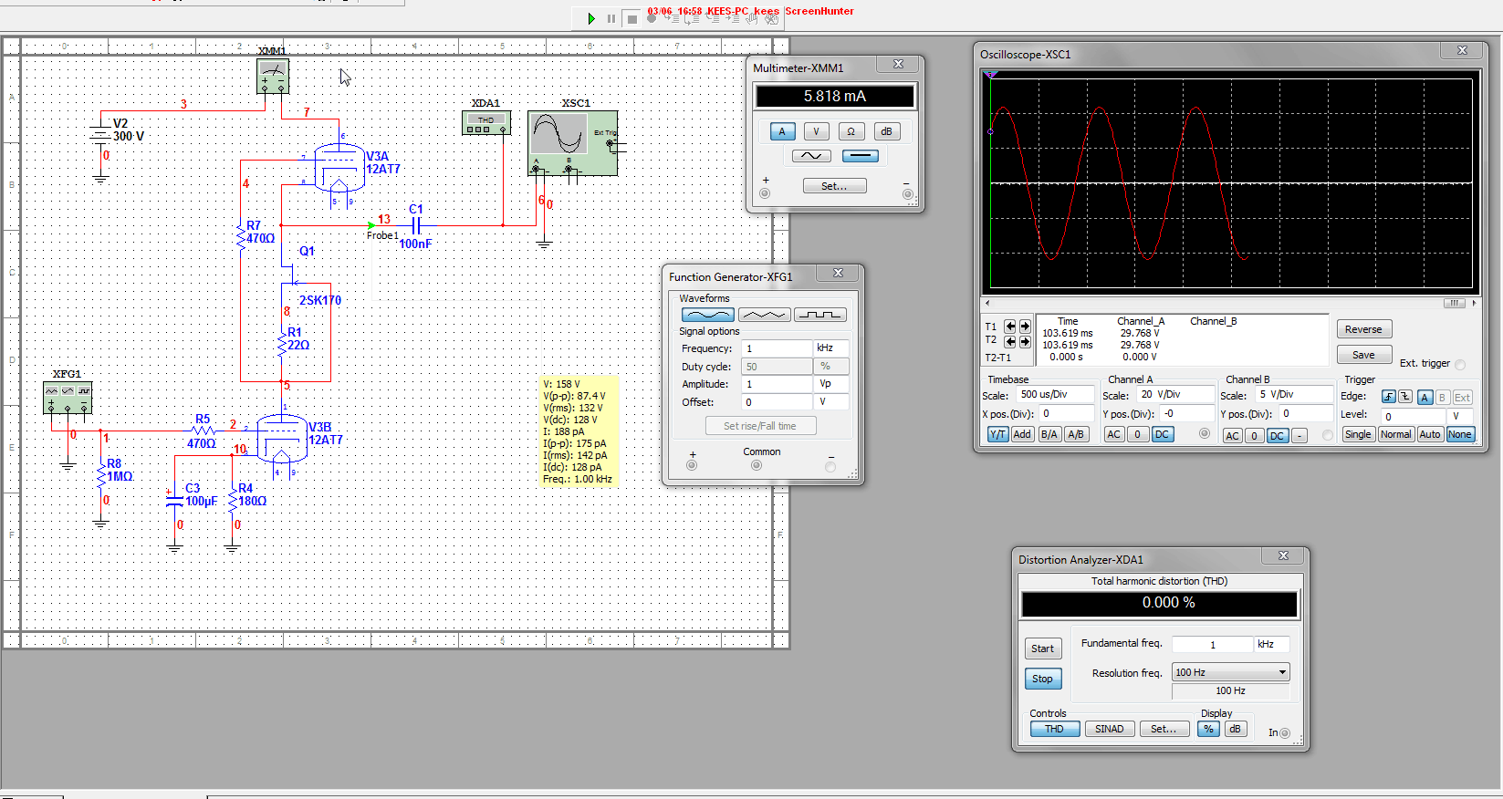

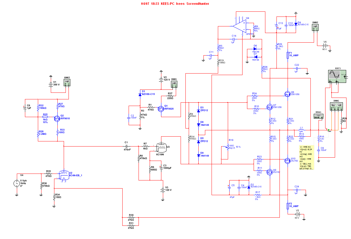

Yes feedback can kill dynamics, therefore I use only current feedback, the schematic hybride in previous post have also the possibility fo no feedback then use only a mu is 20 tube in voltage amp, the driver has mu is 2.4 when using a higher mu yiu need feedback but then also slightly.
this one do sound very dynamic.
