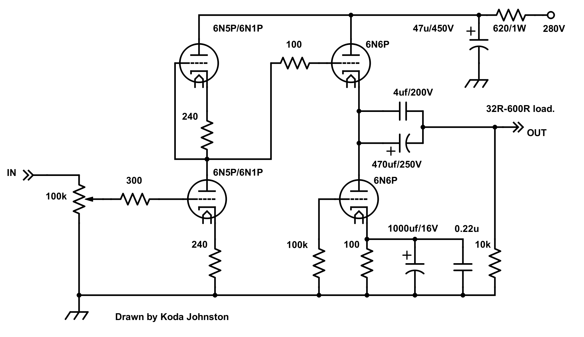

3D6, directly-heated loctal pentode.
Triode-connected, it can be used for about 200 mW in SE.
180 V, 20 mA, 8 K load. Rivals 71A sound.
1P24B rod pentode not bad either.
1 K screen-to-plate resistor, 150 v, 25 mA, 8 K load. Can get whopping 700 mW SET power. But 3D6 is a bit more refined to my taste.

Shew us the circuit for that one. THX🙂
