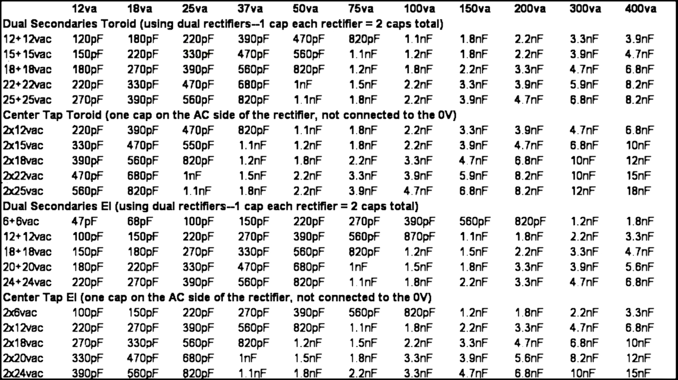

A large ceramic disc hanging across the input to that rectumfryer? A *snubber* perhaps?

just a small value 0.001ufd 2kv disk ceramic....

One of those .00x uF 2 to 6 kV ceramic discs with ten or 20 ohms in series with it will usually quiet 1N5408’s used on Antek toroids or anything custom I might whip up on an EI core. Sometimes I try to get by without it, not always successful. But cheap and easy enough to do if you get a buzzing supply.
