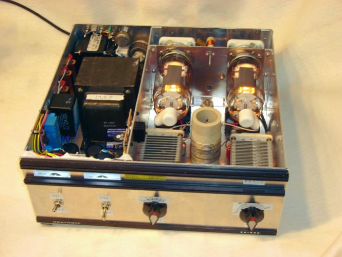

Personally, if there were a difference, it would probably be too small for me to even notice or care much about. I built a cathode driven RF amplifier with two 813's (w/metal plates, which I had on hand) and it easily produces 500 watts output with about 2KV on the plates. If I needed to replace the tubes, which I probably never will, I'd get whichever version I could find cheaper. Maybe I'm easy to please... or just cheap.
