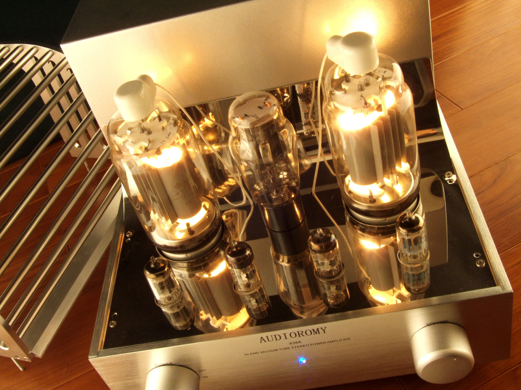

The best known commercial amp was made by Altec.

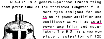

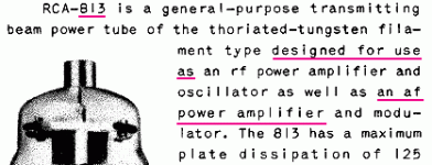

The 813 was a splendid VHF transmitting valve used in class C. It was not designed for audio use.
Most conventional transmitting valves were intended for audio use too, perhaps as modulators or for high power PA. It may be true to say that they were not intended for hi-fi use. In some cases the datasheet gave figures for SE Class C RF and PP Class AB1 (or AB2) audio application. Someone wishing to use them for Class AB RF (as a linear PA) would have to work from the audio data.
With some study of the ratings, and careful amp design, you should be able to use the 813 in Beam Power mode, Ultra Linear mode, or Triode mode. But it probably would be best in pentode mode.

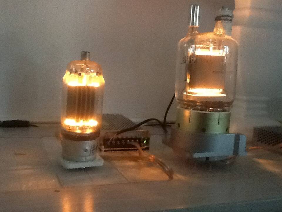

Just don't ask where the off-the-shelf in-stock output transformers are. The tube will get hot, even before you apply B+. The filament is 10V at 5A = 50 Watts!
