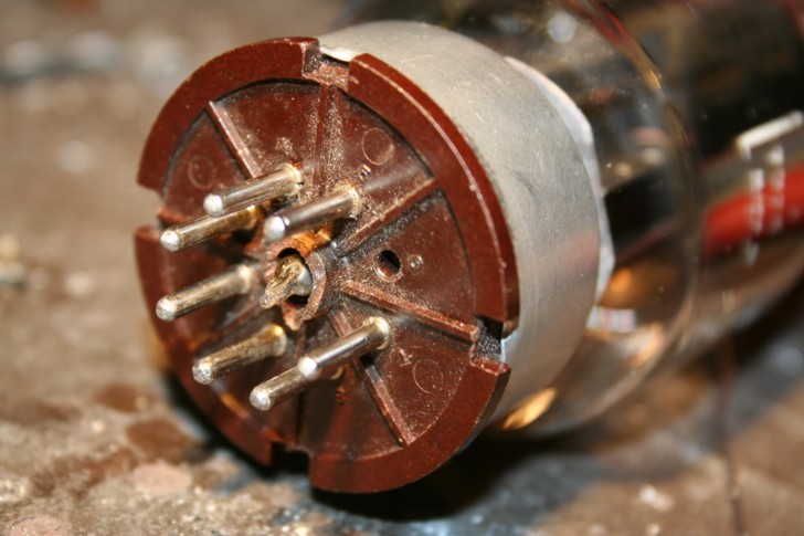

KT88's can easily come out of IO holders and break the spigot as in pic.
That happened to my TT21, otherwise I would sell them. They fetch serious money (at least twice as much as a KT88)

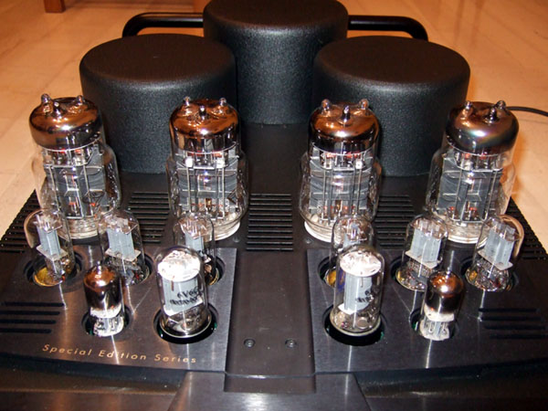

I have this top of the line BAT VK150SE thing for bias tracking inspection in my system lately. It uses 6C33s. Those tubes are very different to each other in production regarding emission matching, and they need to be hand matched. They tend to drift a lot, and auto tracking systems are usual among ready made amps using this type. Their sound lacks bass sustain IMHO. I have listened to them in many different expensive machines, OTL or not, and always I feel this 'cold' signature. But I reserve judgment since I haven't developed a project of my own with 6C33s so to know what else is at play in circuits around them for sure.
Thanks Salas, very instructive!
A little bit surprisingly for me is your opinion about lacks bass sustain.
In spite of powerful triode nature?
BTW, have some pieces on my "private stock" to make me next winter warmer... Searching for suitable topology...
