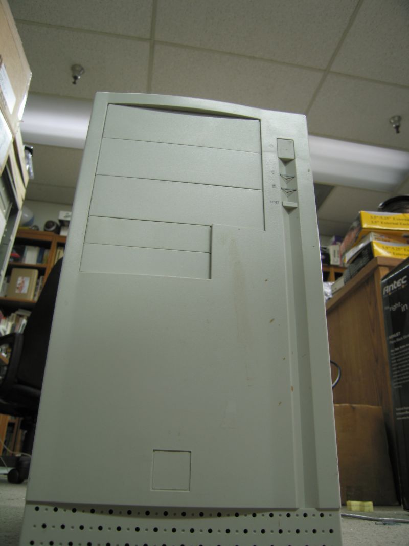

Anyway, I really like what you did for a case 🙂 Seems big enough to house everything easily, and you put the money into what really matters, well done.

The case has actually worked out great for putting the amp together: easy to modify, adequate space, no apparent performance compromise, and easy access for getting to and working on all of the parts. For a final version of the amp, I'd like something that looks nicer, but for experimentation, and for anyone who doesn't care too much about the looks, I'd highly recommend it. Besides, it's funny to have what looks like a couple of computers on the floor functioning as amplifiers.
