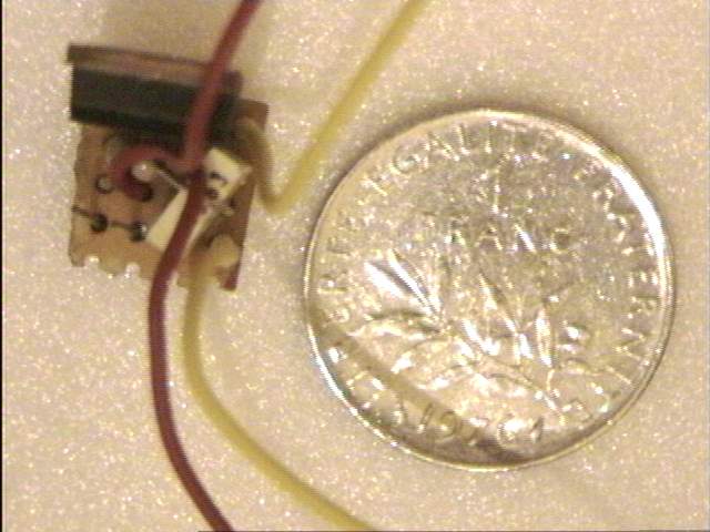

Designing a small PCB, with your zenner/EF reg, as 3 terminal reg (pin to pin compatible with a 78xx) can be done. Making this as small as a keyboard key seems possible.
Please, tell us more abou those low noise shunts!

It's not a reg, but it costed me less than $2
But it may take you too much time to do this, if you have dozons of regs to change

Konnichiwa,
I have done things just like that, in my case a TO220P BJT turned "upsidedown" and a little stripboard with SMD Cap's and resistors to make the Zenner (TL431) and RC filter to the base of the BJT.
However, this in not really an option to make and send to factory to fit.
Well, for the first batch of gear I would have to build a few 100 of the ******s, thanX but no thanX...

No, Peter was talking about using the LM29xx for the TDA1543 and Tent clock. The former is perhaps 15 bit and the latter needs a lo-noise supply.
I never used LM29xx reg with TDA1543 or clock supply. To me AN800x sound the best in those applications. For comparison I tried 78xx of certain brand (that had the printing scraped off) and the AN800x was much better, IMO. I didn't compare it directly to TL431 + transistor, but from my previous experience with those regulators, it doesn't seem like AN800x sounds any worse than those, and it's so easy to implement and takes minimum space.
I don't know what it was as the print was gone😉
But I presume it was from National as the casing matched (there are small details on plastic case that are propriatory to each manufacturer)
