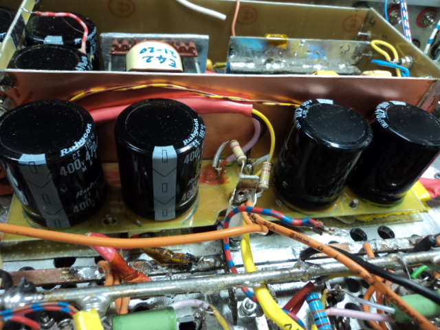

Picture of the practical application in one of my current projects:
http://www.diyaudio.com/forums/tube...aus-work-pp1c-without-sand-2.html#post2546319
The green ones are the parallel resistors, 150k 2W if I remember correctly, need to look it up in my paper stuff...
Stuff like capacitor matching
Unnecessary. Thats what the resistors are there for.
, minimum current through the voltage divider and the story of probing the circuit voltages on the bench.
Minimum divider current is a more complicated question, depending on the cap's DC leakage. I did not bother about that in the example above, for the following reasons: The resistors in my circuit are also used as bleeder resistors, draining the filter caps empty when switching the amp of - avoids nasty experiences when working inside the amp. Besides that, I calculated them quite low as to ensure a minimum load current on the PS and keeping the idle voltage from rising unacceptably high.
Both demands, bleeder function and some 'basic' load for the PS, lead to a quite high voltage divider current in the mA range - much higher than DC leakage of any practically available electrolytic cap.

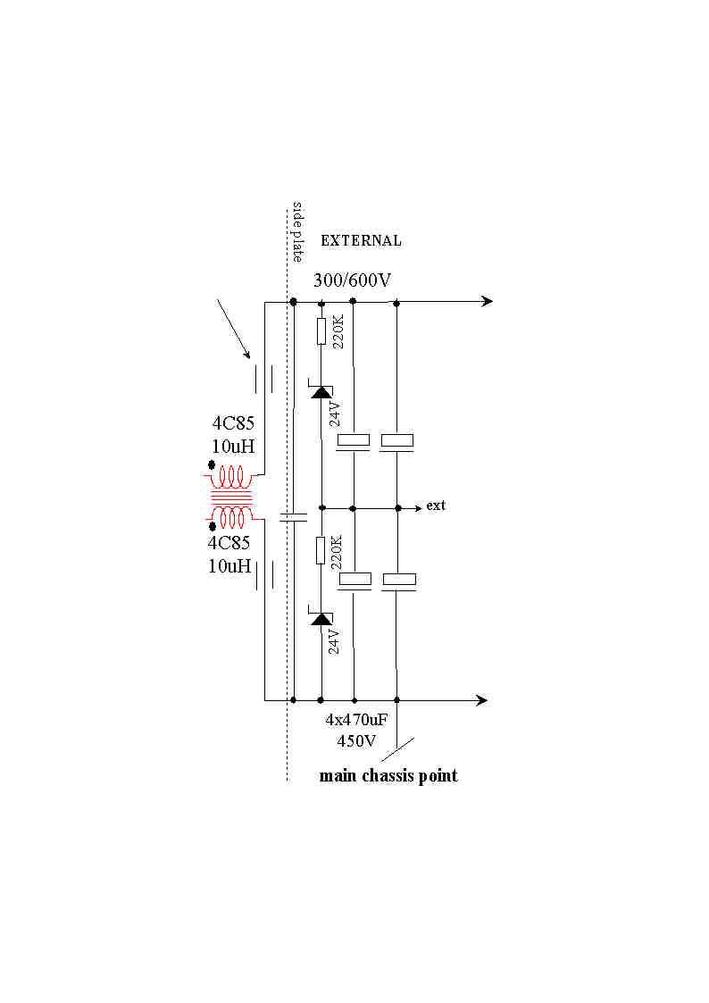

DT: okay this is the sch I generally use. Ignore the choke and other bits.
The two zener diodes in each half leg with divider resistors are there to avoid a complete cap discharge and keep cap etch polarised longer. Considering power electroytic caps are widespread, their cost keeps accelerating and any method of improving life and low operating temp is recommended.
