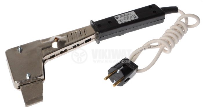

The key word here is ''CABLES'', unknown cables kind.. Why am I suddenly flooded with very old memories and even practices from my childhood? The base level - the battle-tested soldering tomahawk/250W/, NATURAL ROSIN and ASPIRIN/ASA/:

It was so long ago - many, many moons ago/40-50/🙂. Cables didn't stand a chance. 100 percent success rate. But thanks anyway🙂.Good luck soldering 0402s with that. 🙂
