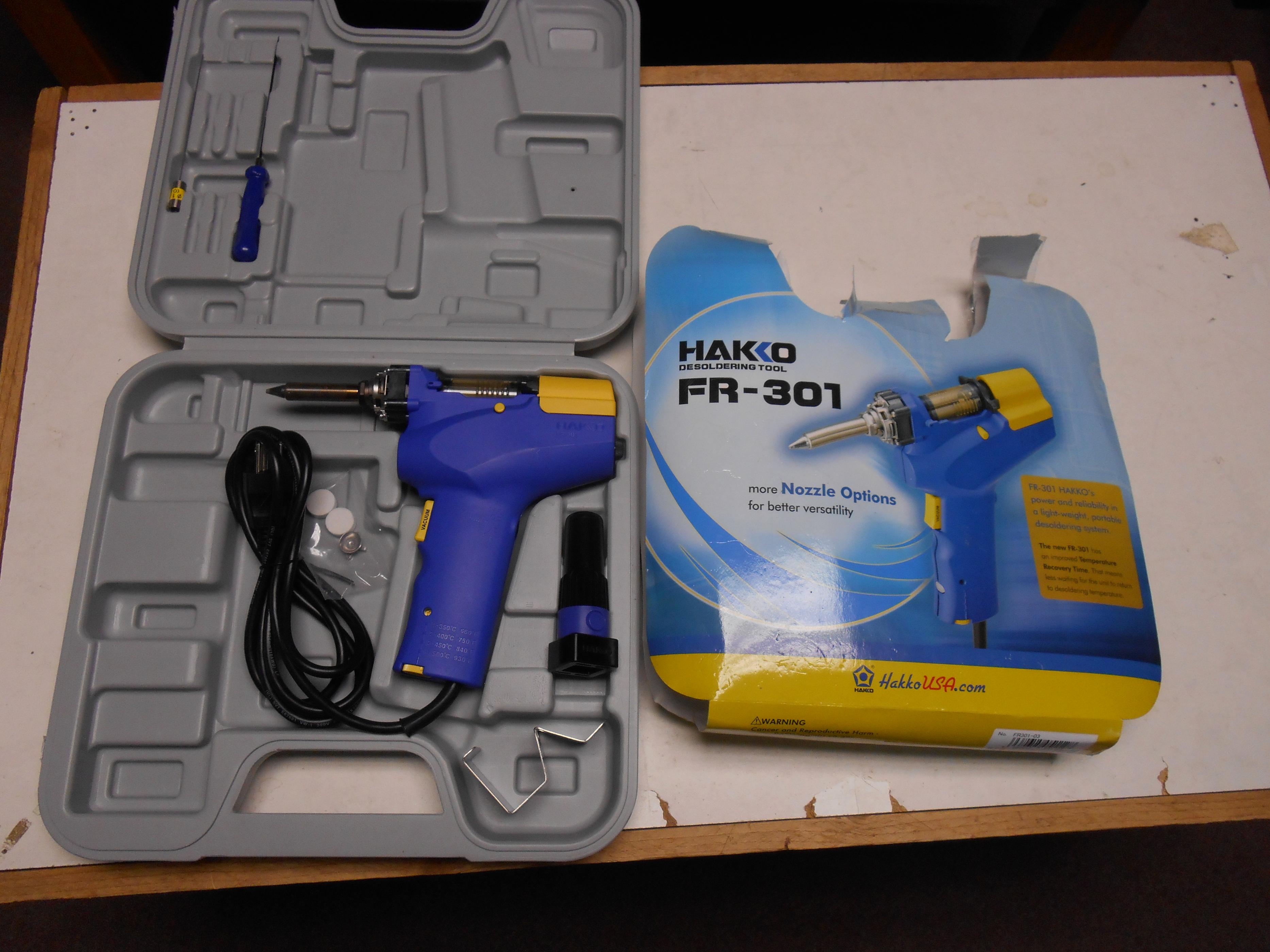

Hi Guys; Thanks again for all the info. I have this on loan from a from a friend and will let you know how it works for me!
