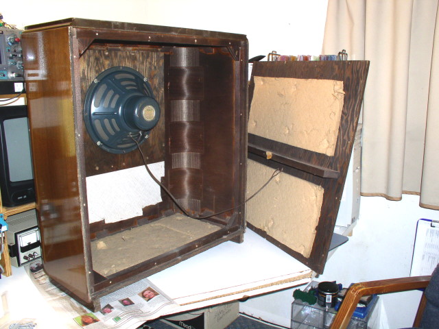

I love my vintage Jensens. They have full range 12" drivers. (Jensen calls them extended range.) My hearing only goes up to 12K. I've A/B'd them with multi-driver speakers. If the Jensens are missing any treble, I can't hear it. :D Lots of bass and efficiency. I think younger ears would at least appreciate the low bass and smooth midrange.

An extended range 12" is one option I've considered. Do you think your cabinet would benefit from a bass-tuned port? Or does it have one I don't see?

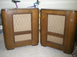

I'm a dummy when it comes to speaker design. I don't know the difference between ported and bass reflex, are they similar? Jensen called this cabinet their type "D" bass reflex. It's 31"x28"x13". There is a substantial rectangular opening just below the driver, otherwise the enclosure is sealed. You could easily blow out candles in front of that rectangle!

Very cool looking. Keep them. The bottom opening looked sealed up on the pics is why I asked. Others here can explain how this cab works better than I.
